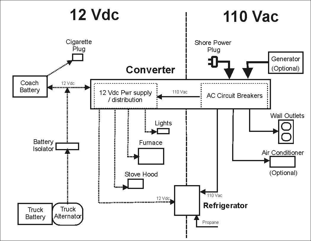

The isolators job is to isolate the coach and truck batteries and electrical systems. this will prevent the coach from discharging the truck battery while your camping.
post-4544-0-45475000-1369136344_thumb.jpLook at the diagram, its generic, but should be close to what you have.
Normally, the isolator ties the two batteries together when the truck is running, That way, the trucks alternator can charge the truck battery AND the coach battery.. Then when the truck isn't running, the batteries are isolated from each other so if you run the coach battery dead, you don't kill the truck battery.
When you plug into shore power, your converter also acts as a battery charger, it will charge the battery, and also supply the 12 volt power.
The old original converters do a poor job of charging the battery, Depending on how they are adjusted, they either undercharge the battery, or overcharge and cook the battery. The newer style "multi stage" converter power supplies automatically adjust to battery conditions and do a great job of charging the battery without cooking it.
i.e. If you have the old style converter, its OK for a few days, If your plugged into shore power all the time, I would recommend disconnecting the coach battery so as not to cook the battery.
