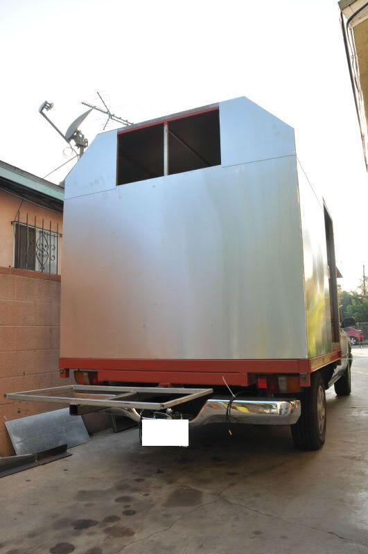

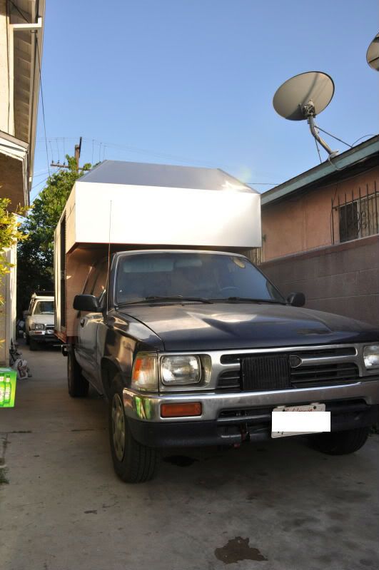

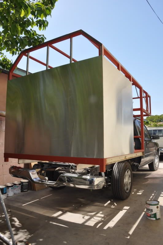

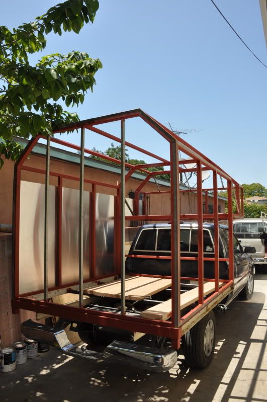

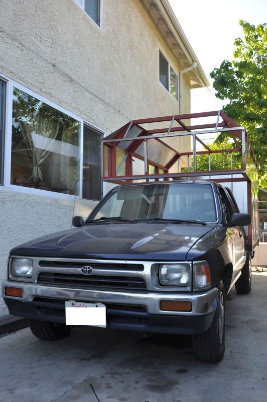

Boy Posted May 29, 2012 Posted May 29, 2012 Not sure where to post this but sorry if its in the wrong section. Well the start of the story is that i been looking into buying a rv recently but my family has 2 toy pickups. One is as a backup which is the one used for this project A little background on the design. I wanted to convert to a dually but cant locate the parts needed. I use some metal scrap and mostly new square tubing for the upright frame. The truck will need to be use for work when not on vacation traveling so i am building it off a flatbed/steak bed design. Also i designed it to be able to mount on a newer tacoma double cab w/ long bed for future vehicle choice. The upright structure slips into 2" receiver tubing and will be bolted down. Here are some pics for now and more to come as I make more progress What I have for the rv: Honda eu2000i Eccotemp l5 water heater shurflo water pump thetford porta pottie airlift airbag suspension add tranny cooler and new radiator all maintenance are taken care of new fuel pump since the truck bed is off Construction steel tubing as i do not have a tig welder capable of welding aluminum aluminum sheeting for exterior walls secured by VHB tape 2x8 for the floor deck Styrofoam 1.5" sheeting for insulation no windows to keep cost/weight down homemade shower pan I am planning to do a ~4k miles trip in less then a month form Los Angeles, Yellowstone, Mount Rushmore and lots of in between for 2 weeks. My biggest question is there anything you toy owners think i should add or can't live without? Quote

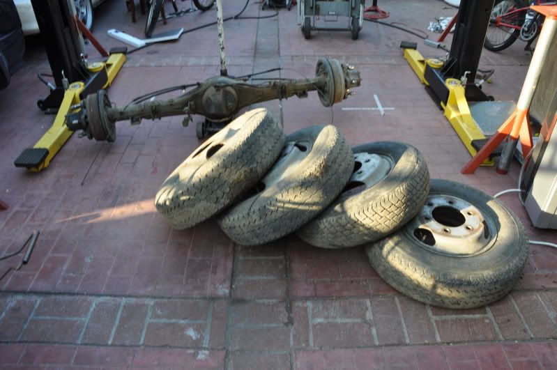

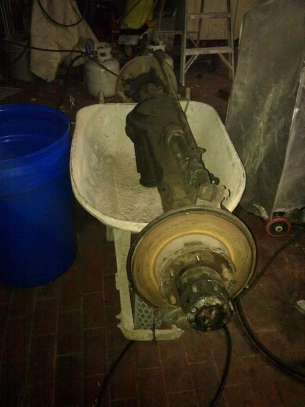

Boy Posted June 10, 2012 Author Posted June 10, 2012 My luckiest find yesterday! A dually rear end. it just too bad that the motorhome is not as wide as the dually setup. the wheels will stick out 3" on each side. My uncle and I went to pull it off 1 hour ago. It has 130k miles off a utility bed truck. Just need new tires. Also here is a update on my status w/ the rv making. I am sick so i stop working on it for a couple of days now. don't mind the interior since i used the truck to haul the rear end home. I'm just glade i didn't paint the 2x8 wood yet Quote

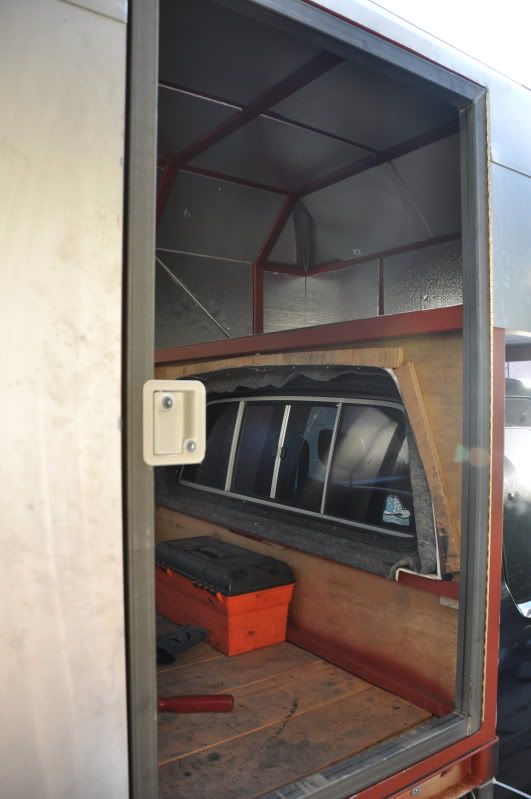

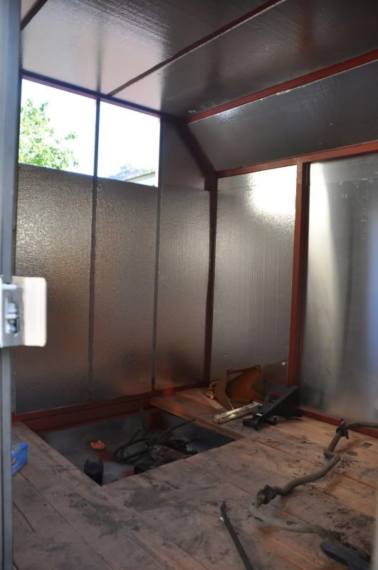

Boy Posted July 6, 2012 Author Posted July 6, 2012 Do anyone know where i would be able to obtain the speed sensor to correct my MPH speedo? I converted the truck and it is off roughly about 10 miles so 50 mph reading = 40 mph. Also i would like to extend my pickup wheelbase. I know there were motor-homes that were extended. Anyone know where i can source some pictures? Didn't have time to update my process before i made my trip. It is still not complete yet. I want to make the basement compartment to store stuff and i need to finish off the cabinets inside before my next trip. Started in Los Angeles Las Vegas Zion National Park Bryce National Park Capitol Reef National Park Salt Lake City Grand Teton National Park Yellow Stone National Park Rapid City Mt. Rushmore Crazy Horse Badlands National Park Denver Arches National Park Las Vegas Again Back Home Drove about 4k miles below are some pictures of my rig at a couple of campsite. Quote

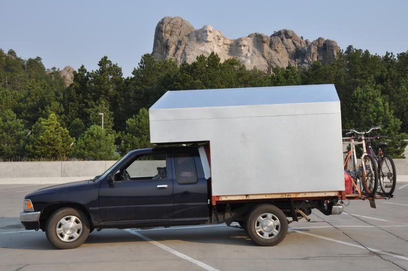

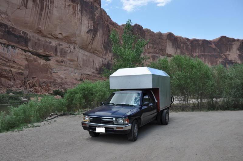

Nam Posted September 24, 2012 Posted September 24, 2012 Impressive work! did you ever try to weight the RV? does not look like much and what are you getting for MPG? Quote
Davidadro Posted September 24, 2012 Posted September 24, 2012 You are truly a metalsmith! Pretty darn impressive work and your frame will no doubt last till the next millennium! Keep us posted on your continued progress. Maybe attach some custom made side flares to the rail just above your rear tires to cover the width of the dual rears. I'm not 100% sure, but I believe some states do have a requirement for unprotected tire protrusion. You have an awesome custom build! Quote
Boy Posted October 12, 2012 Author Posted October 12, 2012 Impressive work! did you ever try to weight the RV? does not look like much and what are you getting for MPG? The rv weights 4800 lbs loaded with one passenger. Went to sell some metal before my trip at a local metal scrapyard and got the weight. The truck got roughly 18 mpg which i think is great for a 280,000 miles on the 22re beast. You are truly a metalsmith! Pretty darn impressive work and your frame will no doubt last till the next millennium! Keep us posted on your continued progress. Maybe attach some custom made side flares to the rail just above your rear tires to cover the width of the dual rears. I'm not 100% sure, but I believe some states do have a requirement for unprotected tire protrusion. You have an awesome custom build! Thanks, I'm planning to build boxes to place under the bed before my next trip but its wont be for awhile. Currently the box is being used as my shed Quote

Boy Posted September 26, 2013 Author Posted September 26, 2013 Its been quite sometime since i have gave my camper attention. My girlfriend and I are planing another trip for next summer to the NW. I have used the camper here and there for short trips and mainly as a shed until recently. Its back on the truck and its time for me to address the bugs before my next big trip. I will update this thread when i start my carpentry work and under mount storage space. I am building the kitchen cabinet for my uncle and there is a messed up wall mount section that i can use for my camper. Its gonna be a slow process but I'm glad i got more time this round Quote

Boy Posted December 29, 2014 Author Posted December 29, 2014 Can't believe its been over a year since I put the project on hold. It's time for me to jump start it again and I have some questions for those of you that own a 4x4 with the dually full floating axle. How did you or the previous owner manage to keep your e-brake system as the 2wd system is different? Any pictures will be appreciated. I have read about guys doing a 2wd --> 4wd with pickup trucks just using a 4wd axle to keep the e-brake but I want to keep the full floater. I will be converting it to a single wheel instead of using duallys. i have finally picked up a w56 transmission and ordered a marlin crawler adapter to have two transfer cases all I need left is manual pedal assemble since my truck is an auto clutch/flywheel clutch master/slave piece together a solid axle swap kit to keep the budget down custom front/rear driveline I will be able to achieve the same track width by using front wheels 16x8 with 2.5bs custom rear wheels from Stockton wheel 16x8 with 5.5bs as far as spare tire goes I will just have to bring along a plug kit and I have a no-mar bar I can use to swap out a loose tire aboard stay tuned Quote

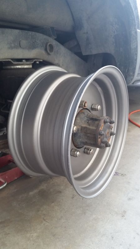

Boy Posted March 10, 2015 Author Posted March 10, 2015 I got my custom wheels from stockton wheels finally! I went with 15x8 instead of 16" rims. front 2.5" b.s. rear 5" b.s I believe I have sourced all my parts needed for the 4x2 to 4x4 conversion except front leaf springs and find metal for the front spring hanger. I'm still waiting for my 23 spine input shaft from marlin crawler. hopefully it will come soon to swap in the tranny and send out my order for the rear driveshaft. Anyone with pics of a 4x4 ebrake setup for the ff rear end? Quote
shibs Posted March 10, 2015 Posted March 10, 2015 this is one sick camper, kudos, I like your shell build, simple. wow, vhb tape for the skin, how is that holding up? How did you do the horizontal seams, and edge seams? Quote
zero Posted March 10, 2015 Posted March 10, 2015 Anyone with pics of a 4x4 ebrake setup for the ff rear end? I put a FF into an 85 and a 78. Both 2WD, but the E-brake cable ends on the FF rear were the same as the trucks had with the original semi-floating rear. So hook-up was easy. Quote
Boy Posted March 10, 2015 Author Posted March 10, 2015 I put a FF into an 85 and a 78. Both 2WD, but the E-brake cable ends on the FF rear were the same as the trucks had with the original semi-floating rear. So hook-up was easy. Quote
Boy Posted March 10, 2015 Author Posted March 10, 2015 The tape is holding up well. I run the tape along the length of the aluminum to aluminum joints as well. As for corners I haven't attached a 1x1 angle yet but that will come. It's just silicon for now. The tape is stronger then rivets and it has been on fwy with plenty of cross wind. The ff was designed for 2wd And the ebreak lever is attached to the transmission mount that us welded to the frame. 4wd it is along the frame rail. I hope to find a pic of a 4wd with a ff ebreak setup. If not I will have to figure something out. Quote

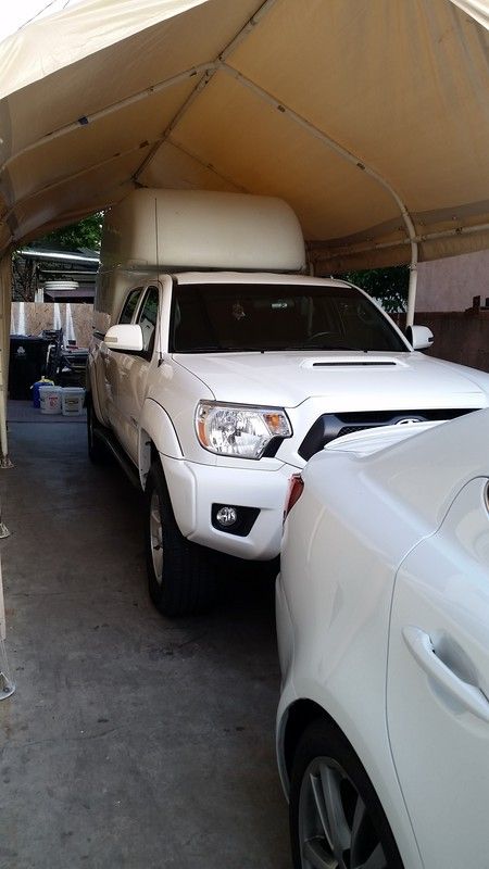

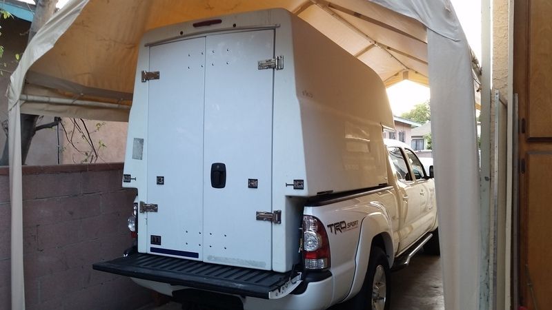

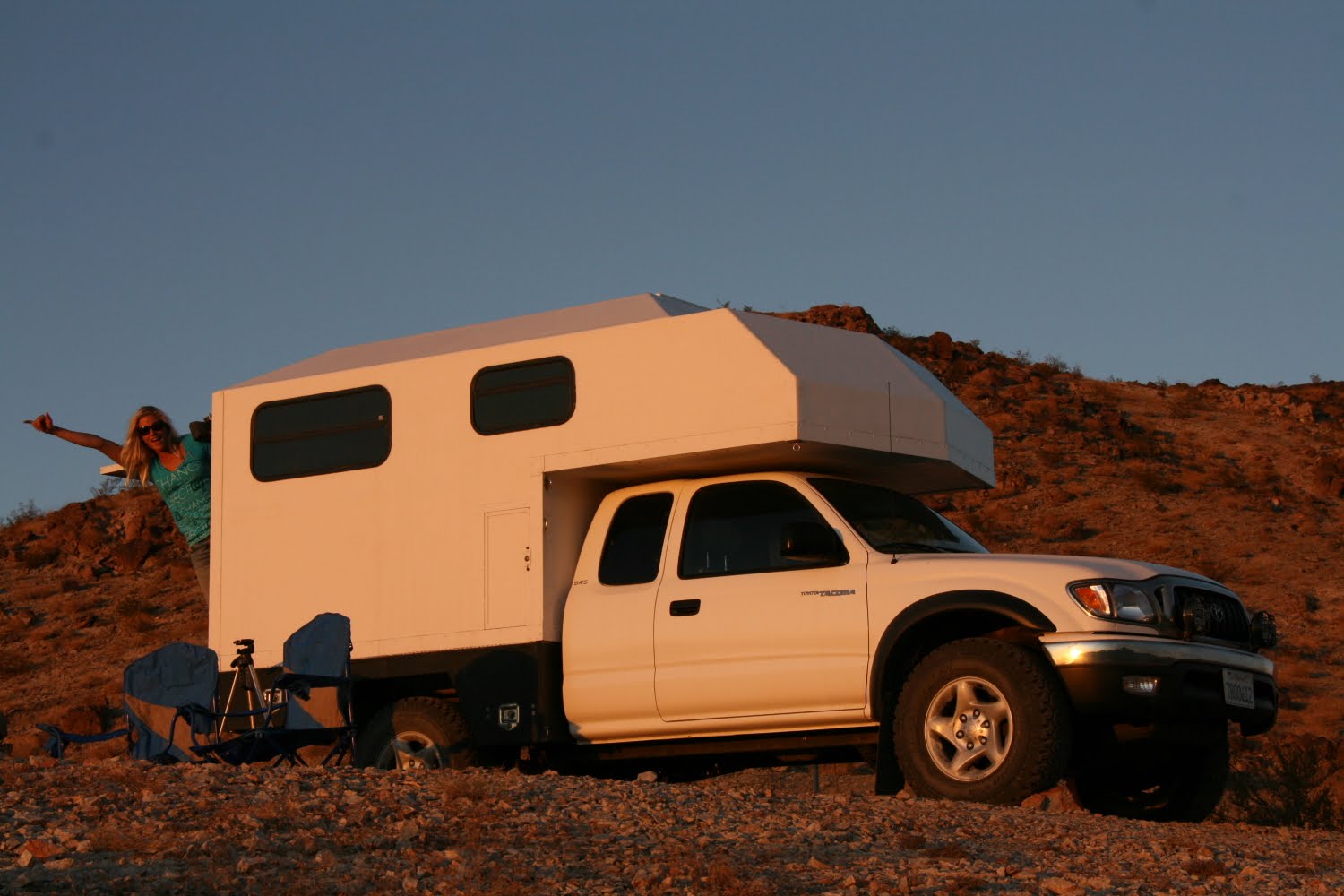

Boy Posted June 3, 2017 Author Posted June 3, 2017 Wow its been more then two years since i posted. I purchased a 2015 dclb tacama 4x4 and ended up selling all my 4x4 conversion stuff and used the blue truck as the work truck now. Well the camper is still used as a shed and will most likely be turned into a paint booth as I don't think there will be a market for it. Stumble upon a very neat Maranda V165 shell, so this will be my new temporary camper aka cheap sunrader. I still want to built another camper for the tacoma since the layout will have more space so stay tune for that in a couple of years. Quote
