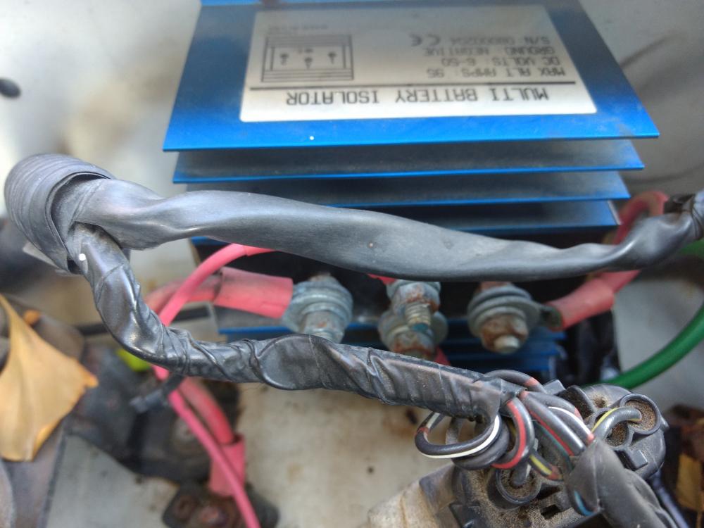

CappyGolucky Posted February 6, 2018 Posted February 6, 2018 When I bought my 78 micro mini Sunrider last fall the coach battery, a group 27 deep cycle marine, was located under the dinette bench along with an old power converter the previous owner had installed The battery was wired and getting juice from the engine battery but wasn't going through the isolator which he showed me was mounted under the hood near the empty battery tray where I assume the coach battery was intended to live. After doing a bit of research I just picked up a set of 6 V golf cart batteries to upgrade my coach battery capacity. Here is what I'm looking to do and I could use some advice from anyone who's got more experience with this stuff than me, which is probably most of you. Lol. I've now got the 2 6V batteries wired in series under the dinette bench making one 12 V combo. I'd like to move the marine deep cycle to the tray under the hood and have everything go through the isolator the way it should be to protect the engine battery . Does this make sense? What's the best way to wire it up so that I am drawing power from both the new 12v combo and the marine deep cycle or is it a bad idea having the two batteries far away from each other. Also, I haven't come across anything that looks like a power center. Any ideas where it would be located or even if these early models had a power center would be helpful. Thanks. Quote

Maineah Posted February 6, 2018 Posted February 6, 2018 Your isolator should take care of the issue once you turn off the key the batteries are seperated. You don't want to draw power from the engine battery to supply goodies just to start the truck unless you like walking. Am I understanding that you are replacing the truck battery? Or are you using that also for the coach? What kind of power do you expect to draw from the twin 6 volts? If you have a bunch of batteries you may end up with a charge issue the old alternator was only around 40 amps max. Your pair of 6 volts might top 200 amps plus the deep cycle near 90 then there is always the battery to start the truck. Quote
CappyGolucky Posted February 6, 2018 Author Posted February 6, 2018 (edited) No I didn't want to replace the truck battery. I just got a new one and it's in good shape. what I want to do is take the old coach battery from under the bench (inside) and install it under the hood. Then connect that to the isolator which right now I think is being bypassed. Then I want to connect that one in parallel with the 2 new 6V batteries which are now under the bench. So the idea is to have a coach battery bank consisting of the deep cycle 12 V battery under the hood and the 2 6V batteries inside the coach, and have all of those run through the isolator. I just had a new alternator put in which I believe is rated at 30 amps. Now are you saying that this battery setup will be too much for that for the alternator to handle? I intend to do a good amount of dry camping which is why I wanted a decent amount of battery capacity but will only be running a few lights, fans and maybe the radio. No microwaves or other high power appliances Edited February 6, 2018 by CappyGolucky Addition Quote

Maineah Posted February 7, 2018 Posted February 7, 2018 Why do you think you need two isolators? The ideal is to keep your truck battery from discharging, the one you have does that. A combiner will connect the batteries by voltage but you will have to chose the bank that needs to be "protected" usually that's the truck battery for more than one reason one you don't want that one to go flat and second it is connected to the alternator output. The combiners being "smart" allows the truck battery to charge first so if the coach is primary it will be the one that runs the show and when it's charge is higher it will attempt to charge the truck battery thus draining the coach battery because it has no way to recharge. Combiners can be hooked either way they don't care so it is important that the truck battery side is just that. The radio is pretty low current I don't believe I would over think that. The bottom line you should concentrate on isolating the truck battery from the coach. A simple pair of jumper cables would get you started from the coach batteries in a bind. If you are adding solar again that would be for the coach no need to charge truck battery if it's just sitting there doing nothing. Quote
WME Posted February 7, 2018 Posted February 7, 2018 I think you need to check things out from the beginning. Verify each part is working or not. Just throwing parts at a simple problem is not the way to go. Get a simple cheap Harbor Freight VOM, it will become your new BFF Looking at your picture I see the isolator and what appears to be an inline auto reset breaker. The breaker looks toasty. Check the isolator...https://www.youtube.com/watch?v=oqCUyJ2P3yI Quote
CappyGolucky Posted February 7, 2018 Author Posted February 7, 2018 58 minutes ago, WME said: I think you need to check things out from the beginning. Verify each part is working or not. Just throwing parts at a simple problem is not the way to go. Get a simple cheap Harbor Freight VOM, it will become your new BFF Looking at your picture I see the isolator and what appears to be an inline auto reset breaker. The breaker looks toasty. Check the isolator...https://www.youtube.com/watch?v=oqCUyJ2P3yI Yeah WME that post with the photo wasn't mine. Someone else jumping in I guess. I'm leaning towards going with the battery connector you recommended and maybe this spring or summer investing in a 100w solar kit for starters. Thanks for the help all. Quote

Maineah Posted February 14, 2018 Posted February 14, 2018 5 hours ago, CappyGolucky said: Yeah that was my intention to replace the old solenoid relay with the combiner. But from what you're saying it sounds like they are wired completely differently . I'll have to get under the hood and check it out but i'm pretty sure the existing isolator is being bypassed right now so the truck battery is directly connected to the coach batteries with no protection. I was looking at the picture you posted, if it has a relay type isolator then it is a direct replacement. The small relay wire will no longer be used so that will have to be removed or protected because it will be hot with the key on. I'm still confused as to what you a trying to accomplish if the picture you posted is what you have it is not a relay isolator and will require a bit of wiring to make the combiner work. The solid state isolator has 3 or in your case with a "91" MH 4 wires two battery wires one alternator wire and an exciter wire. The truck battery wire will have to be joined to the alternator wire or it won't charge either battery. Here is the deal years ago (and even to this day) the coach wire was only a # 8 or at best a # 6 wire this was fine for low demand use but as WRE said if you want max smoke you need to upgrade the wire. It boils down to how much power do you really need? With the stock wiring and a couple hundred amp batteries the small wire will take a long time to charge your batteries, lots of miles of driving. If you are going to use solar you need to figure out just how much power you are going to use and just how much power the panel can provide on any given day if they don't equal out the batteries will not be charged. A simple fix would be a generator and a good converter/charger if you want a lot of current. Quote
CappyGolucky Posted February 14, 2018 Author Posted February 14, 2018 22 hours ago, Maineah said: I was looking at the picture you posted, if it has a relay type isolator then it is a direct replacement. The small relay wire will no longer be used so that will have to be removed or protected because it will be hot with the key on. I'm still confused as to what you a trying to accomplish if the picture you posted is what you have it is not a relay isolator and will require a bit of wiring to make the combiner work. The solid state isolator has 3 or in your case with a "91" MH 4 wires two battery wires one alternator wire and an exciter wire. The truck battery wire will have to be joined to the alternator wire or it won't charge either battery. Here is the deal years ago (and even to this day) the coach wire was only a # 8 or at best a # 6 wire this was fine for low demand use but as WRE said if you want max smoke you need to upgrade the wire. It boils down to how much power do you really need? With the stock wiring and a couple hundred amp batteries the small wire will take a long time to charge your batteries, lots of miles of driving. If you are going to use solar you need to figure out just how much power you are going to use and just how much power the panel can provide on any given day if they don't equal out the batteries will not be charged. A simple fix would be a generator and a good converter/charger if you want a lot of current. Actually that wasn’t my pic. Sorry for the confusion but it looks like someone else jumped into the thread. Haven’t been able to post pics from my iPad but what I have is a very old and worn lookin solenoid relay which has been disconnected and bypassed. Youre correct however about the wire. Looks like about only 10 or even 12awg. I agree with u about upgrading it. This job is getting a little more complicated than I was hoping and I’m not big on messing around with electrical systems. May need to bring it in and get some help with it. Unfortunately there aren’t many RV techs in my area. May try a car audio shop. I know they work with dual batt systems some. Thanks for the help. Quote
