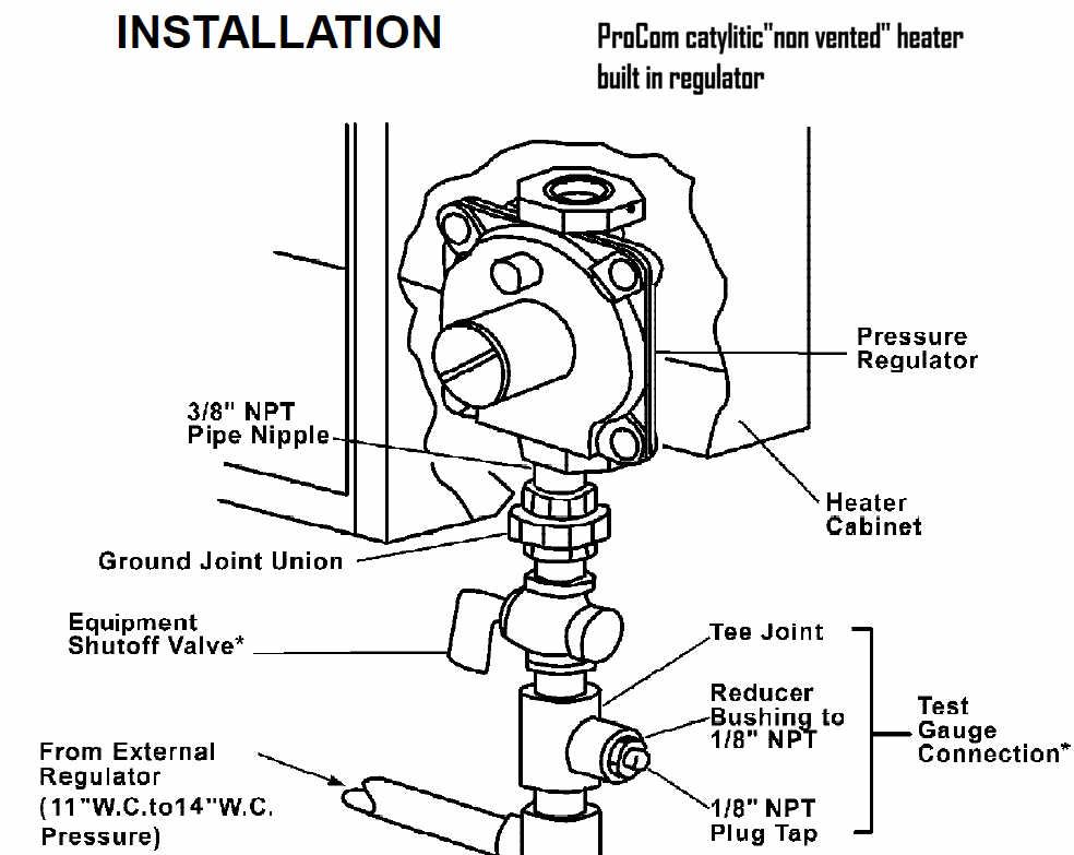

zero Posted December 24, 2012 Posted December 24, 2012 One is intended for a fix location in a living space the other is portable. The small one has no regulator of it's own the portable one does it uses a 20# tank (BBQ) not 20 gallons. Neither one is intended to be used in a sleeping space. They do make RV heaters that are safe but they are very pricey. http://www.ventedcatheater.com/ Both the ProCom "non vented" heaters have their own regulators built into the heaters. So when hooked to a propane tank that also has a regulator -there are two regulators in the line. The heaters you linked to are hard-powervented heaters. Just as the conventional RV heaters are. The specs show an 1 1/2" exhaust vent for them. Maybe they're more efficient then the standard RV propane heater but the company has no efficiency specs posted that I can find. From the ProCom manuals showing the built in regulators: Quote
Maineah Posted December 24, 2012 Posted December 24, 2012 OK bad chose of words the living space heater requires two regulators for good reasons the portable ones don't you must install a regulator at the supply tank if you are going to mount it in a living space. The same goes for an RV they have two. The vented RV heaters have a small forced draft fan and are far more efficient then the noisy open flame RV heaters that require blower fans and lots of propane. I would buy one in a heart beat if I did a lot of cold weather camping. Quote
