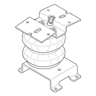

jjrbus Posted May 4, 2015 Posted May 4, 2015 I'm home and have the toy up in the air to replace the air bags. I pulled one out to get the numbers and not much luck there. They are stamped Firestone Riderite and the only number showing is 224C. An internet search shows I might have kit # 1130 which uses Firestone air spring # 6873. My existing kit looks nothing like the Firestone picture? The firestone site shows # 6873 has 2 studs on top and one blindnut on the bottom. My bag/spring/bellow has 2 studs on top and 2 blindnuts on the bottom? Little tired of trying to chase this down on the internet so any input greatly appreciated. Jim SW FL Opps I D 10 T error. 93 Toyota Seabreeze 6 Cyl Auto. Quote
Derek up North Posted May 4, 2015 Posted May 4, 2015 You say yours looks "nothing like" the 6873. Are your studs spaced @ 2.75"? Are the bottom ones spaced @ 2.75" & 3/8"-16? Any chance you could drill your existing bracket with a single 7/16" hole and use the 6873? Quote
Derek up North Posted May 4, 2015 Posted May 4, 2015 Sounds like you might have F0335 air springs. Check the dimensions. http://www.etrailer.com/Accessories-and-Parts/Firestone/F0335.html Quote
jdfrost64 Posted May 4, 2015 Posted May 4, 2015 1130 work if you have at least 3 inches of clearance from frame to tire. Quote
jjrbus Posted May 4, 2015 Author Posted May 4, 2015 I thought the kit looked nothing like the 1130 but I was mislead by "picture may not be an actual representation of product shipped". This is what I have. The airbag is a double convoluted, The studs on top are fine thread and spaced 2.75" The bottom holes are spaced 2.75" and are 3/8 16. Yes drilling a single 7/16" hole in the bottom is an option. FO 335 Appears to be very close to what I have. I did find more numbers stamped on the metal top part, 2722D 3071, but a web search returns nothing? Any cheaper options? Thanks for the quick response, always appreciated. JIm SW FL Quote
jjrbus Posted May 4, 2015 Author Posted May 4, 2015 1130 work if you have at least 3 inches of clearance from frame to tire. 1130 seems to be the entire kit. I have the kit and need to replace the air bags/springs/bellows. Thanks JIm http://www.amazon.com/Firestone-Ride-Rite-Brackets-Inflation-W217601130/dp/B0034NXJKS Quote

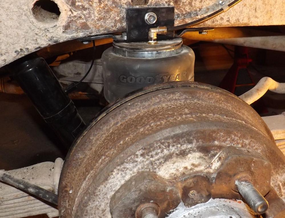

jjrbus Posted May 22, 2015 Author Posted May 22, 2015 A simple job taking 3 weeks! Defective parts, waiting for parts. Fittings were $6.50 each so I did not want to order until I had usable airbags. Fittings were not available locally took 8 days for delivery, rather frustrating. The 1/2" MNPT X 1/4" push in fitting almost worked, see photo. My options were drill out bracket to clear fitting or shim. I decided to add a 3/16" shim between top of air bag and upper mount so fitting would clear. In the grand scheme of things 3/16" should not make that much difference. I hope? Shim, ie cut up bed frame! The upper mount on the passenger side was welded to frame so taking top nuts off was an uncomfortable time consuming project. Removing U bolts on bottom was a struggle until I decided to cut out air bag and use impact wrench to remove nuts. Multi-tool and utility knife made quick work of bag. Wish I had thought of it on other side Left click on photo to enlarge. Made a holder (more bedframe) so as not to stress air bag when installing fitting. Note, air bag is not centered on mounting bracket, need to pay attention to brackets when removing. Not posting as a how-to by someone knowledgeable, just my experience. Jim SW FL Quote
jjrbus Posted May 23, 2015 Author Posted May 23, 2015 I impressed myself by using shims so bracket would clear fitting. I was surfing another Toy sight and noticed shims between air bag and bracket. Must be a common issue? Left click photo to enlarge Jim SW FL Quote
jjrbus Posted May 29, 2015 Author Posted May 29, 2015 I am ready to install the 2nd airbag and even with the shims there is not enough room for the fitting to clear the upper bracket which is welded to the frame. I look I poke I prod, something is slightly different? Ended up I had to drill and grind the bracket to create enough clearance for the fitting. Not a fun job working in the wheel well. I am going to have to give the discount airbags with a 1/2" port a doable but not the best idea rating. Jim SW FL Quote

jjrbus Posted July 5, 2016 Author Posted July 5, 2016 In the last couple months I have noticed a slow leak in the air bags.  I spent a bit of time here and there looking it over but did not see a leak. Yesterday I decided to pull the wheels and go over it until I found the issue. I soaped everything up and sat patiently and watched. It took some time but there are 2 small leaks where the rubber is crimped to the upper mounting plate. I sent message to seller and they asked if I had checked all the fittings.  I responded yes and am waiting for a reply.    Jim Quote
