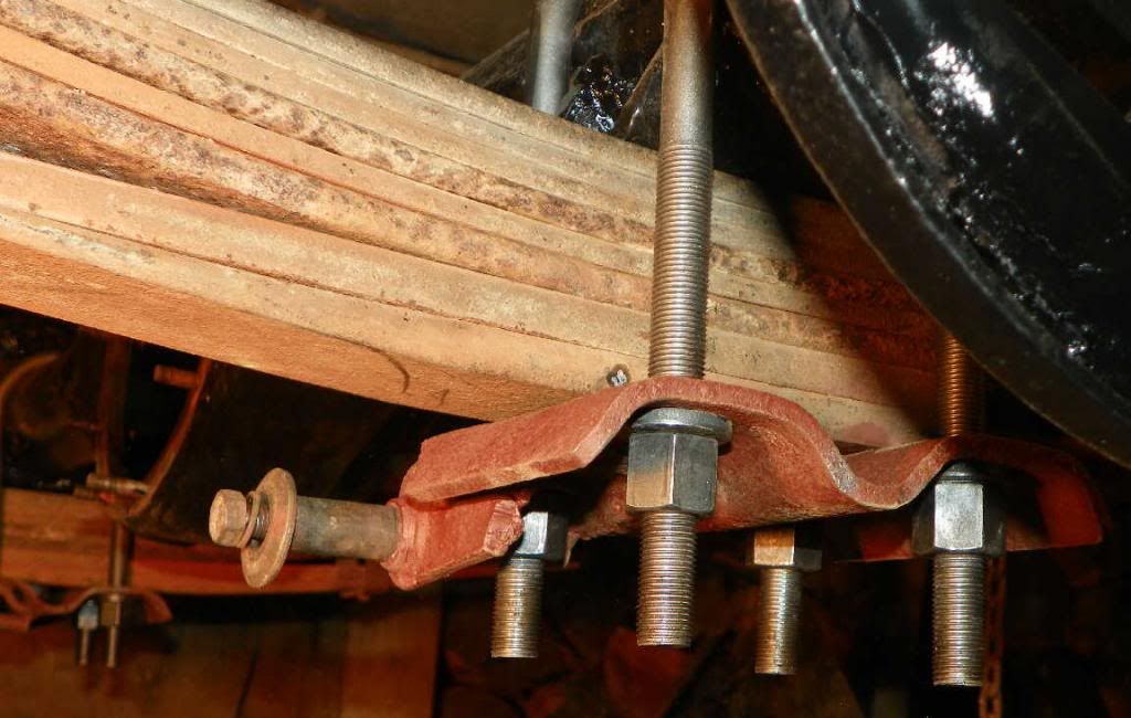

zero Posted December 22, 2012 Posted December 22, 2012 I added two leafs to the spring pack. Spring in background is still original. One is foreground has the two leafs added. A standard Dorman 3/8” centerbolt is all is needed to put the spring pack together. I took the original bottom brackets that hold the shocks and u-bolts. I torched off the corners that held the bottoms of the shock absorbers. I put those corner pieces into a set of brackets off a ½ ton Chevy Blazer. Lined up the bolt-hole and welded. This is how it looks installed. I now have the shocks mounted to the upper front crossmember as it was with the original axle. Quote

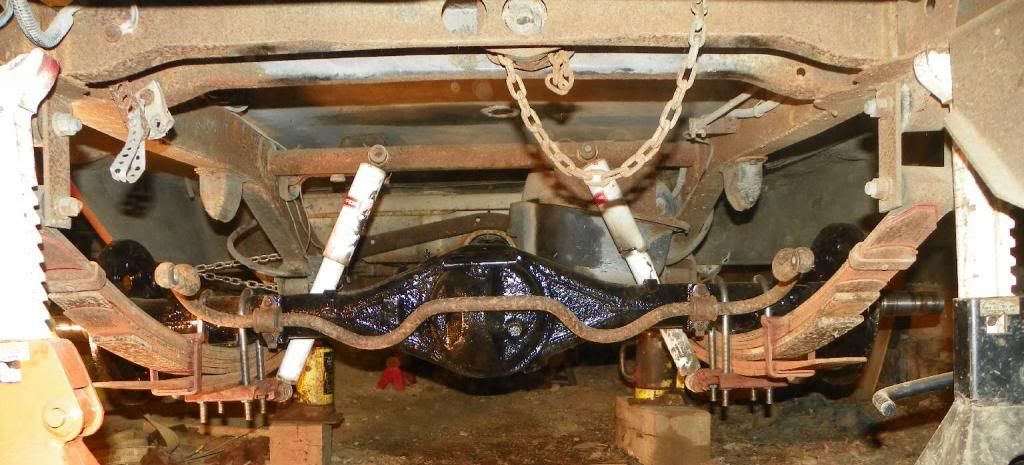

Sunrading Arkansas Posted January 30, 2013 Author Posted January 30, 2013 The new axle is in!!!! Wooo Hooo!!! Well, pretty much. Here's where things are at: I spent a fare amount of time, while the weather was cold, repacking the wheel bearings, replacing all the inner and outer seals, draining and refilling the differential oil, new poly shackle bushings, etc. Unfortunately I didn't photograph any of this process...mainly because my hands were covered in 90wt and bearing grease, and also because it's been pretty well documented here already. But this really came in handy As I stated previously, my Full-floater came out of another conversion so I didn't encounter a lot of the grief that I could have. The only P.I.A part was getting the Left-Front spring shackle bolt-assembly in&out because they mounted the black water tank virtually right up against it... I avoided dropping the tank by lightly jacking up on the bottom of the tank just enough to squeeze the bolt-assembly out...hopfully didn't break any seals or cause any leaks....guess we'll see. I did have to figure out a shock mount set-up that would work forward and aft of the axle (as mine didn't come with suitable upper mounts and I didn't want to go back to the junkyard to find spring plates I could modify to use the existing uppers on the cross member...my welding is not something I was going to trust either). So here was my bolt-on solution... The shocks I ended up going with (Load-Adjusting Monroes...yeah yeah Bilsteins are the second coming blah blah blah...I'm cheap and these were well reviewed) came with hardened mounting bolts long enough to go through the frame and mount the shocks on the other side. I used a 1" spacer to keep the shock straight and true. Now, I'm replacing all the U-joints in the drive shaft, painting the duallys and hub assemblies, connecting the E-brake cables and then I'll finally get to set the poor Sunrader back on the ground where she belongs after a month in the air. I'll update again at that point. Thanks again to jdemaris & everyone else who's contributed to this site for all the useful info and help. -Patrick Quote

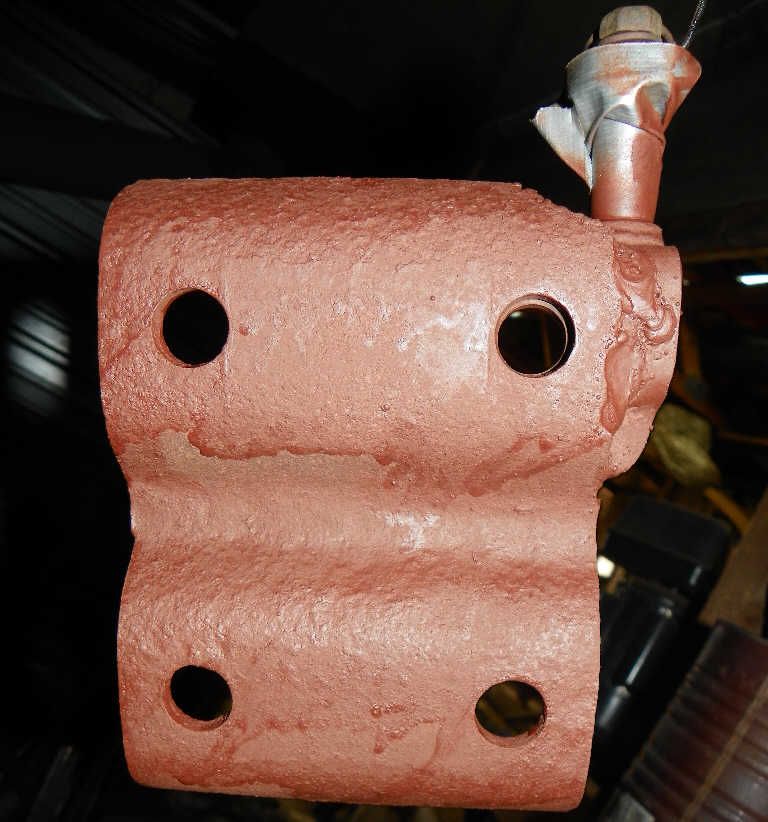

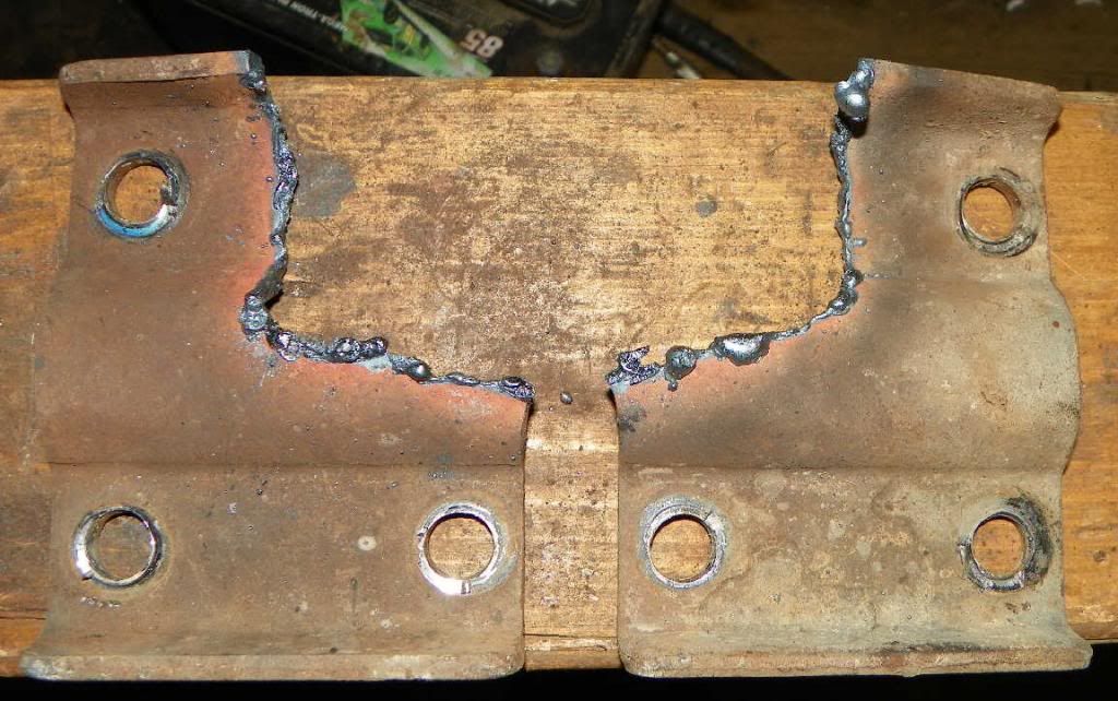

zero Posted January 31, 2013 Posted January 31, 2013 I did have to figure out a shock mount set-up that would work forward and aft of the axle (as mine didn't come with suitable upper mounts and I didn't want to go back to the junkyard to find spring plates I could modify to use the existing uppers on the cross member...my welding is not something I was going to trust either). So here was my bolt-on solution... The shocks I ended up going with (Load-Adjusting Monroes...yeah yeah Bilsteins are the second coming blah blah blah...I'm cheap and these were well reviewed) came with hardened mounting bolts long enough to go through the frame and mount the shocks on the other side. I used a 1" spacer to keep the shock straight and true. -Patrick I've got a new set of load-assist Monroes sitting here that would not work. 1" too short. They come 1" shorter then the standard shocks and once I beefed up the leaf-spring stack - they are too short. I wouldn't trust those top shock mounts the way you did it - but I could be wrong. The Toyota frame is only thick on the outside, top, and bottom. On the inside- it's as thin as a Coke can and I doubt will bear the load from a spring-loaded shock too long. It use a steel gusset plate added to the inside. I put in 3/16" thick steel gusset plates on the inside of my frame so I could attach the top links of the rear stabilizer bar. I suspect Toyota doesn't trust the inside of the frame for mounting anything either since they too use extra steel gusset plates wherever mounts are used. Quote
Sunrading Arkansas Posted January 31, 2013 Author Posted January 31, 2013 (edited) @Stevo - I used 4 Jackstands (2 Forward and 2 aft of The axle) and two oversized tires&rims under the rear bumper. It wasn't going anywhere, but it took two 3.5 ton floor jacks with 4x6s on top to get it up (just) high enough. @jdemaris - The inner wall of the frame on mine seemed to be the same thickness as the outside. I figure if it starts to look weak once it's down I'll weld a sleeve through/to the frame around the bolt - not unlike the crossmember uppers. For now I'll keep my fingers crossed. Thanks for the feedback! -Patrick Edited January 31, 2013 by Sunrading Arkansas Quote

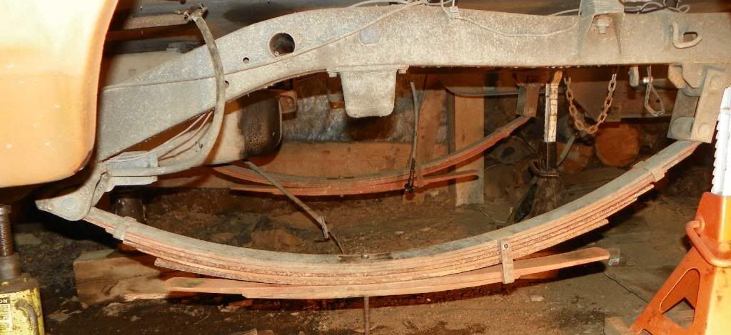

Sunrading Arkansas Posted February 1, 2013 Author Posted February 1, 2013 @Stevo - I pulled mine, springs and all out sideways. I used my two floorjacks as rollers under each break drum and just rolled it out. But with everything still attached (Springs, drums, axles, etc.) it's HEAVY. Quote
