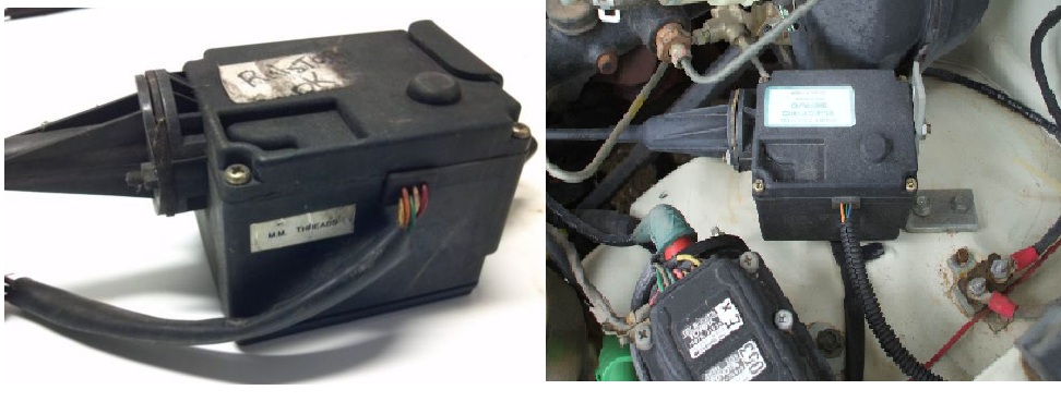

LEFT - Harley Cruise Control Module RIGHT - Toyhouse Cruise Control Module (servo)

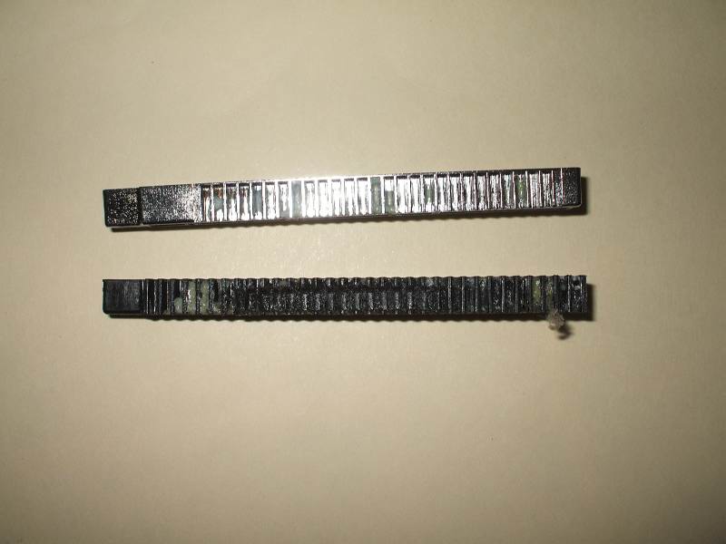

The good news - The original rack gear was made of plastic and had stripped. The rack gear in the Harley servo unit is metal :ThumbUp: :ThumbUp:
The bad news - The metal rack is about 1/32 inch wider than the plastic rack and will not fit in the groove.:ranting2:

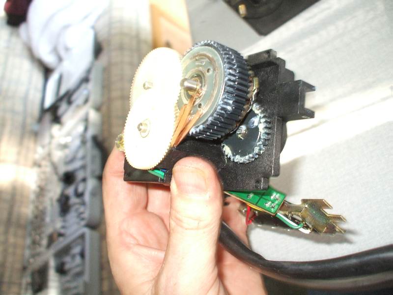

The units are not drop in compatible. there is a slight difference in wiring and the plugs, probably the slide switch (SET / RESUME, etc).
The internal gear train mount looks identical, except the track that the rack slides in is definitely wider in the Harley unit.

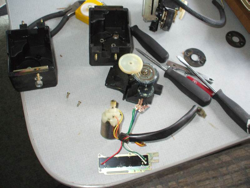

I can take the electrical stuff out of the toy unit and install it in the Harley unit. Original electrical stuff, installed in the Harley case.

Photo 1 - This is the internal gear train assembly that I switched. The mounting plate is what needed to be switched as it has the groove that the rack fits into.
Photo 2 - The electrical stuff (motor, clutch contact points, resistor) is switched between the Toy unit and the Harley unit
Photo 3 - The rack gear - you can see where the black plastic is stripped.
