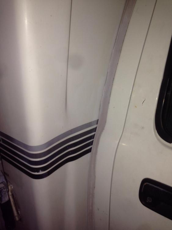

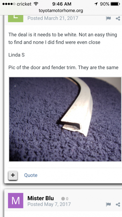

linda s Posted March 21, 2017 Posted March 21, 2017 The deal is it needs to be white. Not an easy thing to find and none I did find were even close Linda S Pic of the door and fender trim. They are the same Quote

linda s Posted May 8, 2017 Posted May 8, 2017 No nothing even close. There are some flap seals in black that might be usable but they wouldn't lock in the same way. I have never taken mine off so I don't really know how they fit in. Got that pic from another member looking for it. I will tell you this. Advantage RV that still makes the fender flares for Sunraders has a tiny bit left and they the only way to get it is to buy 2 fender flares and pay for the install. He won't sell it any other way. If he can't get more no one can. Show me your door so i can see how bad it is. I'm thinking maybe you could fill the gaps with something like this https://www.amazon.com/Performix-075815122094-Create-Your-Color/dp/B0027JIEPU Linda S Linda S Quote

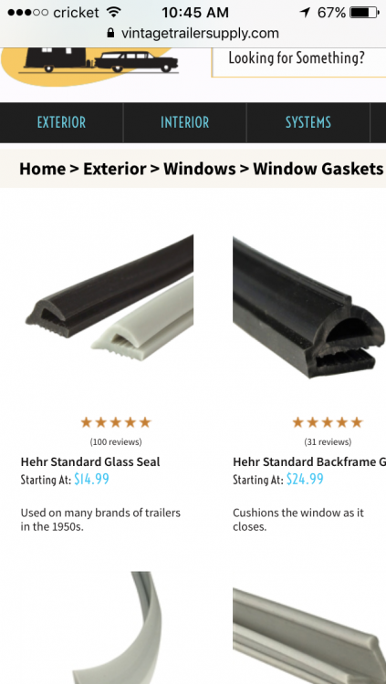

Rockin Posted May 13, 2018 Posted May 13, 2018 I found a part that looks similar. Do you think this could be used? May seem crazy, but maybe worth a try. Quote

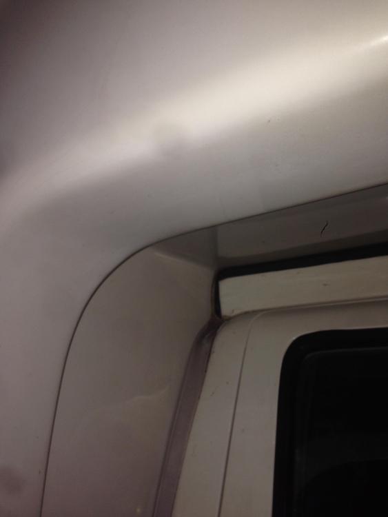

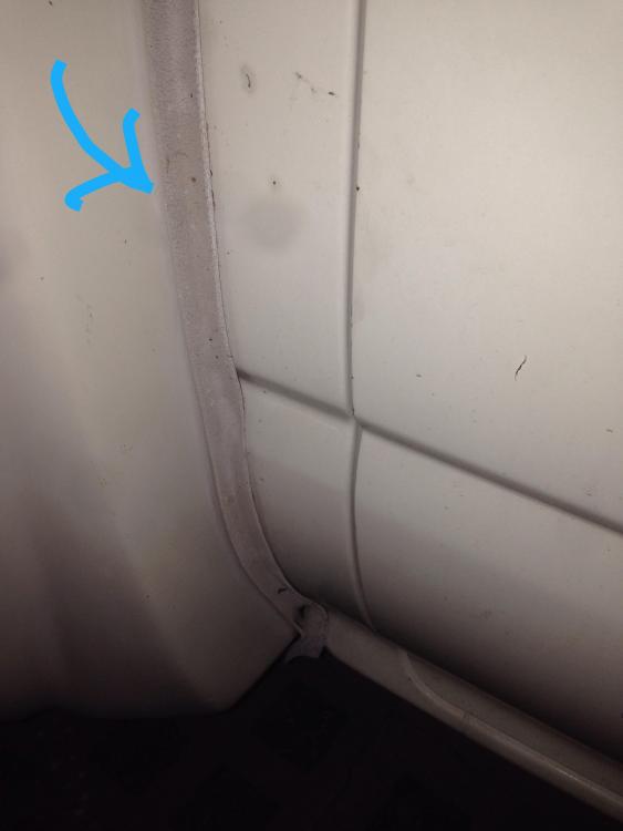

Rockin Posted May 13, 2018 Posted May 13, 2018 1 hour ago, Derek up North said: Tooling + set-up cost + minimum production run = BIG $$$$$ I don't think 3D printing is a good application for long extrusions. Yet. I agree, but check out what I found. I might buy a stick of it to try. Has anyone found the piece that seals between the cab and cabin? Quote
linda s Posted May 14, 2018 Posted May 14, 2018 For the cab to chassis. White garage door seal https://www.lowes.com/pd/M-D-30-ft-White-Vinyl-Garage-Weatherstrip/1096027?cm_mmc=SCE_PLA-_-ToolsAndHardware-_-WeatherstripSoftGoods-_-1096027:M-D&CAWELAID=&kpid=1096027&CAGPSPN=pla&store_code=1087&k_clickID=5a1295fd-3f36-42f7-8dc0-d9c8ab336ff9&gclid=Cj0KCQjwxN_XBRCFARIsAIufy1b_e3k1ePdIzTON6NWr2Voteb9ShNHp2ELxfpxE93R-vqOScAiTGrAaAi5QEALw_wcB Linda S Quote
Rockin Posted May 14, 2018 Posted May 14, 2018 7 hours ago, linda s said: For the cab to chassis. White garage door seal https://www.lowes.com/pd/M-D-30-ft-White-Vinyl-Garage-Weatherstrip/1096027?cm_mmc=SCE_PLA-_-ToolsAndHardware-_-WeatherstripSoftGoods-_-1096027:M-D&CAWELAID=&kpid=1096027&CAGPSPN=pla&store_code=1087&k_clickID=5a1295fd-3f36-42f7-8dc0-d9c8ab336ff9&gclid=Cj0KCQjwxN_XBRCFARIsAIufy1b_e3k1ePdIzTON6NWr2Voteb9ShNHp2ELxfpxE93R-vqOScAiTGrAaAi5QEALw_wcB Linda S Quote
linda s Posted May 14, 2018 Posted May 14, 2018 I have mine but never put it on. When I took the old stuff off there was a huge gap between the cab and the coach that I had to fill before I could attach it. I have heard of people using contact cement or other types of glue. Some used a glue gun. Sometimes they applied white caulk to the edges. When I get around to mine I think I'm going to use that new flex glue. Very sticky and hold instantly. Seems to make a very strong bond. Glued the head back on my weed eater and it's still holding Linda S Filled the gap with exterior caulk. Was white so it looked good for a while. Not white anymore. Time to finish the job Quote
Rockin Posted May 14, 2018 Posted May 14, 2018 7 hours ago, linda s said: I have mine but never put it on. When I took the old stuff off there was a huge gap between the cab and the coach that I had to fill before I could attach it. I have heard of people using contact cement or other types of glue. Some used a glue gun. Sometimes they applied white caulk to the edges. When I get around to mine I think I'm going to use that new flex glue. Very sticky and hold instantly. Seems to make a very strong bond. Glued the head back on my weed eater and it's still holding Linda S Filled the gap with exterior caulk. Was white so it looked good for a while. Not white anymore. Time to finish the job Thanks so much! That helps- mine is really warped. I guess I could clean and caulk over it.,... Quote
