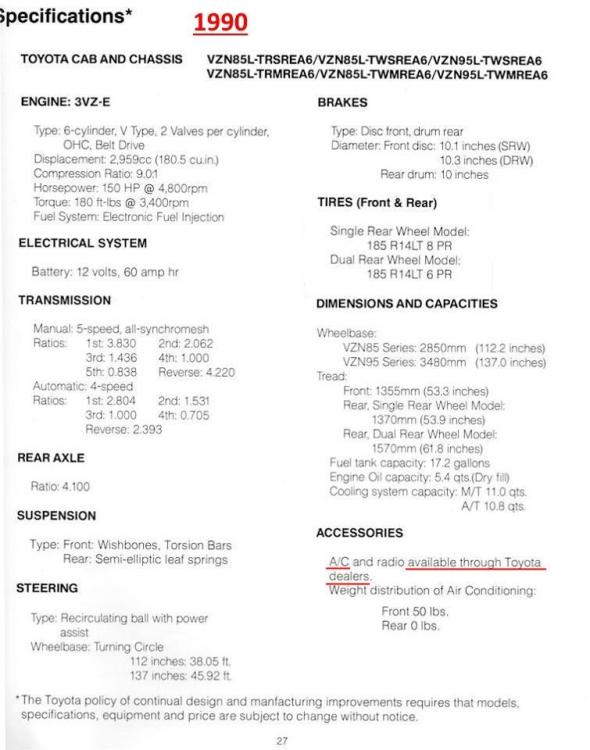

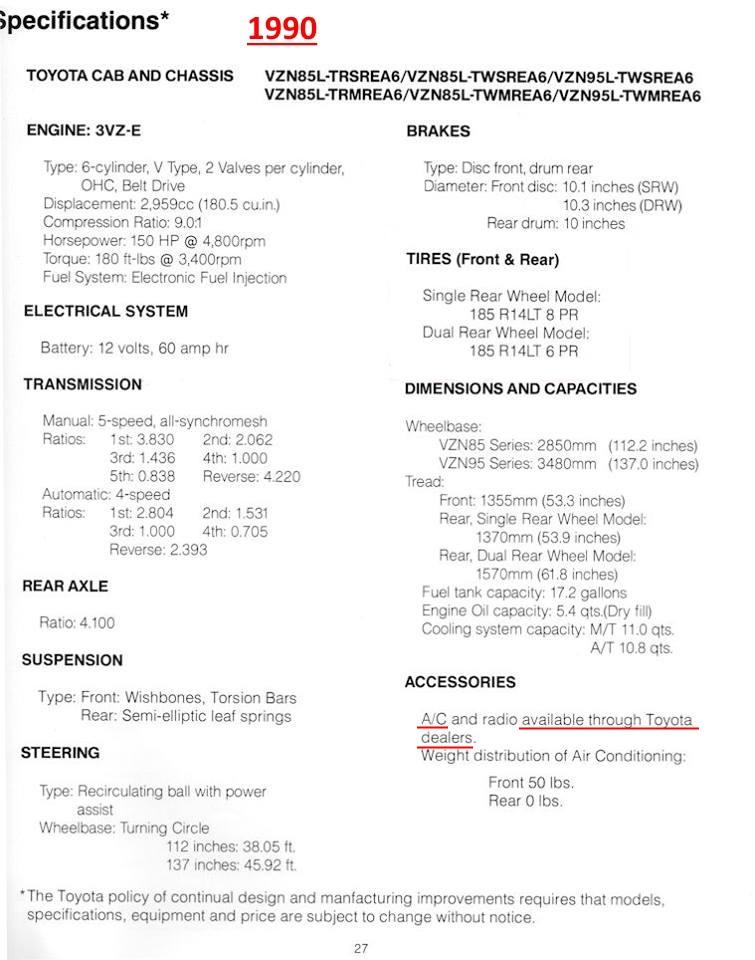

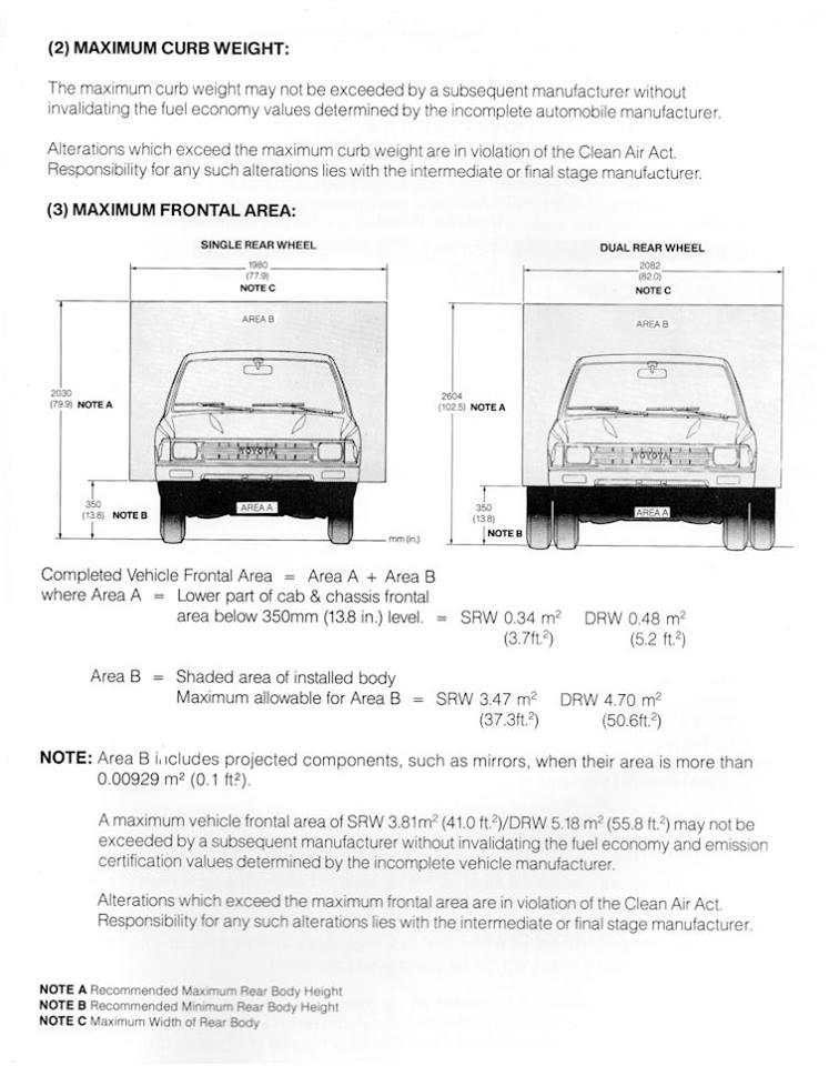

Derek up North Posted May 25, 2018 Posted May 25, 2018 1 hour ago, DanAatTheCape said: I am guessing the cab & chassis is different from the regular toyota pickup. Well, the best info I've got (the C&C Builders Manual) indicates that the C&Cs were delivered by Toyota without A/C. So I'm pretty sure it's standard truck components. Quote
DanAatTheCape Posted May 25, 2018 Author Posted May 25, 2018 (edited) the service manual I have has an ac section. It looks like std toyota for that era. That C&C manual looks like it might be interesting. Is it hardcopy or digital? could you post the front cover? I'm guessing the rv makers added the AC if the chassis came over without it. Edited May 25, 2018 by DanAatTheCape Quote
Derek up North Posted May 25, 2018 Posted May 25, 2018 I don't have the whole Manual. Just a few pages. Quote
DanAatTheCape Posted May 25, 2018 Author Posted May 25, 2018 I'd like to get a pdf copy of that..... Quote

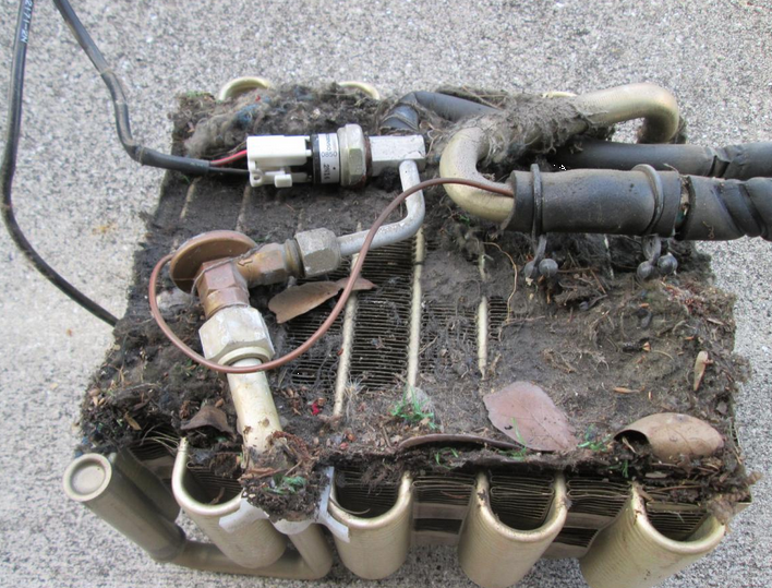

DanAatTheCape Posted June 2, 2018 Author Posted June 2, 2018 (edited) Well The job is "complete" -- unless I get frisky and decide to drop the cooling unit and change the expansion valve. It should be done, but I am not up to it right now. I used the rockauto.com compressor & dryer. My original compressor had a 6" diameter pulley which is discontinued. Plenty of 5.5 pulley clutches which make the compressor turns a little faster which in my theory makes more cold air. Anyway I went to a slightly smaller ac belt (from 36" to 35.25). Added 2 cans of r134. The compressor came with pag46 oil so I got a can of that and wet down the orings for the compressor & dryer. Turns out that a newer Oreilly's in Titusville FL has a loaner vacuum pump (to evacuate the system) and the manifold gauges (so you can see high and low pressures at the same time and makes it easy to add freon). Very warm around here today (East Central FL) -- was able to see 50 degree output. I pulled a curtain down over the back of the cab and as it kept recirculating air it seemed to be slowly getting colder. To get compressor out: 1) remove battery; 2) remove air intake assembly; 3) remove fan and shroud(requires upper radiator hose has to be disconnected),, also rock guard under radiator; 4) removed belts; 5) removed power steering pump - did not disconnect fluid lines, includes triangler looking bracket; 6) removed compressor - mounting bracket & compressor come out as unit. Edited June 2, 2018 by DanAatTheCape Quote
jjrbus Posted June 2, 2018 Posted June 2, 2018 No need to remove the evaporator, waste of time : ) Quote
DanAatTheCape Posted June 2, 2018 Author Posted June 2, 2018 52 minutes ago, jjrbus said: No need to remove the evaporator, waste of time : ) I was concerned that I might see something like that..... The toy service manual clearly states NOT to use water to clean the cooling unit - use compressed air. Any comments on why water is a no-no? Quote
jjrbus Posted June 2, 2018 Posted June 2, 2018 No idea, I gave up trying to clean and replaced it. Too much crud in it. The one part in my system I did not replace was the pressure switch, I had to take the system apart a 2nd time and replace the pressure switch as it leaked! Quote
DanAatTheCape Posted June 7, 2018 Author Posted June 7, 2018 (edited) well I put in the new expansion valve - evaporator was not very dirty - got a can of ac coil cleaner from Home depot - took a 3 or 4 cycles but it looked pretty good when I put it back together. It was putting out 40 degrees with the cab curtain down -yah! Evacuated the system yesterday for an hour. Left the gauges hooked up overnight -stayed within 5 psi. Evacuated for another 1 hour this morning, waited 30 minutes then added 2 cans of R134. BTW, the rockauto parts "GPD" brand have "Korea" tags on them.... Seem to work fine. BIG SHOUT OUT for Oreilly's Auto Parts Titusville/Cheney Highway for having a "loaner tool" vacuum pump and manifold gauge set. Edited June 7, 2018 by DanAatTheCape Quote
