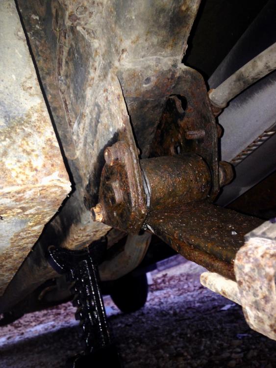

I now have the vehicle frame up on 3-ton jack stands and have PB Blaster-ed all the bolts/nuts in the vicinity of the bag, including the dreaded u-bolts. I am monkeying with a jack under the differential in order to raise the axle to the point where "tension is relieved from the leaf springs," as my repair manual puts it. Problem is, I can't tell when that happens. Can somebody provide a little insight here, please? I can move the axle up and down just fine, but at no point is it obvious that the leafs are no longer under tension. Don't really want to start pulling stuff apart until I get this straight. What am I missing?
Here's a reference photo, so you can see where I'm at... literally. Thanks for any help!

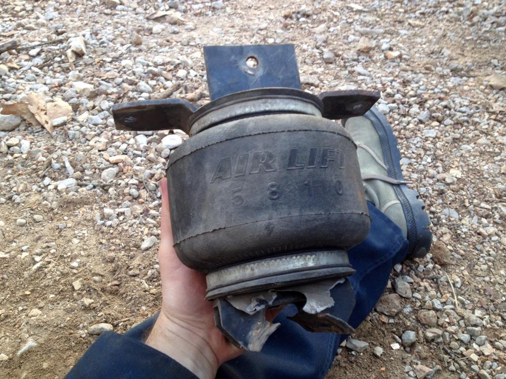

Eh, maybe I was being over cautious. Went ahead with tear down and got everything free, no broken bones etc. Here's the old leaky bag...

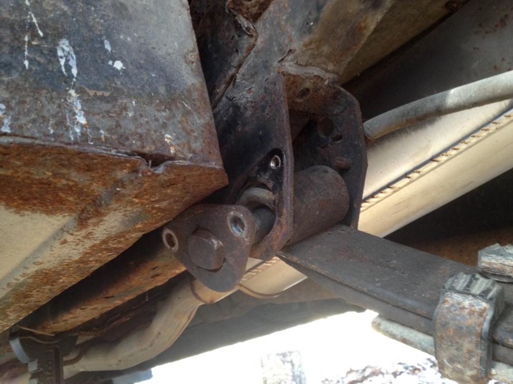

I'm also going to try and replace any of the leaf spring bushings that are bad while I'm in here... this front hanger pin, however, seems to be blocked by a nearby cargo compartment (like 1" clearance). Anybody come up against this and have an idea on how to remove that pin?

Just for reference, here's a picture of this front pin/bolt thingy, all by itself:
The bolt bracket flange, clean, drill, braze bolt. Metric Grade 10.9 bolt.  Use metric bolt so bushings fit. There is some reason I didn't just bolt a new flange/bolt to the other side, don't remember why

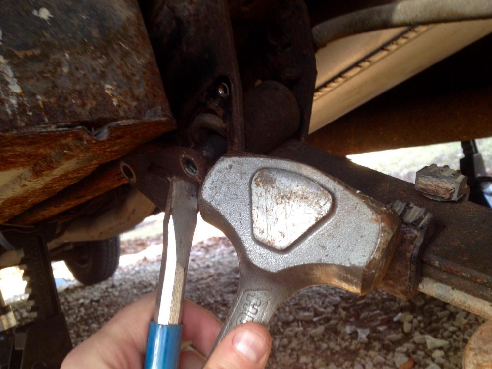

Got it done and back on the road with a new bag and some new poly bushings! I lucked out on that front hanger pin and didn't have to do anything extreme with it: broke the flange on the pin free by beating it hard with sledge and cold chisel. Then, since I already had the rear end of the leaf free, I realized I could wiggle and twist things enough to slide that pin down and out, even with the nearby obstruction.

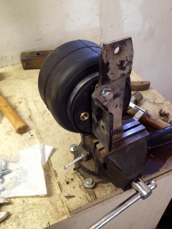

Got the passenger side bag finished up this afternoon. I would estimate the job at about 1-2hrs, for most of us (always dependent on skills/tools/Murphy).
Just as an FYI, I realized this time around that you do not need to loosen/remove the axle u-bolts in order to remove the air-bag (see photo). Some bright mind left just enough room to loosen the bottom two mounting bolts—they're fiddly, especially the rear-ward bolt with a brake line right in front of it, but it can be done with a box wrench and makes the whole thing much simpler.
