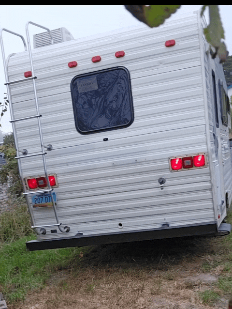

  24. I have a 1988 Dolphin with 2.4 4 cycl.. I live in Denver co. Area therefore the O/D doesn't work. What is the best way to bypass this? Any help would be greatly appreciated. Thanks Clay
