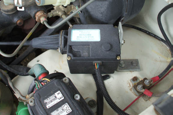

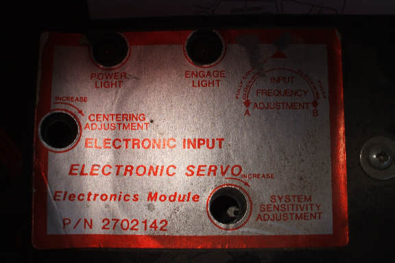

waiter Posted January 1, 2011 Posted January 1, 2011 (edited) I found the cruise control control box while installing the remote starter. The CC does work, but has issues; 1) The highest it be set is 59 mph, If I try and set it higher it drops back to 59. It did a good gob of holding 59, even in hilly country. 2) Its to sensitive on the throttle To fast on needing more and also releasing, it gets into a hunting mode. 3) Brake drops out OK, but when I turn on the turn signals (either one) it drops out also. Attached are a couple photos of the Servo and the Control box, Any help on identifying these and documentation would be greatly appreciated. John Mc 88 Dolphin 4 Auto Edited January 1, 2011 by waiter Quote
dogre Posted January 1, 2011 Posted January 1, 2011 I have an Dana's Electronic Speed Control in my '91 Winnebago Spirit. It seems that Dana's was one of the largest aftermarket ESC companies in the 80'-90's. Perhaps this will give you a start point. The company is based in Maumee, Ohio and is known as Dana Holding Company, www.dana.com. If they didn't make your unit I bet that they know who did. I have issues similar to your's with my speed control. I have a V-6 with an automatic transmission. I rarely use it. If I'm on level ground with no breeze or a tailwind then I turn it on and monitor it carefully. If you need to look at my documentation (from July '89) I can try to copy and post it but it would have to be soon as I'm taking my rig on the road for a long trip in a couple of days. Good luck with your search. Dave Quote
waiter Posted January 1, 2011 Author Posted January 1, 2011 Dave; After spending hours Goggling, I had a suspicion it was a Dana. However, I still no leads on any documentation. If you would be so kind to post the documentation, that would be great. I think a lot of the ToyHouses have these, and they probably would work (better) if adjusted properly. I may take the ToyHouse out and play with the gain (sensitivity) and Frequency to see if this will help. I'm still not sure what the Frequency does, but on other units I've played with (Audiovox), there is an adjustment to tell it what the max pulse count will be. If the max pulse count is adjusted to low, it cant count the higher number of pulses it receives when going faster, hence the 59mph max speed (Sounds good in theory) Any help would be appreciated. John Mc 88 Dolphin 4 Auto Quote
