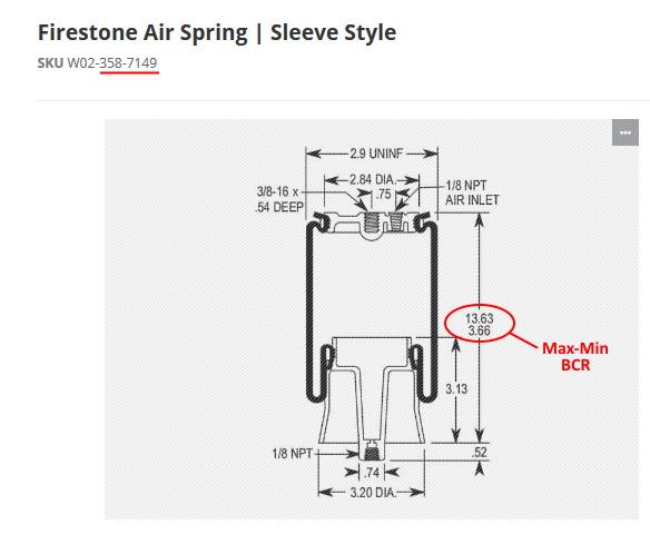

Derek up North Posted April 29, 2020 Author Posted April 29, 2020 Information on the air springs used by 3-T. Someone just ordered and received a kit from 3-T (April, 2020) and in the box was:- Quote
