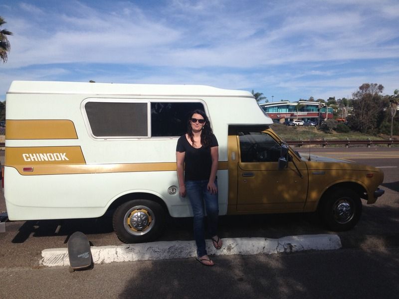

Here's a pic of my truck. You can see it sits up nice and high. There's a Scat around that is a similar size but it has the dual back wheels and the back end sags really bad still. It's around the same age but just in way worse shape.
