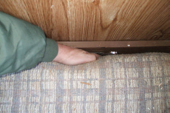

On the left side, get a flashlight and look down between the cushion and the frame, you should see a couple bolts that go into the cabinet. Remove the drawers from the cabinet and look up inside, and you'll see the nuts for these bolts.
Remove the nuts washers, then slide the bolts out (There were four on the left side, I only put two back)
There were no bolts on the right side, the couch frame just rests on the wood structure, nothing holding it down on the right.
post-4544-027464300 1295838842_thumb.jpgpost-4544-064234900 1295838875_thumb.jpgpost-4544-035688000 1295838890_thumb.jpgpost-4544-032100500 1295838918_thumb.jpg

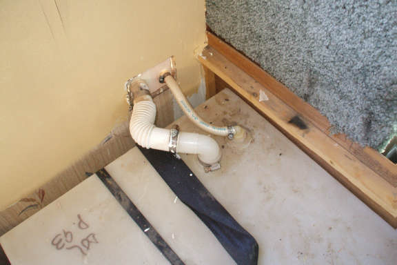

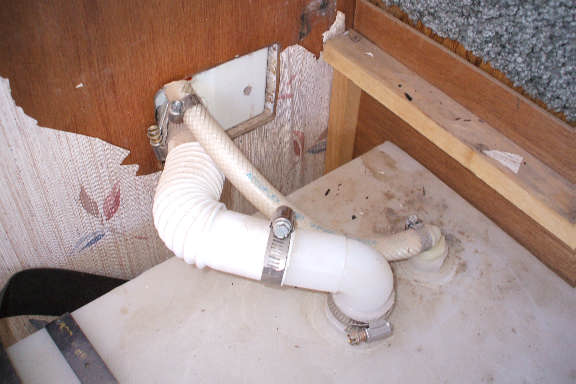

While cleaning and vacuuming, I noticed the vent line for the water tank was broke, so I repaired it while I had the sofa out
post-4544-051216300 1295839020_thumb.jpgpost-4544-064683900 1295839035_thumb.jpg

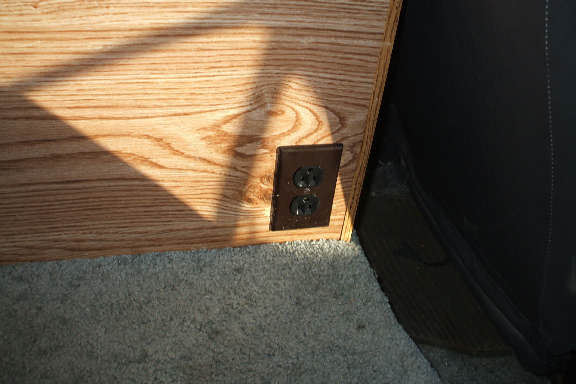

Also, While the sofa was out, I added a 120 Vac plug at the forward lower section of the sofa. Now I can plug stuff in from the drivers seat.
