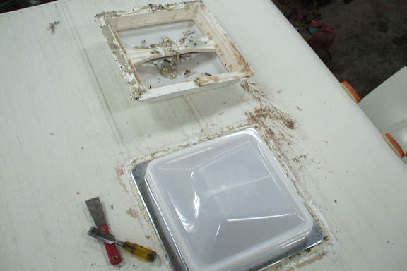

1) Right after I bought the MH, I did a quick and dirty patch around the vents and seams. This is the stuff that Deans RV recommended. I painted this stuff around all the vents and outer seams just to last me until I had the time and a place to work on the roof.
2) Even though I did a good job on the temporary patching, I still had a very slight drip. Only after watching carefully did I discover the water was sneaking past cracks in the plastic flanges. If you doing a roof patch, and you have plastic flanges, make sure you look at them for cracks.
3) I used a putty knife to expose the screws.
4) After the screws were removed, the old vent pried out. I cleaned the original sealant off with the knife, then used Lacquer thinner to remove the sealant from around the opening.

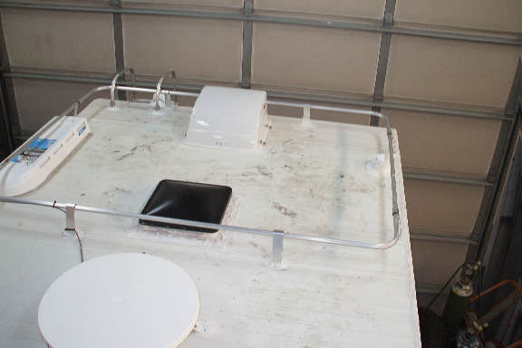

5) I laid down a 1inch wide butyl tape making sure it covered the old original holes. I then screwed the new vents on. I used #10 Self Piercing 1 inch hex head screws.
6) After I snugged all the screws, I used the putty knife to cut off the excess.
Note - The four old corner holes are not being covered by the new vent. I put a small amount of sealant on a screw and just put a new screw in the old corner holes, just to cover the holes.

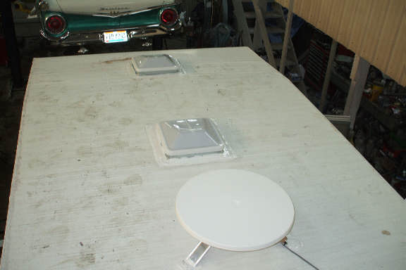

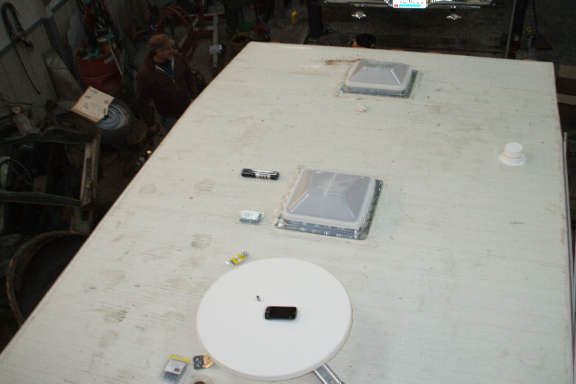

7) Two new vents and a TV antenna (NOTE - The sewer vent is just sitting there, that's not really the sewer vent location)

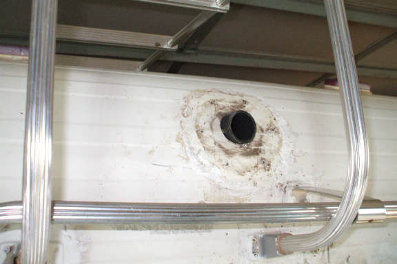

8) The far aft sewer vent was non-existent, this is removed and cleaned up.
Because the sewer vent is trying to mount on a curved surface, I had to double up the butyl tape on the very bottom and very top to fill in the gap. This area will be painted with the white sealant when I do the rest of the vents.

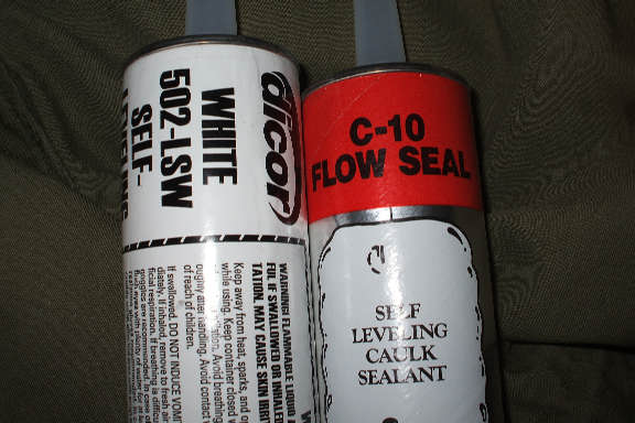

NOT SHOWN YET - I'll use the white self leveling sealant and a small paint brush, and paint the white sealant over the flanges and screws. I'll get a photo of this tomorrow when I finish.

Finished on the roof. All the vents replace. Installed a TV antenna, replaced both sewer vents. replaced the screws holding down the rack and resealed.
20) A finished roof vent, sealed, and good for another 10 years
21) View AFT.

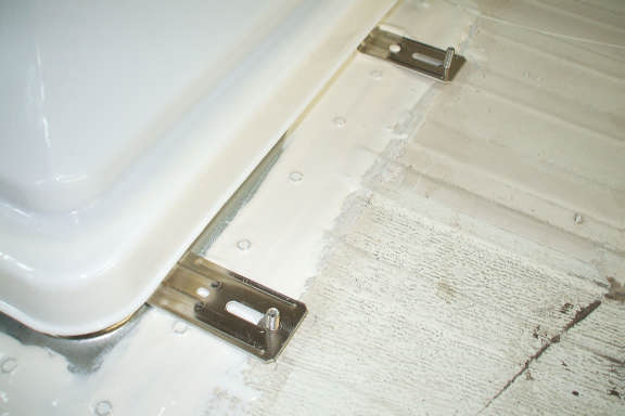

22 ) View forward
23) Note the vent cover mount plates (The vent cover does NOT mount to the roof directly, but mounts to the flanges that are installed to the vent frame.
