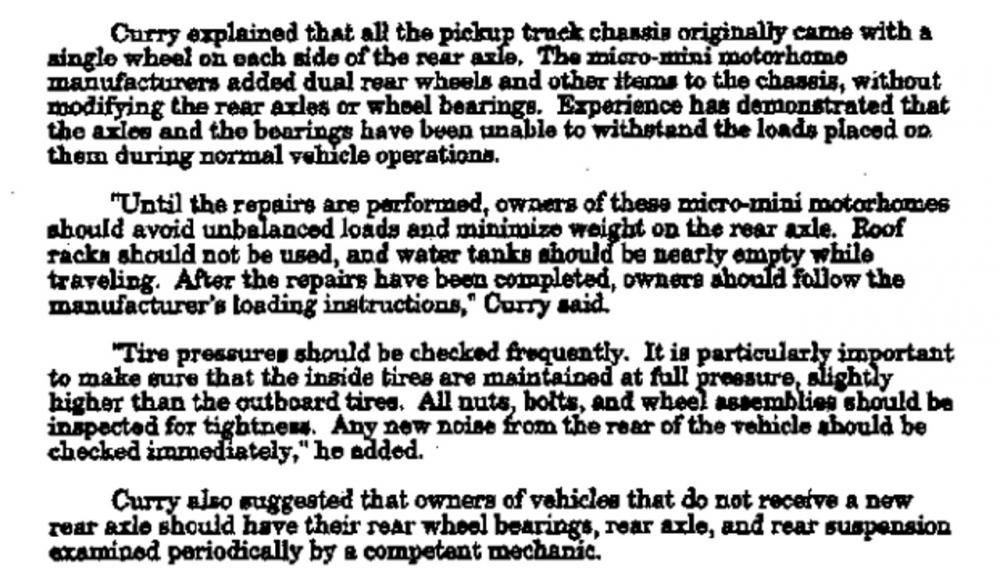

I see you've discovered you still have a 5 lug/stud rear axle installed. Many Canadian Toyotas have been missed by the Recall which was US initiated and AFAIK never followed by Transport Canada.
If you haven't already read the actual Recall, I'll attach a copy and also a short excerpt.
I'd certainly get the rear bearings replaced and ask the mechanic to very carefully inspect the axle for any signs of cracking caused by metal fatigue.
Options? Follow the Recall recommendations or just run a single rear wheel. Assuming you bought 185R14 Load Range D tires, they're rated for 1875lb, so you're probably comfortably under that. The chances of finding a 6 lug axle and wheels in Canada are slim to none.
