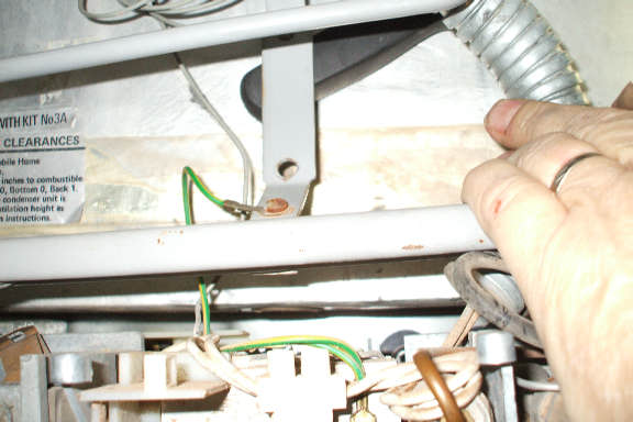

2) I pulled the tubes away from the frig so I could get my fingers and needle nose pliers in there to pull the retaining clip. You can see I jammed a screwdriver handle between the frig and the tubes to hold them out.

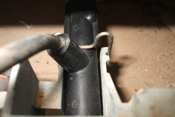

3) Very nice closeup of the igniter and the retaining clip. Pull the clip with a pair of needle nose.

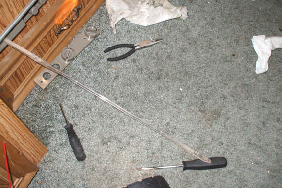

BIG BONUS - I was trying to figure out how the little periscope thing worked, well guess what. With the front panel screws out, I could get the periscope thing out and clean it. (No need to take the door off, the front panel will flex enough to get the periscope in and out.
7) Its a long plastic piece that needs to be clean in the ends.
When I put everything back together, I was able to start the frig and I could see the flame in the periscope pretty good.:ThumbUp:

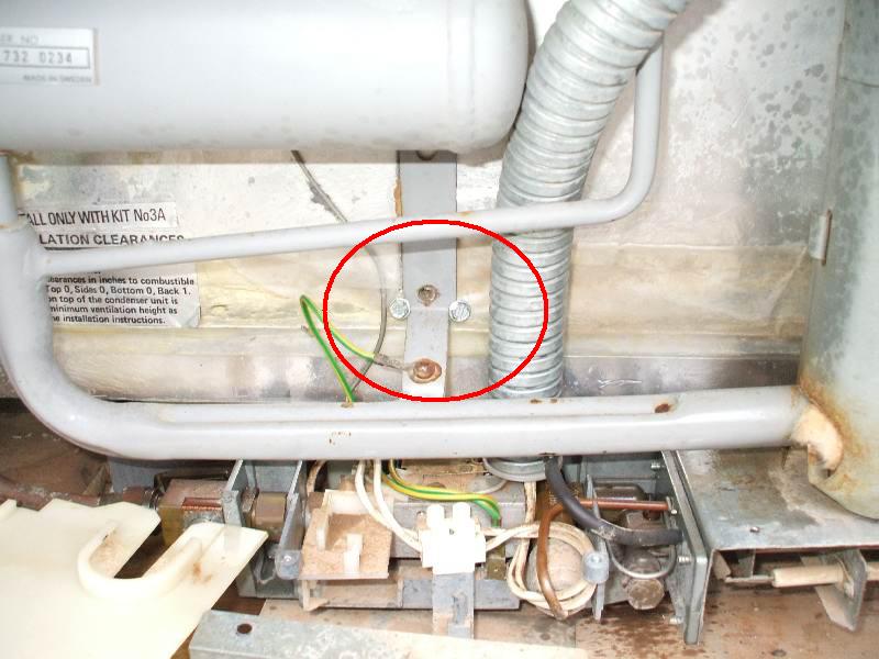

While watching from the outside, I noticed that when she hit the clicker, the whole coil unit would move back about 1/4 inch. I don't think it should do that (scratching head) :thumbdown:
I looked carefully and noticed a screw had the head broken off that holds the coil assembly to the back of the frig.
post-4544-0-99459800-1308922396_thumb.jp
I ran two screws beside the bracket to hold the coil unit, had the wife try again and BLAM she got the distinct CLICK. and the coil didn't move.
If you have this problem you may want to look and see if this has happen to you.
