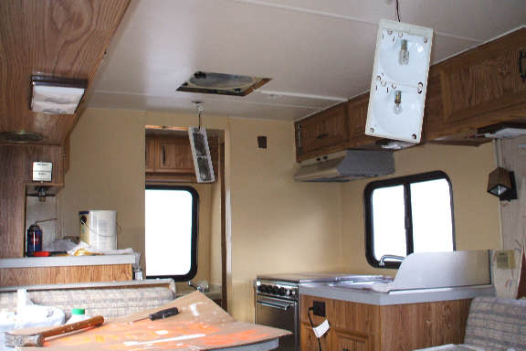

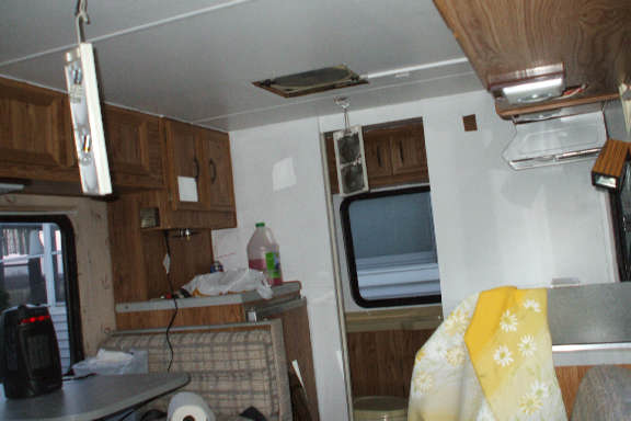

waiter Posted January 2, 2011 Author Posted January 2, 2011 A couple pictures: 1) The primer covers the wallpaper, ceiling, and the areas were the wallpaper was pulled off. Remove any wallpaper that is not sticking. 2) I'll use a razor knife and cut off the vinyl trim, then re-trim with a bead of dark brown or white caulk. 3) looking rearward, ceiling, bath area, and most of kitchen are primed, (also pocket door and bath closet door. Did not do closet or shower. John Mc 88 Dolphin 4 Auto Quote
Derek up North Posted January 2, 2011 Posted January 2, 2011 Is there not going to be a difference in texture on the walls where the wallpaper has and hasn't been pulled off? Quote
waiter Posted January 2, 2011 Author Posted January 2, 2011 The Zinsser 1-2-3 seems to level a little, The big concern was the transition line between wallpaper and no paper, None problem. I'll keep you posted, we'll probably paint the bath today. John Mc 88 Dolphin 4 Auto Quote

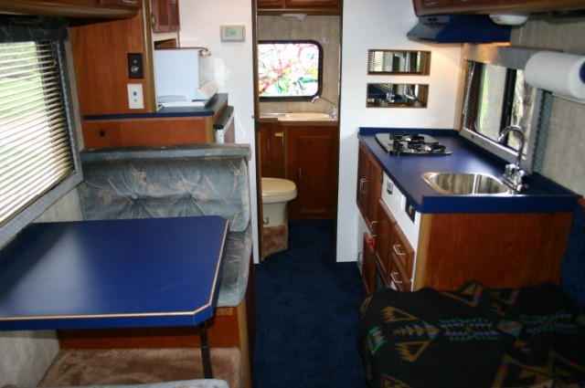

waiter Posted January 2, 2011 Author Posted January 2, 2011 Finished painting the ceiling bath and kitchen area. (Still need to do the trim caulking) Looks very good We used Satin for the ceiling and semi-gloss for the walls. A good quality paint (Lowes Valspar) and a texture roller. The texture came out nice and did a good job of hiding the wallpaper and transition bumps. On a scale of 1 - 10 : Before = 3, After = 8 After we finished, I would consider possible using a light gray for the walls, might match the counter tops carpet, etc. I still need to do above the couch, table and the cabover. JOhn Mc 88 Dolphin 4 Auto Quote

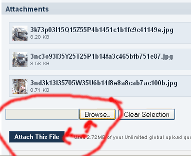

waiter Posted January 10, 2011 Author Posted January 10, 2011 This forum limits the size of your JPG. You need to shrink / compress it. The JPGs I attach are around 30k each. The originals are 2 meg and are WAY TO BIG to be uploaded. I use a program called "Advanced JPG Compressor" to take those large, high resolution, megabyte size files, and shrink/compress them down to a small size that is easily displayed on we browsers. This is the key - If you want a high resolution version of any of my photographs, let me know and I'll e-mail it to you, Advanced JPG Compressor is a for sale program, but I'm sure there may be programs out there that do basically the same thing for free. Quote
Derek up North Posted January 10, 2011 Posted January 10, 2011 I never bother trying to upload large files. I'm on sloooow dial-up!! I've loaded the 4 photos Bajadulce can't see (Bad Boy) into Photobucket. Plus a 5th, just for fun! http://s224.photobucket.com/albums/dd196/DerexPix/Toyota%20MH%20Remodels/ Quote
bajadulce Posted January 11, 2011 Posted January 11, 2011 Nice I approve of the wood burning stove! Who cares how much it weighs. I'd hang out in that camper for sure! What's that little blue mini camper? Interesting. As for uploading pics, there are a lot of image uploading sites such as imageshak that are free to upload. Photobucket works great as well. Whats nice about those sites is, as waiter describes, they usually compress your images as well. Waiting for huge resolution pics to display on screen can be really frustrating AND is quite taxing to the forums storage when those are "uploads". The eye can't tell that much difference between compressed images anyway. A 1600x1600 picture of a bolt doesn't make any sense. Usually there are "tags" with images when you upload them to image sites. You can use those tags to display on the forum using the img bbcode [*img]link[*/img] *without asterisks Like the image of the wood burning stove: I've never used photobucket, but I see an "img" code window on the site you linked to (right side) you just click on the window and it automatically copies the code to your clipboard which is a nice feature. Then just paste in the browser here: code for pic above looks like: [*img]http://i224.photobucket.com/albums/dd196/DerexPix/Toyota%20MH%20Remodels/Woodstove.jpg[*/img] Quote
