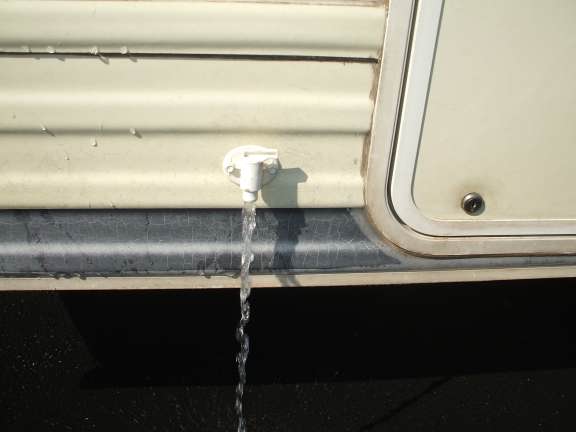

1) Drain fresh water tank - From the outside - Open the drain on the fresh water tank (just forward of the generator compartment), remove the city water cap. Leave open for now.

2) Drain water heater - NOTE - If the water heater has been bypassed and properly winterized, this step isn't necessary.
From the outside - Open the drain on the Hot water tank (can be seen behind the gas valve, Open the expansion valve on the hot water tank. Leave open for now.
