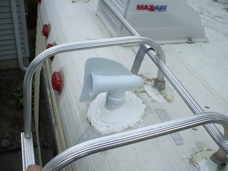

On our recent Alaska trip, we occasionally got a foul odor inside the Toyhouse while driving, and sometimes at night when parked, a very slight whiff.
The odor seemed strongest when we were traveling down the road with the drivers or passenger window open. I suspect that when the windows are open, they create a slight negative pressure inside the truck and the odor then gets drawn in from the black tank.
post-4544-0-23783800-1308398444_thumb.jp The Black tank stack pipe (roof vent) is mounted at a slight backward angle. When traveling down the road, the angle of the vent may act as a scoop and actually pressurize the tank. With the tank at a slight positive pressure, and the truck at a slight negative pressure, air flows from the tank, into the truck, and WHEW. :help:
I found a vent made by Camco, it has a venturi effect and can suck the air out of the tank while traveling. When we're parked, the vent can weather-vane and turn in the wind, and still suck air out of the tank.

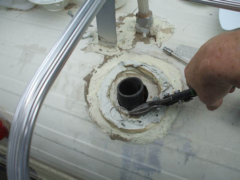

First was to remove the old vent, and clean up the surrounding area.
Then I used tin snips to open the hole around the existing vent pipe, so the weather-vane would slide all the way down on the vent pipe.

I then sit back and watch in awe as the weathervane rotates with the wind, and breath fresh air as I'm cruising down the highway with the windows open. :ThumbUp::ThumbUp:
