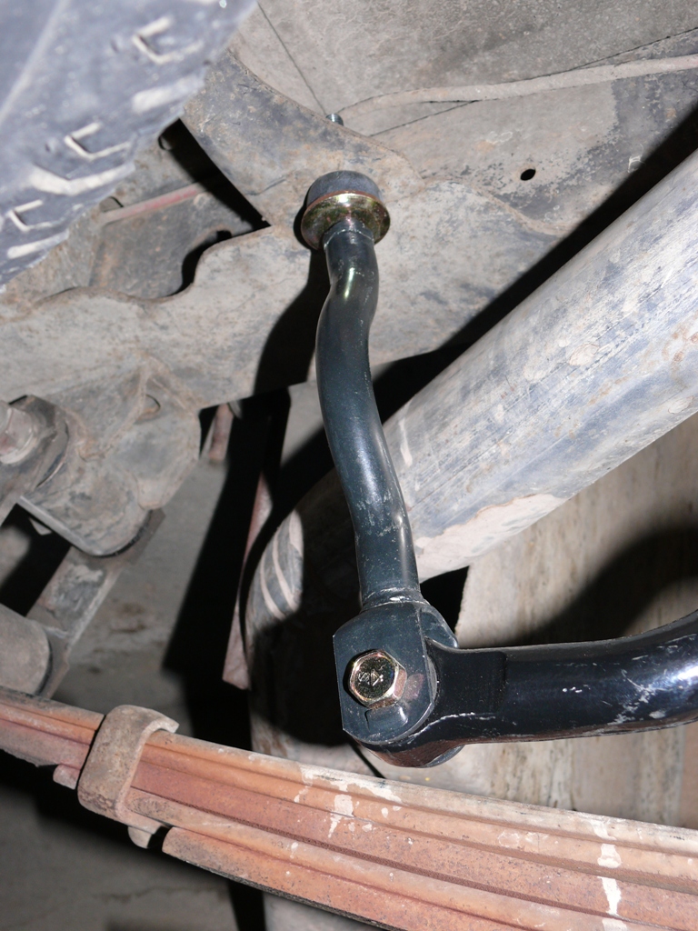

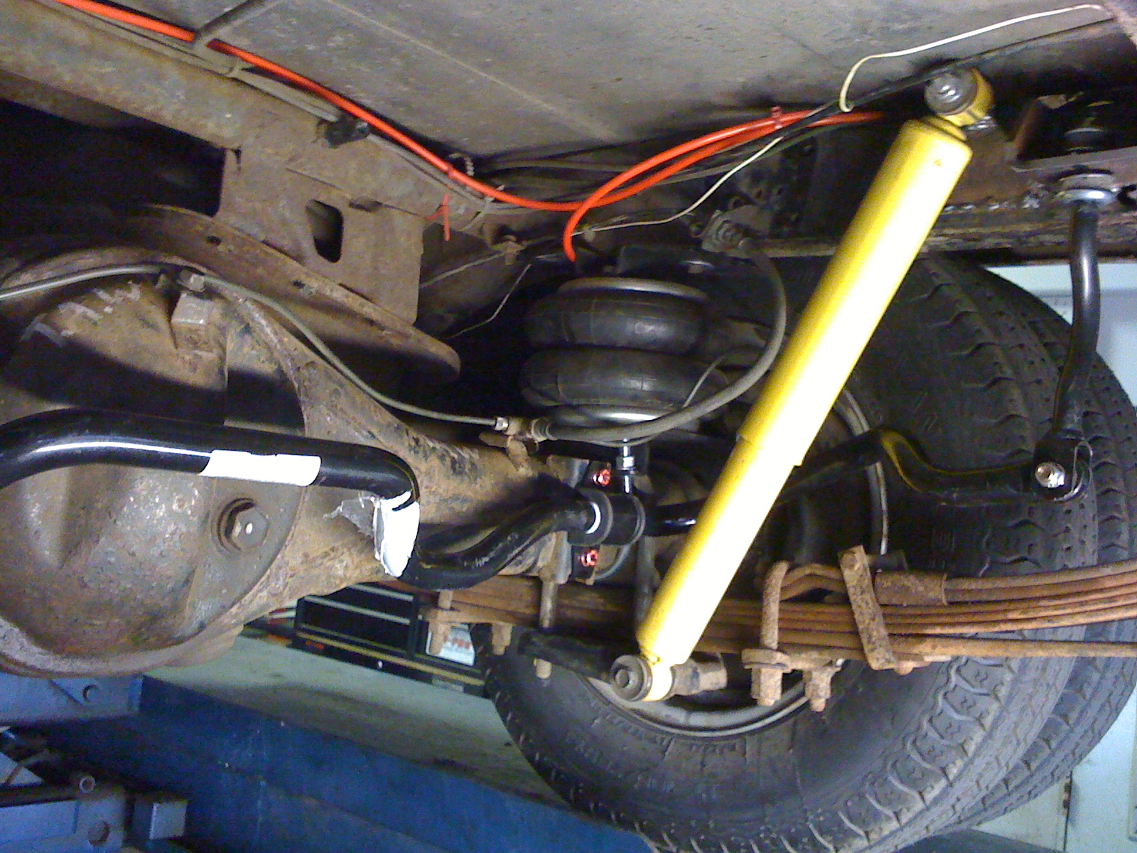

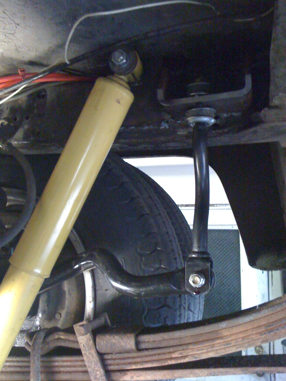

The sway bar is installed! I received all the factory Toyota parts except some bolts and the mounts on the chassis. I had to weld a steel plate for a new shock mount and make some brackets made out of 4"x4" steel tubing for the sway bar arms. I think the angles and dimensions are right, it just looks a bit more frankenstein than factory. Here are some pics of the completed install. So far the suspension upgrades are: salvaged 1-ton axle, new shocks, new steering stabilizer, rite-rite airbags, 6 yokohama tires, and the sway bar. I hope not to be under the rig for a while.

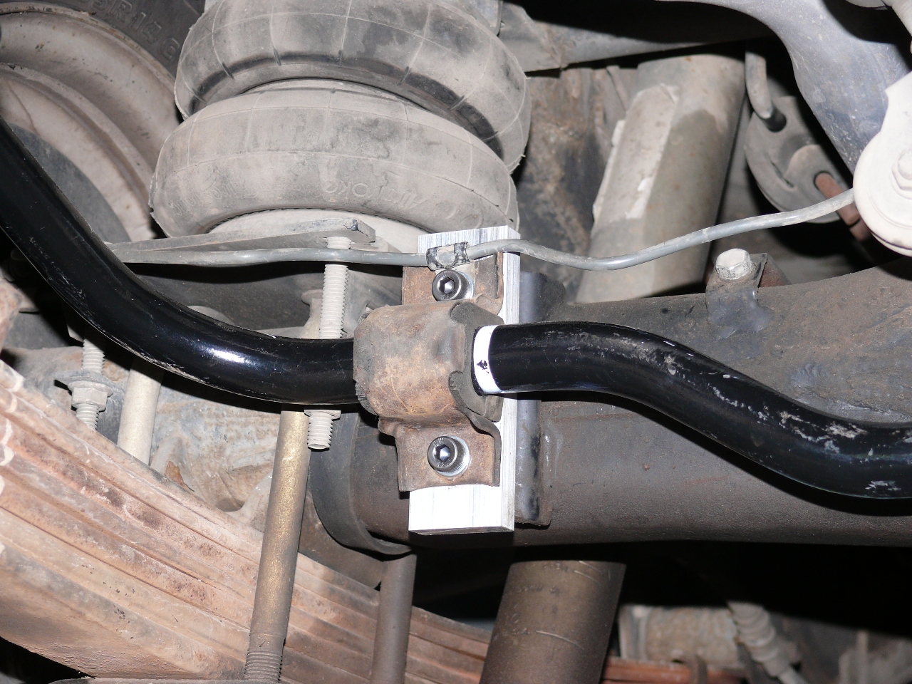

I looked under our rig this past weekend. It appears that I will have to put spacers under the sway bar mounts, so not to interfere with the ride-rite hardware. Instead of "U" bolts that go around the axle, there are "U" brackets and screws that hold the ride-rites. This bracket will interfere with the sway bar, unless maybe a 1/2" spacer is install underneath the sway bar mounts.
In addition, it appears that the end-links can be mounted to where the spare tire cross member is welded to the frame. I believe that it is just a matter of drilling a couple of holes through them.

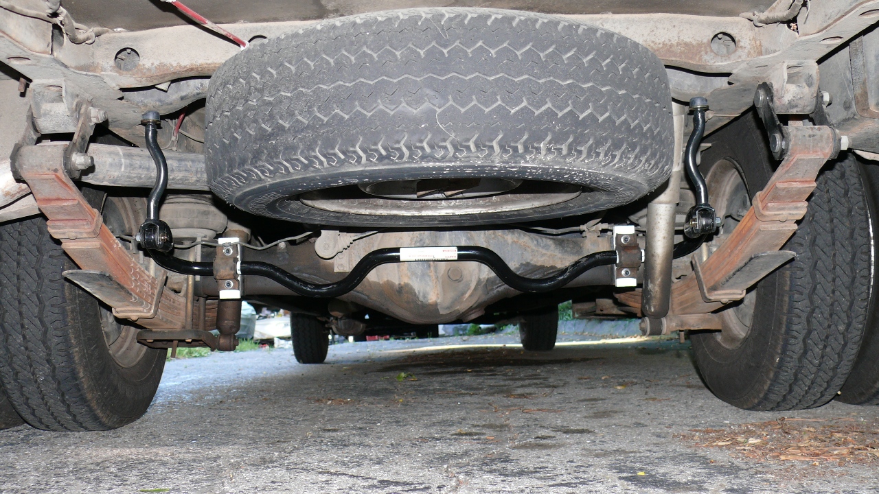

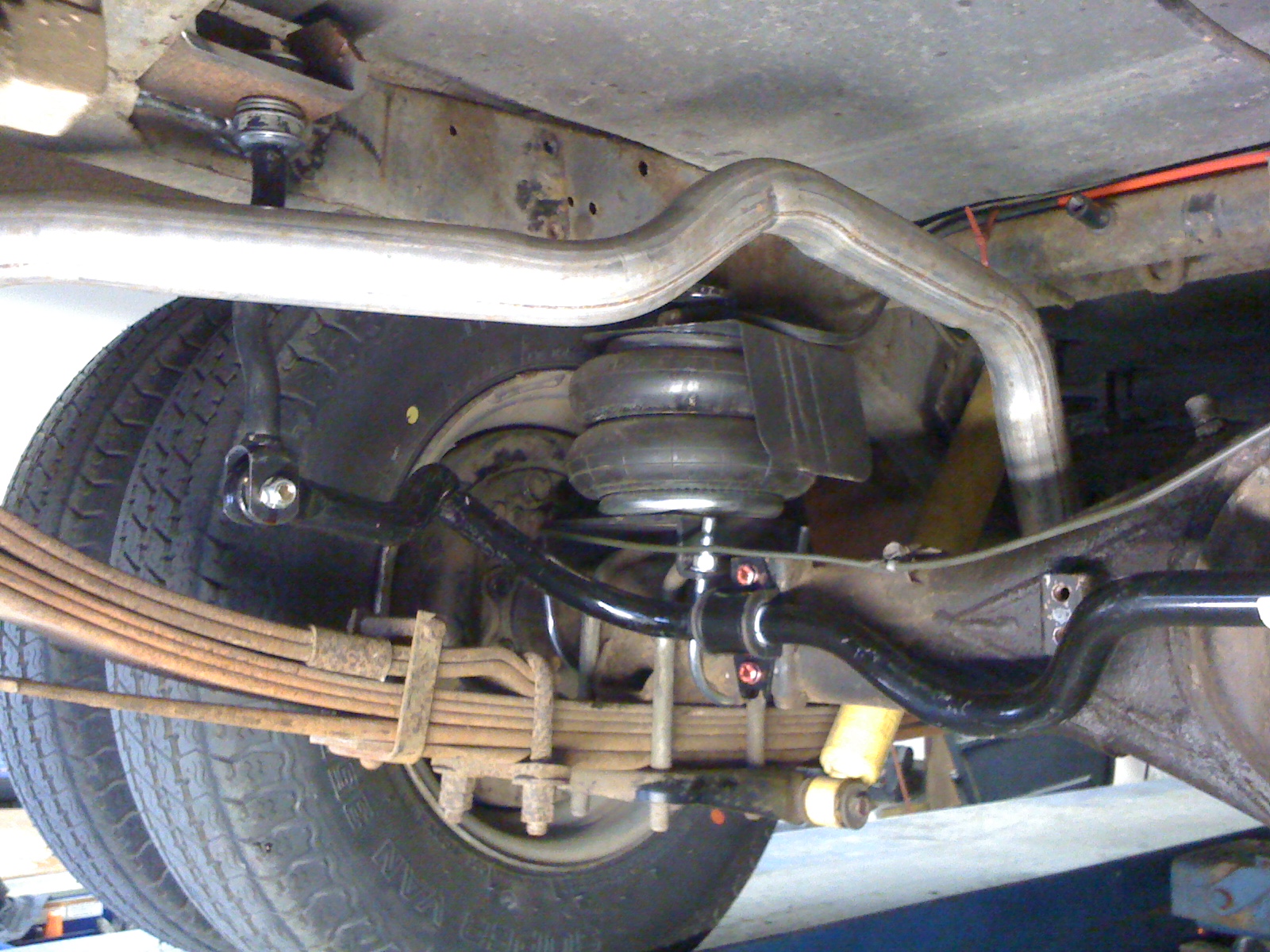

Attached are pictures of the rear swaybar installation on our 85 Sunrader.  Below are some comments that goes along with the pictures regarding the installation.  Note: This frame is slightly different than Kirby's 84 Sunrader (1 model year different).
1) Picture 1: Only had to drill a 5/8" hole in the front support cross-member for the spare tire on both sides.  Note: I used some polyurethane bushings and heavy duty Energy Suspense bushing washers instead of what came with the end-link set from Toyota, I felt the rubber bushing that Toyota supplied were too compliant.
2) Picture 2: Put a 1/2" aluminum spacer under the sway bar frame bushing support bracket.  This is to allow clearance with the Ride-Rite air spring hardware.  Note: Since Toyota did not have either the bracket or bushing available (when I ordered the bar), I used the brackets and bushings from my 65 Oldsmobile Starfire (previously upgraded to polyurethane).
3) Picture 3: An overall picture of the rear swaybar installation.  Note: This picture also show what happens when one fills the transmission (automatic) to the top of the cold indicator on the dip stick (when cold, after idling for a couple of minutes), it overfills the transmission when hot and it leaks out.  The next time I check it, it will be only to the bottom of the cold indicator (if cold) or hot (within the hot levels)!
