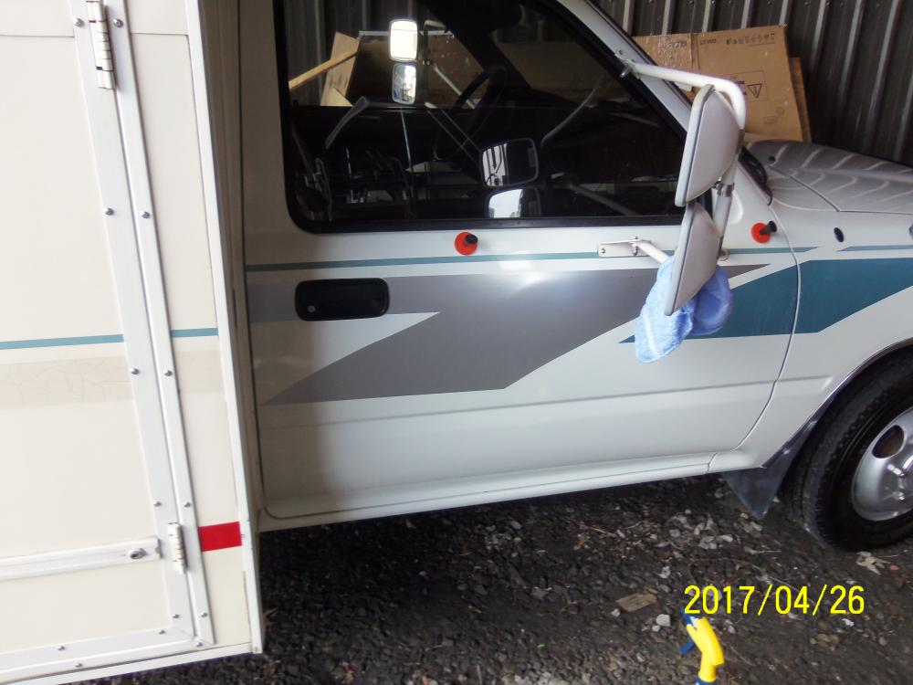

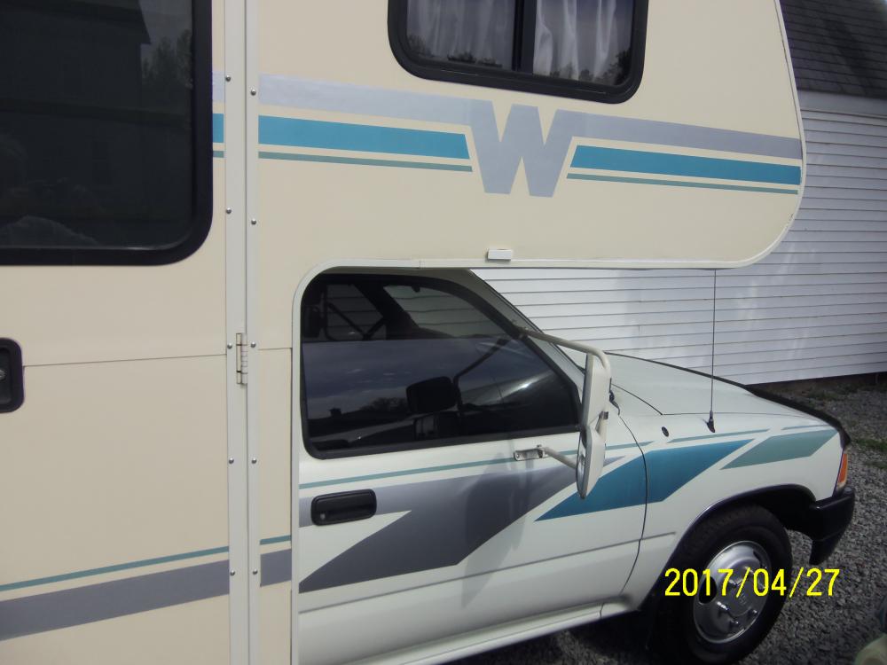

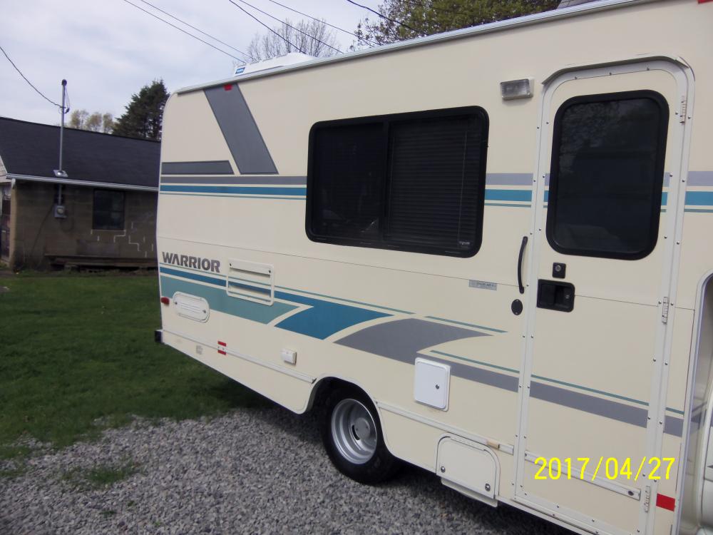

hunkaman Posted May 1, 2017 Posted May 1, 2017 After many hours removing the failed graphics, i now have replaced with new. i made full scale templates of the curved pieces, and the "W" and the "Winnebago". the local shop then scanned my templates to cut the cast vinyl replacements. i have chosen a few before & after photos. joe from dover. Quote

hunkaman Posted May 3, 2017 Author Posted May 3, 2017 thank you all for the positive feedback. to --RedEmerald.-- after old was removed -just washed area with water. before new applied, wiped with dry cloth to remove dust, dirt etc. that was it. did not go over the old, they were removed. thanks again to all. joe from dover. Quote

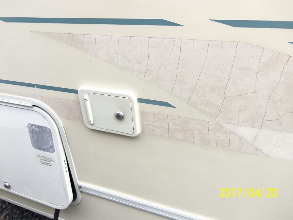

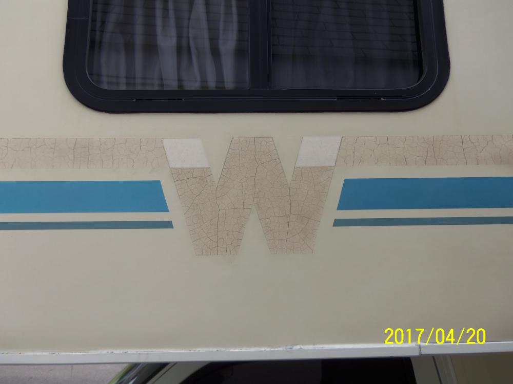

Derek up North Posted June 8, 2017 Posted June 8, 2017 Funny/strange how the different coloured stripes have 'suffered' so differently. This is not the first time I've seen this with Winnebagos. Quote
hunkaman Posted June 8, 2017 Author Posted June 8, 2017 DEREK-- my question exactly. i only removed the "cracked" or "failed" graphics. on my rig. i have a color sales brochure in my packet of original paper work, which shows that the only color that failed was the magenta or purpleish -red color. the other two graphic colors(light blue and light green) were obviously faded with age, but were not cracked at all, not peeling, etc. . i have asked a couple automotive paint pro's--the consensus is the darker color absorbed more sunlight, therefore, became hotter and stress cracks are the result. i am still scratching my head a little, but other than inferior material as compared to the other colors, it makes sense. Quote

Derek up North Posted June 8, 2017 Posted June 8, 2017 19 minutes ago, hunkaman said: DEREK-- my question exactly. i only removed the "cracked" or "failed" graphics. on my rig. i have a color sales brochure in my packet of original paper work, which shows that the only color that failed was the magenta or purpleish -red color. the other two graphic colors(light blue and light green) were obviously faded with age, but were not cracked at all, not peeling, etc. . i have asked a couple automotive paint pro's--the consensus is the darker color absorbed more sunlight, therefore, became hotter and stress cracks are the result. i am still scratching my head a little, but other than inferior material as compared to the other colors, it makes sense. Reds are always 'difficult' and more prone to fading. But in this case it's almost as though the red stripes were made from a different material, the way it's all cracked. Quote
