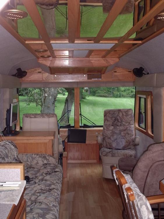

jjrbus Posted February 26, 2017 Posted February 26, 2017 I am a bit old now and my get up and go got up and went, if I were 10 years younger and had more space I would rebuild it, with some improvements. I have converted a bus to a motorhome and it is very time consuming and expensive. Those multiple trips to the big box stores for misc add up quickly, then the ideas that don't work and have to be ripped out. Good luck Quote

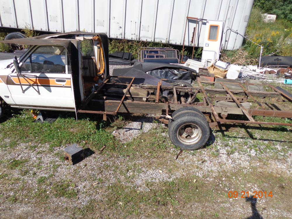

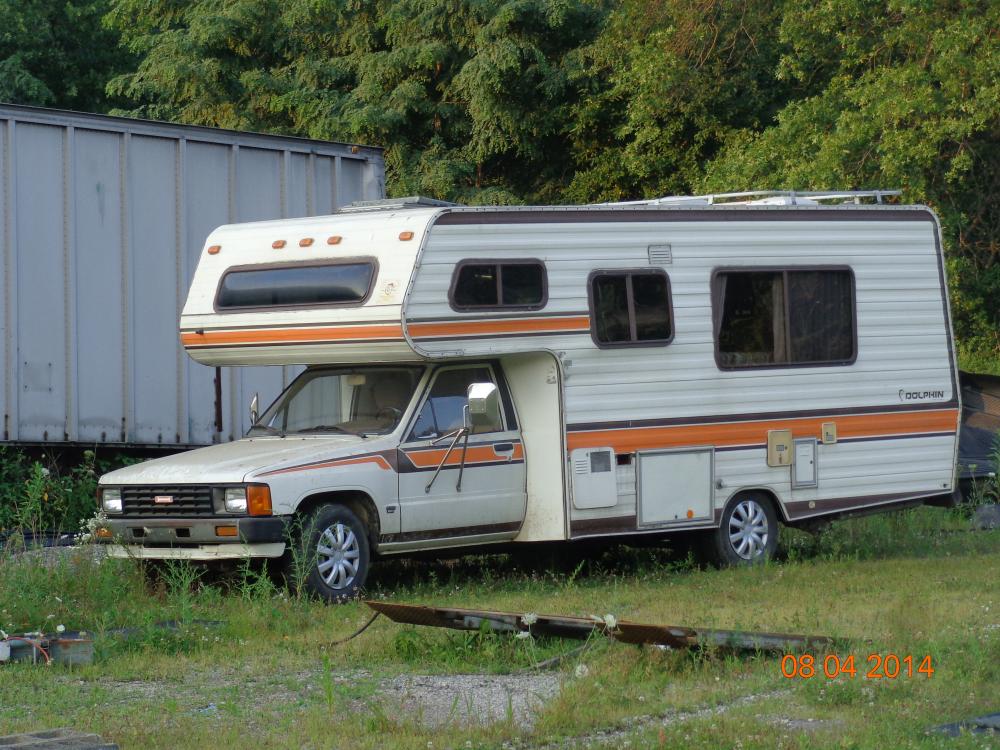

wonderabout Posted February 26, 2017 Posted February 26, 2017 Converting to a flat bed may be as simple as going to your local title office and have the name changed, this is done often in the VW world when a beatle is made into a dune buggy. I was going to make a flat bed work truck out of this 85 dolphin, but it is VERY slowly becoming a flat bed toy hauler, but that's a story for another thread when I have more computer time. Quote
redskinman Posted February 26, 2017 Posted February 26, 2017 19 minutes ago, wonderabout said: Converting to a flat bed may be as simple as going to your local title office and have the name changed, this is done often in the VW world when a beatle is made into a dune buggy. I was going to make a flat bed work truck out of this 85 dolphin, but it is VERY slowly becoming a flat bed toy hauler, but that's a story for another thread when I have more computer time. This build I wanna see! Good luck! Quote

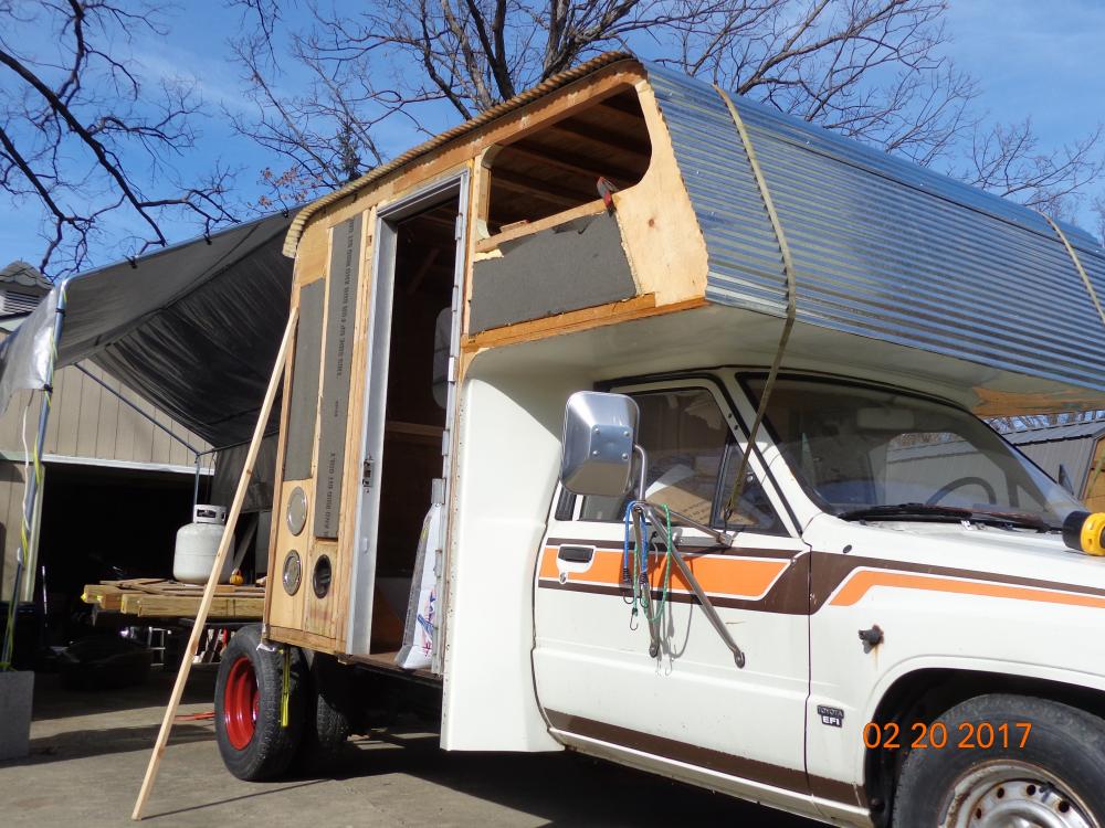

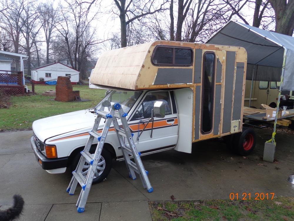

freebear13 Posted March 26, 2017 Posted March 26, 2017 I had just enough energy and focus to rebuild mine. One whole side from frame up. Scope out the pics...now I have to get another bit of time, energy, AND FOCUS to do the interior. Quote
