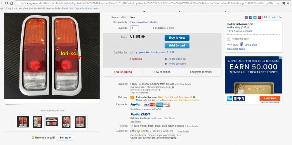

The complete rear light assemblies are available brand new. I bought two pairs and seem to be good quality.  So Chinese or Taiwan brand that is often on Ebay.

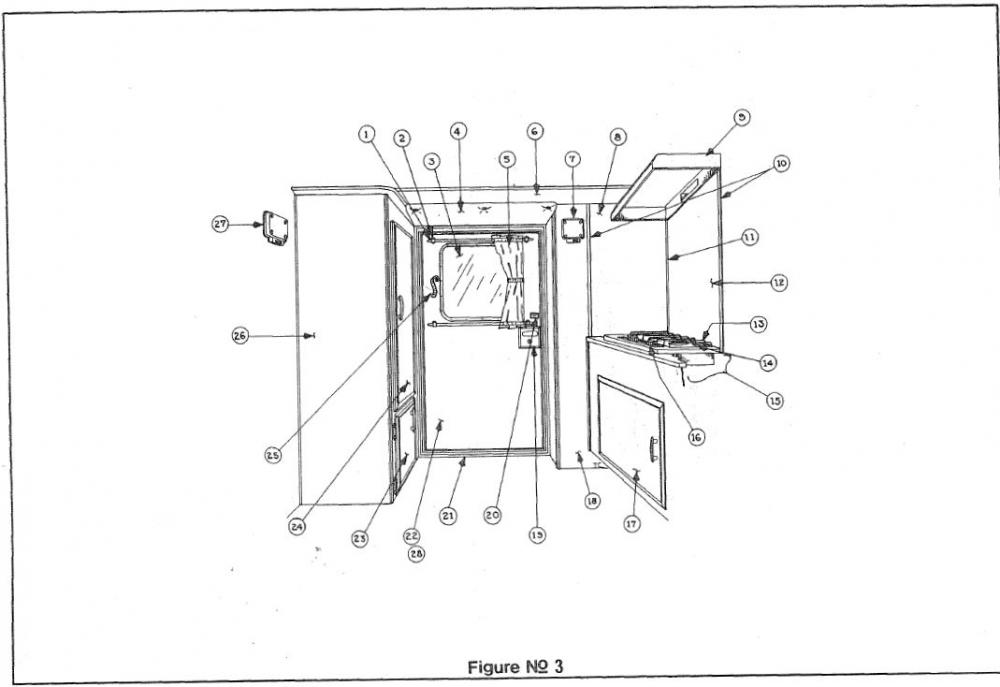

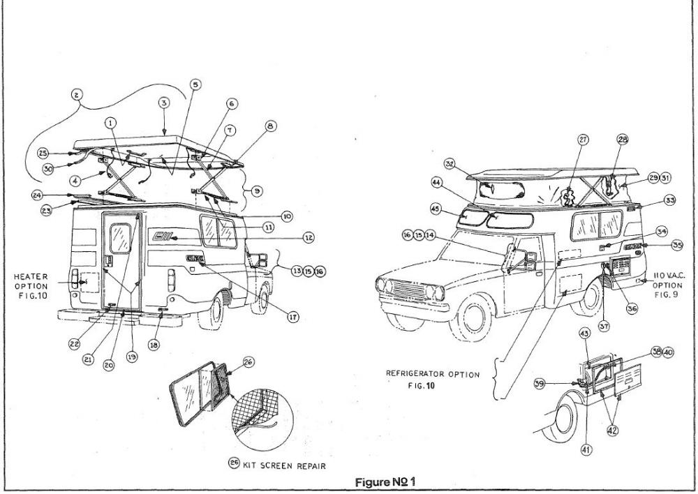

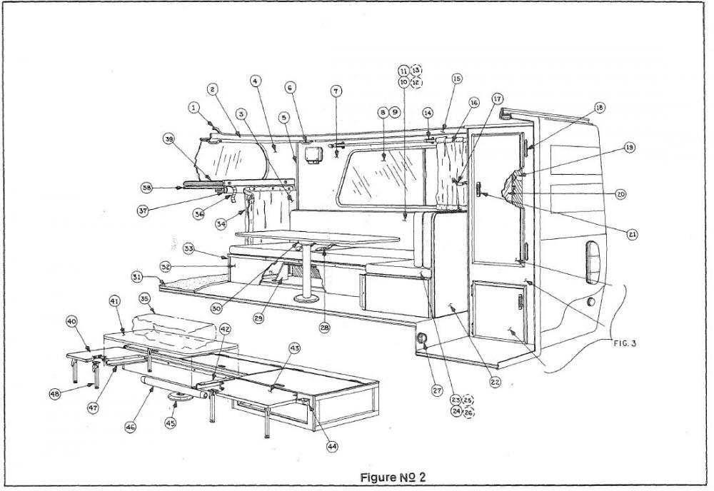

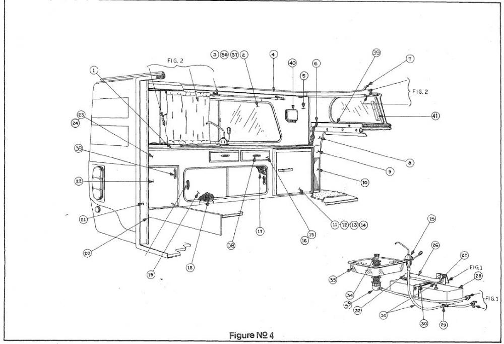

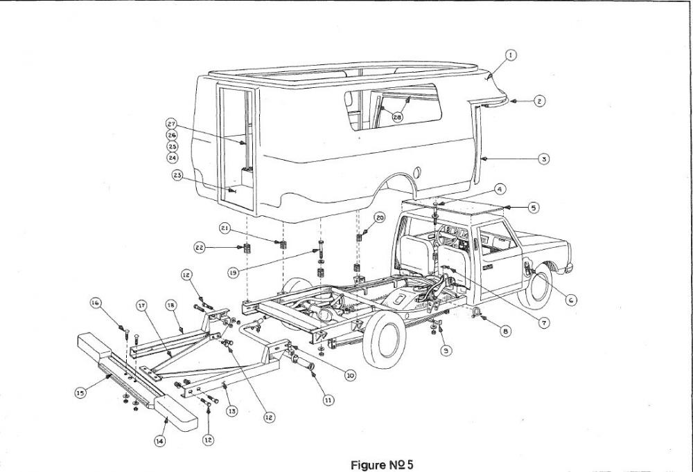

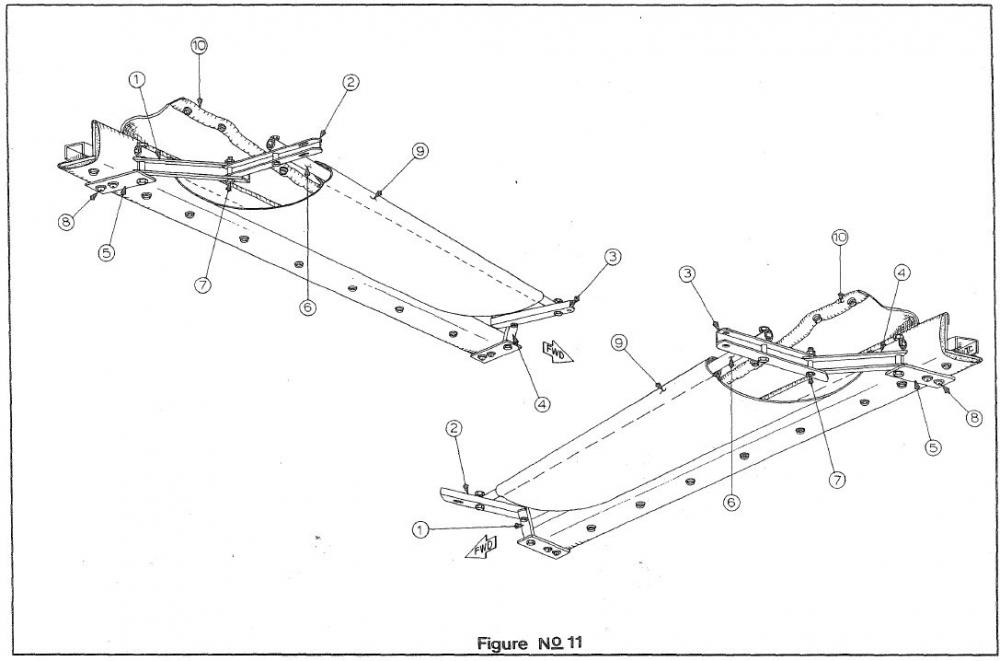

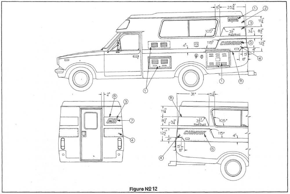

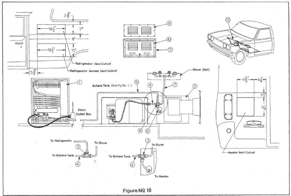

Chinook never sold those parts.  Not according to their parts book.
