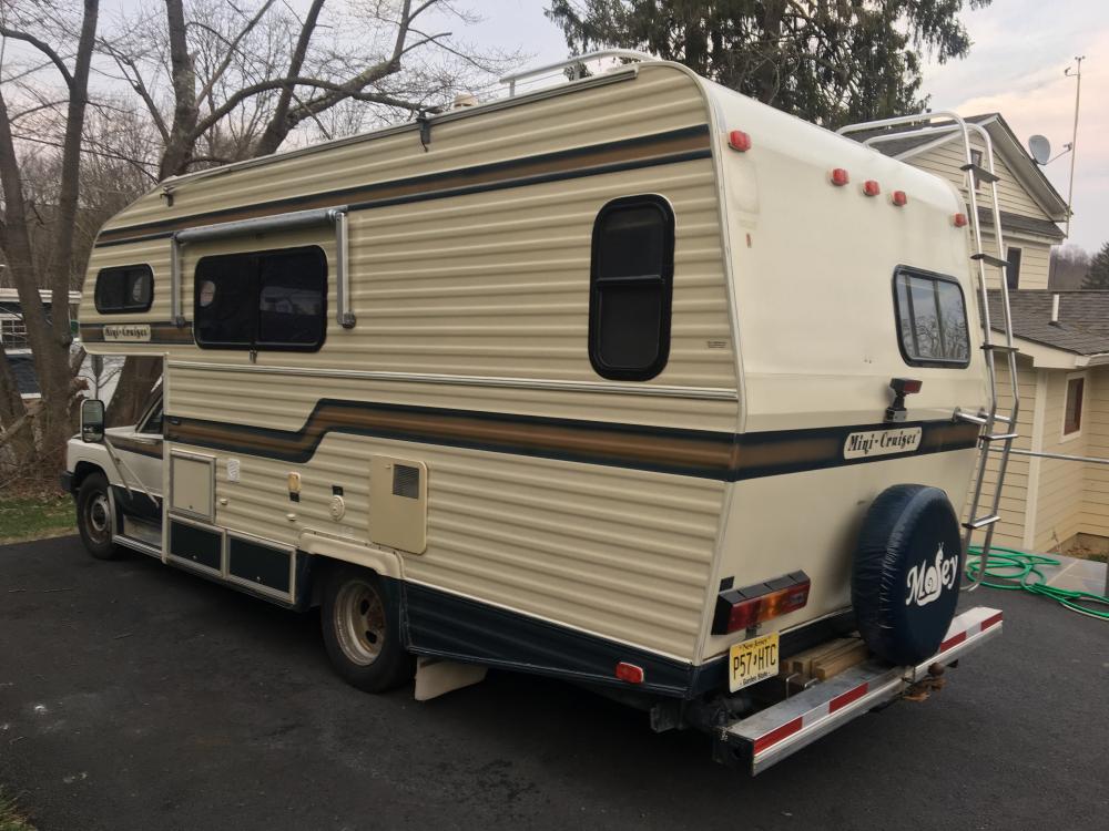

KonCon Posted February 6, 2022 Posted February 6, 2022 Thought I just post here instead of opening a new thread. I cleaned my rig today with BKF. Much more exhausting than I thought but it's so satisfying seeing the dirt come off. Even after using BKF, the surface still looks a little flaky, especially on one side. What is it and does this need to come off before I do the 5 layers of zep? Weather is supposed to be nice next week here so I plan on applying the multiple layers throughout the week but want to make sure the surface is ready before I start. Any concerns when you see this or is it good to go for the zep? Thanks, Nico Quote
jjrbus Posted February 7, 2022 Posted February 7, 2022 Tough from a picture, however looks like the rig might have been clear coated?? I would try stripping or sanding an inconspicuous area before doing anything else. Or you could try ZEP on an inconspicuous area and see if it camouflages what ever is there, I do doubt that will work. Quote
KonCon Posted February 7, 2022 Posted February 7, 2022 (edited) Dang, already has been a lot of work. The only good thing is it is only on one side. Should I try the zep remover? Edited February 7, 2022 by KonCon Quote
WME Posted February 7, 2022 Posted February 7, 2022 Looks like the gel coat is failing. I had to wet sand my rv with a jitter bug sander with 600 grit. You can NOT use an electric sander with water. Try wet sanding a small section by hand to see what happens Quote
jjrbus Posted February 7, 2022 Posted February 7, 2022 8 hours ago, KonCon said: Dang, already has been a lot of work. The only good thing is it is only on one side. Should I try the zep remover? I think I would drop by a body or fiberglass, maybe a boat place, and get their opinion, clear coat, failing gel coat, ZEP????? Quote
KonCon Posted February 7, 2022 Posted February 7, 2022 It might not look like this in the pictures but I'm pretty sure the shinier patches are something on the gel coat so my best guess currently is, that it is in fact remainder of the last ZEP coat. I will take a look tonight. If it ends up being something on the gel coat, I probably just buy the zep stripper and clean the side again that shows this issue. Quote
jjrbus Posted February 8, 2022 Posted February 8, 2022 The ZEP stripper works great. It needs to be mixed at the specified temperature and needs to be kept wet for 8 minutes so keep applying it. After 2 years I stripped mine and reapplied the ZEP. A bit of work but a wax job that lasts 2 years! Quote
KonCon Posted February 8, 2022 Posted February 8, 2022 Thanks, I'll try that this week and then will try to go for 5 layers of zep this weekend. Quote
ednelson100 Posted February 9, 2022 Posted February 9, 2022 Yeah ZEP is the best, mine lasted 4 years but I really should have redone it last year. If the stripper works then you can go for the 5 coats. Normally before applying ZEP for the first time you need to scrub surface with Barkeepers Helper to get a perfectly clean surface. Quote
KonCon Posted February 10, 2022 Posted February 10, 2022 On 2/6/2022 at 7:17 PM, WME said: Looks like the gel coat is failing. I had to wet sand my rv with a jitter bug sander with 600 grit. You can NOT use an electric sander with water. Try wet sanding a small section by hand to see what happens Looks like the ZEP stripper didn't do much. I probably will get a cheap jitterbug sander from harbor freight for 30 bucks and do the one side where I have the issues. Then rinse with BKF (only have the one in the bottle premixed after I used all of the powder cleaning the entire rig last weekend) and then apply 5 coats of ZEP this weekend. Anything speaking against this process? Thanks, Nico Quote
KonCon Posted February 10, 2022 Posted February 10, 2022 Unfortunately it looks like the jitterbug sanders need A LOT of air and I won't have a compressor to keep up with that. Any other ideas? Quote
WME Posted February 10, 2022 Posted February 10, 2022 Rent/borrow a bigger compressor. Before you do this get a hand sand block and wet sand a couble square feet of an side panel and see what happens. Quote
linda s Posted February 10, 2022 Posted February 10, 2022 I absolutely would not go with a high speed sander. Looks like your gel coat is already failing and it will only make it worse. Wet hand sand only to get the surface smooth and hope the shine of the zep hides some of the surface issues. 5 coats is overkill. I wouldn't do more than 2. Protect it for now and realize eventually the cure is going to be paint. My friend Roy painted his Sunrader with Rusoleum Topside, boat paint, and he says it's holding up really well Linda S Quote
KonCon Posted February 10, 2022 Posted February 10, 2022 Thanks Linda. I'll grab a hand sand block and some 500 grit sand paper tonight and hopefully i find some time tomorrow to work on it and then put on the Zep on Saturday. A lot of folks say the nice shine does not really show until the 4th layer so I still might do the overkill to get the nice look Quote
linda s Posted February 10, 2022 Posted February 10, 2022 I only did mine once and I thought it looked great with one coat. All gone now. Have too much other stuff to do Linda S Quote
KonCon Posted February 14, 2022 Posted February 14, 2022 (edited) I ended up hand sanding a few spots, then cleaning again with BKF and then I put 5 thin coats of the ZEP. Looks real nice and shiny. Still can see the difference in color a little bit but I'm quite happy. Eventually this thing probably needs a new paint job but I feel like I just bought myself a year or two time to do that. Thanks again for all the input. It was a lot of work but worth the effort. Now ready for the season. I guess beside the weird noises the car makes so I have to bring it to a shop to check.... Haha always something to do Edited February 14, 2022 by KonCon Quote
