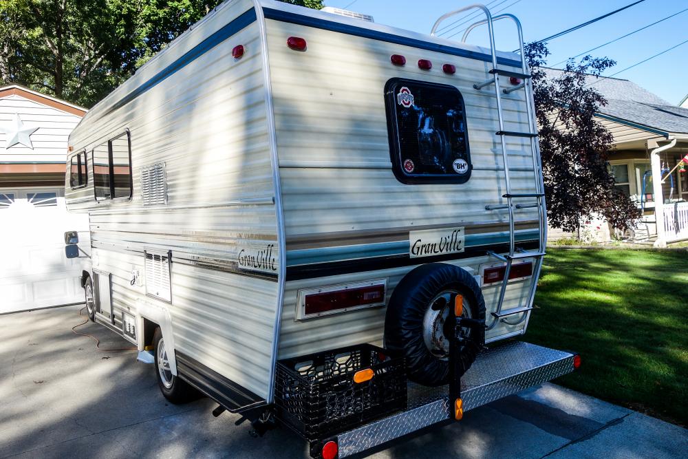

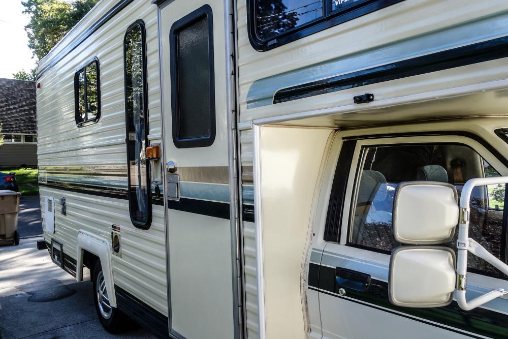

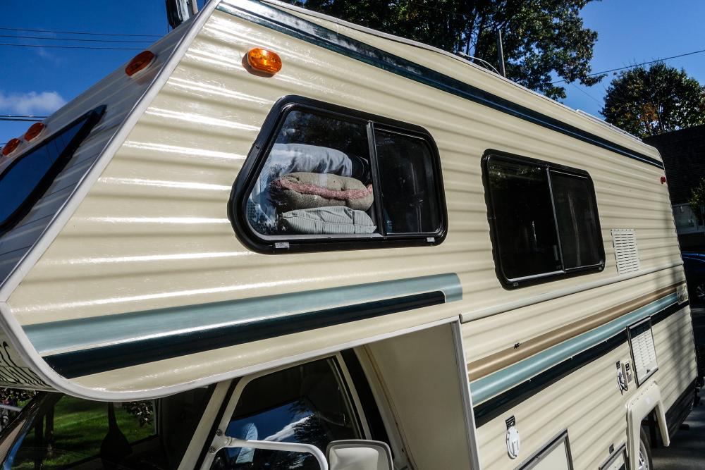

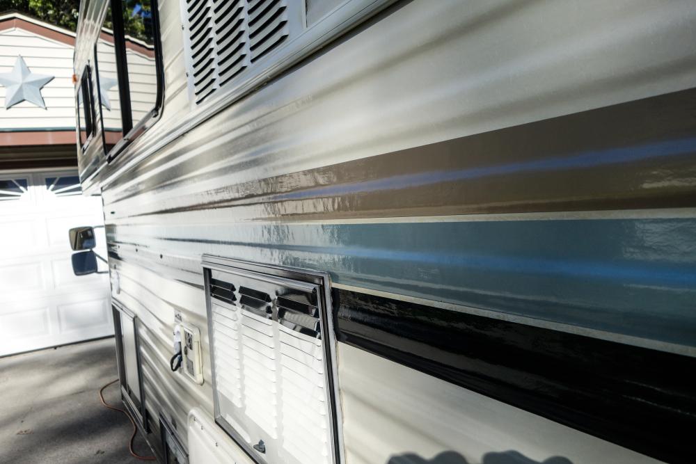

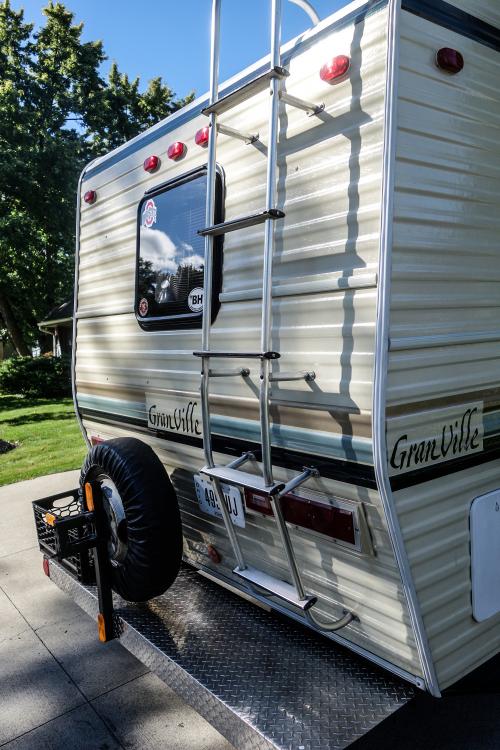

markwilliam1 Posted October 10, 2016 Posted October 10, 2016 Just wanted to show off my 85 Granville after months of restoration. The Zep floor polish was the final answer for me and I had no idea it could completely restore the faded, chalky, ugly finish on Grannie after sitting in the sun for 31 Years! What do ya'll think??  Quote
WME Posted October 10, 2016 Posted October 10, 2016 My unit is smooth sided, used 600 wet and dry to power color sand the siding (air driven power tools are wonderful) then 5 coats of Zep. Looks awesome. If some one had used Zep 15 years ago the decals would have in great shape, as it is the Zep made a big improvement in the decals. Old chalky decal need to be cleaned thoroughly or they will bleed color when you do the first couple of coats of Zep Quote

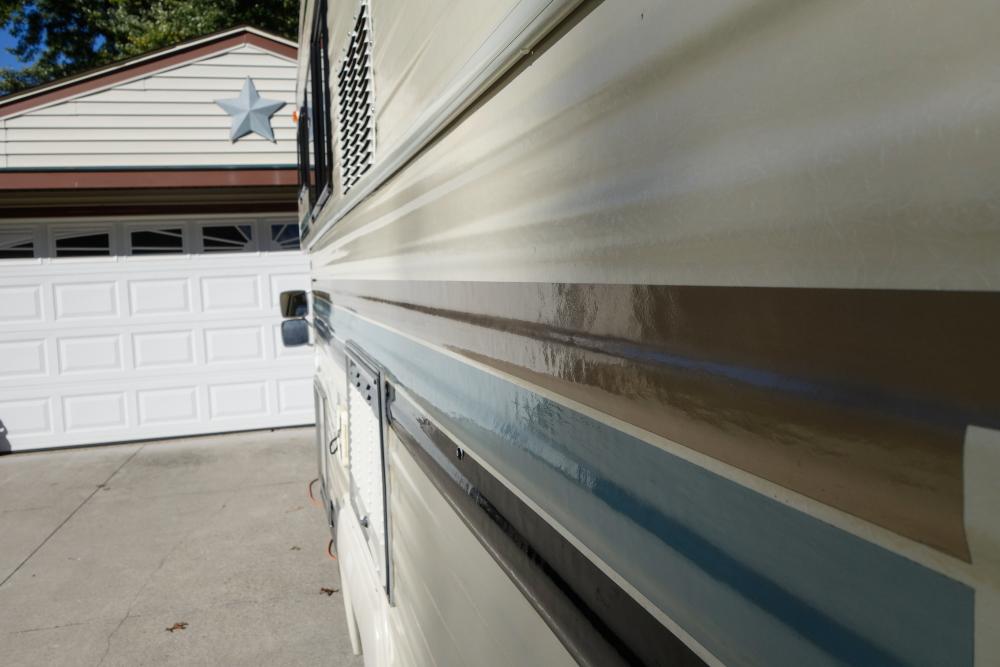

markwilliam1 Posted October 10, 2016 Author Posted October 10, 2016 My graphics were spray painted (no decals)Â on my Grannie from the factory so no cracks & no bleeding just unbelievably Restored graphics!! Quote
markwilliam1 Posted October 10, 2016 Author Posted October 10, 2016 Thanks RV! The hardest part is Completely stripping of any old wax or contaminants. Takes awhile to apply 5 coats but after the hard stripping part it's a piece of cake Man!! Well worth it and supposedly the Zep finish last for years. Met a guy who did his 30 footer 6 years ago and when he sold it recently said it still looked new!! Quote

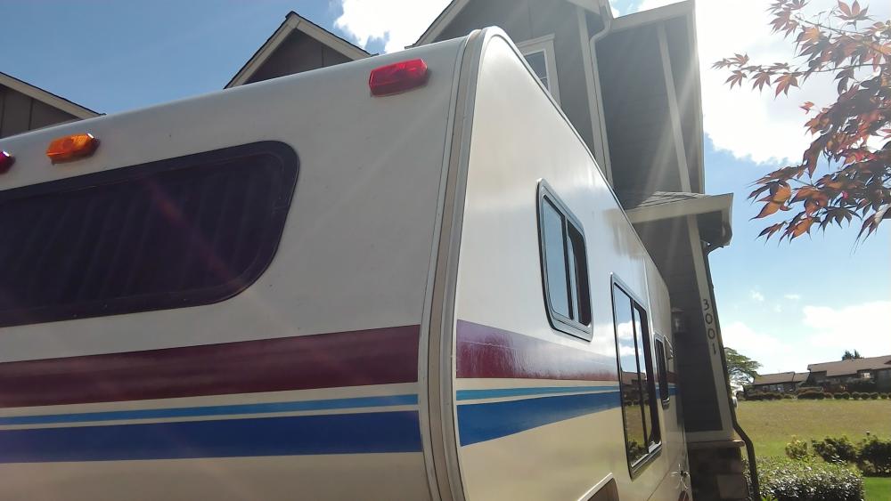

ToyoGuy Posted October 14, 2016 Posted October 14, 2016 Hi All, Read the above and thought I'd share my experience with this process out over a couple of years: My usual disclaimer, it's just what worked for me, no "know-it-all", "one-size-fits-all" instructions are implied. Anyway, per WME, I definitely use gloves and ditto JJR, no TSP for me, I've had some alarming results on other projects with that stuff. I may try a weak Oxygen bleach solution some time in the future. I have applied Zep twice and it has lasted 2 years at a time in sunny Cal being stored uncovered all year in the sun, I couldn't say about covered storage, I could maybe see 6 years though, with good prep and cool indoor storage.This product is, after all, designed for interior use.  Essentially, what I've seen is, it just starts flaking off when it gives up the ghost. Now, when I apply it, I use a non-colored microfiber application cloth. The first time, the lightly pastel-colored one I bought bled onto the white outside "field-area" over use/time during the application. (Didn't notice at first, took about 1 hr for the color to start bleeding out of the cloth, luckily I caught it soon enough, on the roof) I also eventually found that a fake lambs-wool floor-wax applicator head with the micro-fiber cloth wrapped around the wool material and stapled to the wooden back gave me the most even, consistent and thickest coats. (got it at Hopeless Depot) Speaking of thick, keep your eyes open to track any errant runs down the side or spots dripped on the hood. This stuff is a seriously high-solids product, it dries pretty quick and will leave hardened "blobs" on other finishes. A singe-edge razor blade will easily remove the stuff from glass windows, but I masked my Sunrader wrap-arounds and fan-vent lids and I'm glad I did. Removal from those could get dicey. If in doubt, mask it off, the stuff sticks pretty well to anything but silicone contaminated areas. (BTW, Having help to move ladders, allowing you to keep moving quickly and efficiently and keep an eye out for drips etc will definitely help). I have done my 18' Sunrader once with hired help and once alone. The application part of the process went far better and I got higher quality, better looking, more consistent results working with a competent helper, but then again, I'm not the young buck I used to be. As far as over-coating annually, my test results weren't impressive and it seems like once the original application is "cooked" or aged, it tends to flake off, which leaves very noticeable voids in new applications. It also seems to yellow some when over-coated. Again, I'm in sunny Ca, so someone else w/covered storage may get better results with that. Clean your rubber gaskets around the windows well, or avoid applying over them, they will streak black rubber over the rest if you apply over them dirty. My prep so far, has been - Barkeeps Friend the last two times, but this winter I'm going to very carefully try Zep's stripper for this product, and if it's a go, use that, then wash carefully, or abandon all that and just go with wet/dry like WME. (Will probably use #800 w/soapy water to save as much of the gelcoat as I can).  Again, as mentioned, a cool and windless day has been the best, heat/sun speeds the dry time and the stuff picks up dust, leaves, bugs etc really easily. A closed auto/truck-barn would be ideal, (like spraying, you absolutely need good light to see where you've been <wet>and where you're going <dry>) but few of us have that at our disposal. (I am going to borrow covered space after my prep to do only the application this next time around) Hope some or any of this helps. I must admit, it's a rewarding process after you're done, but it's no walk in the park for me when I do it. BR, TG PS Borrow more ladders or scaffold, I don't think you'll regret it.   Quote

WME Posted October 15, 2016 Posted October 15, 2016 It seems to take 3-4 coats to get 100% multilayer coverage. It seem you always miss a streak or 2. You can see what I'm talking about when you check each of the first coats in the sun.  Quote
ToyoGuy Posted October 15, 2016 Posted October 15, 2016 Yeah, it gets easily over 100 in the summer where I live in N. Cal (I've clocked the interior of the upper cabinets at 120 degrees on hot days with an infrared sensor) and I notice that the southern exposure exterior side and top where I park degrade well before the cooler and shaded northern / driver's side. Basically, the coating starts to flake off in those areas first during wash-downs after about 2 yrs for me. I may give Zep product support a call and see what they say about bonding to fiberglass, what the heck, they may have some good input! Â I only use the Oxy Clean stuff too, it's a great product. Quote
