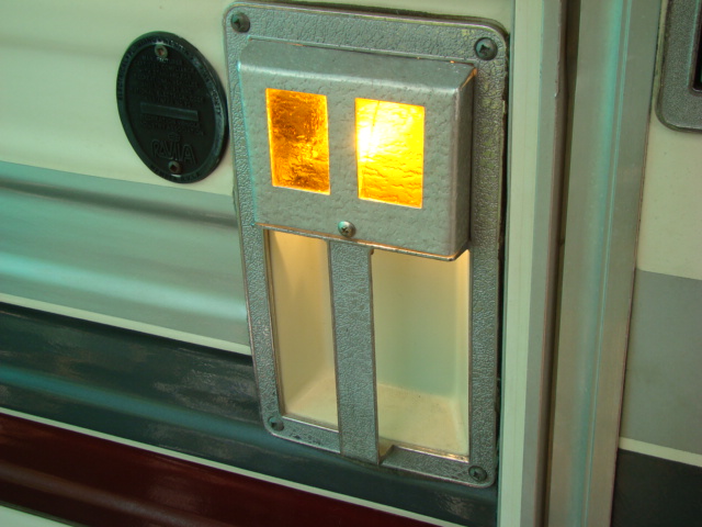

Homer Posted October 16, 2016 Posted October 16, 2016 Here is mine after I made one out of aluminum sheet and put stained glass in it . The on and off button is just under the top of the  handle under the screw holding the cover on. You can look at my photos and see how it was made. Homer Quote
markwilliam1 Posted October 16, 2016 Posted October 16, 2016 Homer, that is Sweet Man! I made a replacement lens using a 4 inch trailer light but no where as nice as that!! Quote
