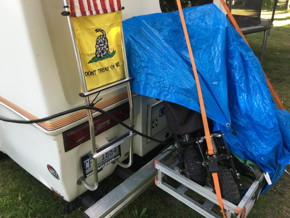

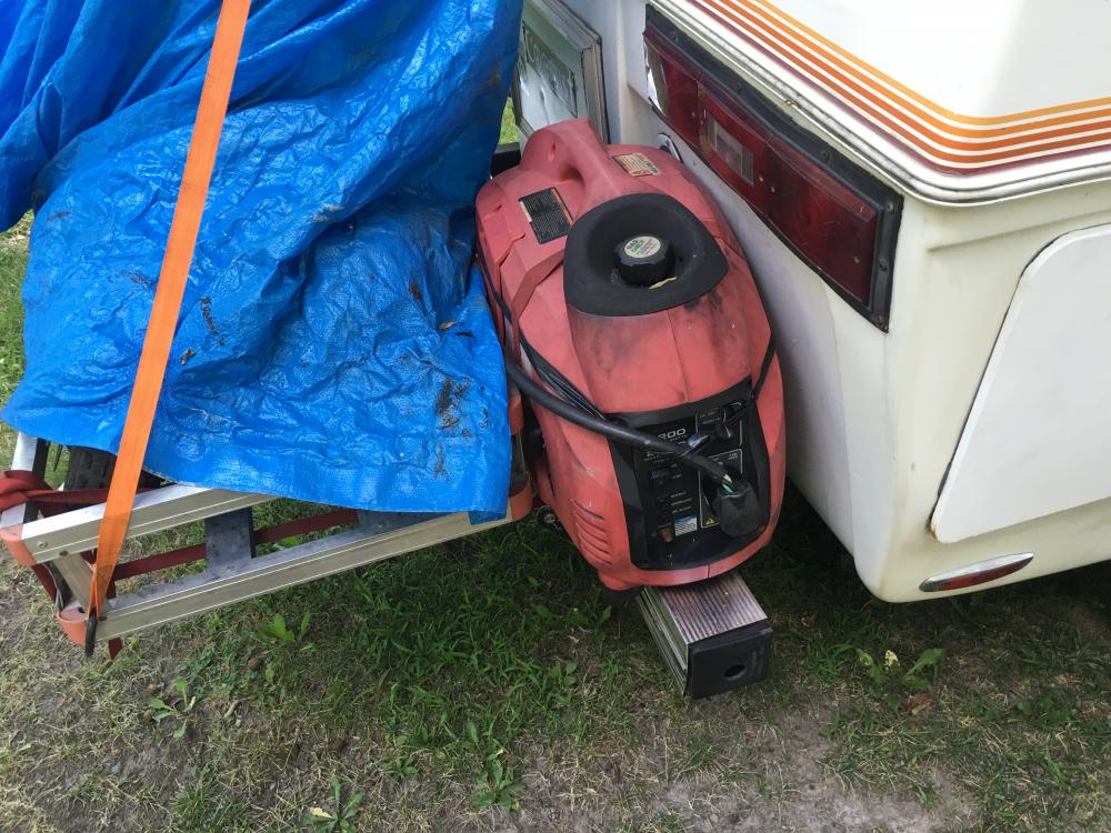

Totem Posted June 23, 2016 Author Posted June 23, 2016 My tools and equipment: 1.) iphone with camera and "my altitude" free app 2.) predator 2500 inverter generator from HF 3.) 11,000 btu coleman mach 1 power saver edition 4.) 1985 toyota sunrader (made in Indiana version) 5.) digital thermometer 6.) Kill a watt meter (not required but it will be great to see whats happening) Quote

Totem Posted June 24, 2016 Author Posted June 24, 2016 (edited) 14 hours ago, Maineah said: Why is he running the AC through an inverter when he has a generator? That's kind of stupid just buy a generator that will do the job. My 2800 watt Onan gen set ran the AC just fine! I AGREE! why try to run AC with a 1600 watt? my 2500 watt runs it fine also now that i downsized to the 11,000 btu PS edition AC. The unit he has (inverter) i think has higher output than the ryobi generator. if memory serves the ryobi is another 1600 (honda eu2000i clone) so its not strong enough; Edited June 24, 2016 by Totem Quote
