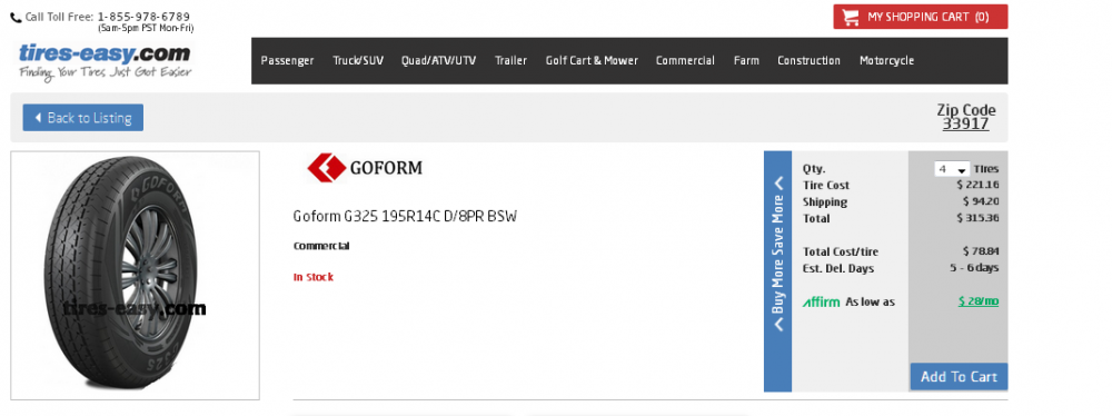

jjrbus Posted May 16, 2016 Posted May 16, 2016 Tire EAsy still has the GoForms but only in 195 http://www.tires-easy.com/195-14/goform-tires/g325/tirecode/G110320 Several of us bought these, but I do not have enough miles on tho recommend them. Quote

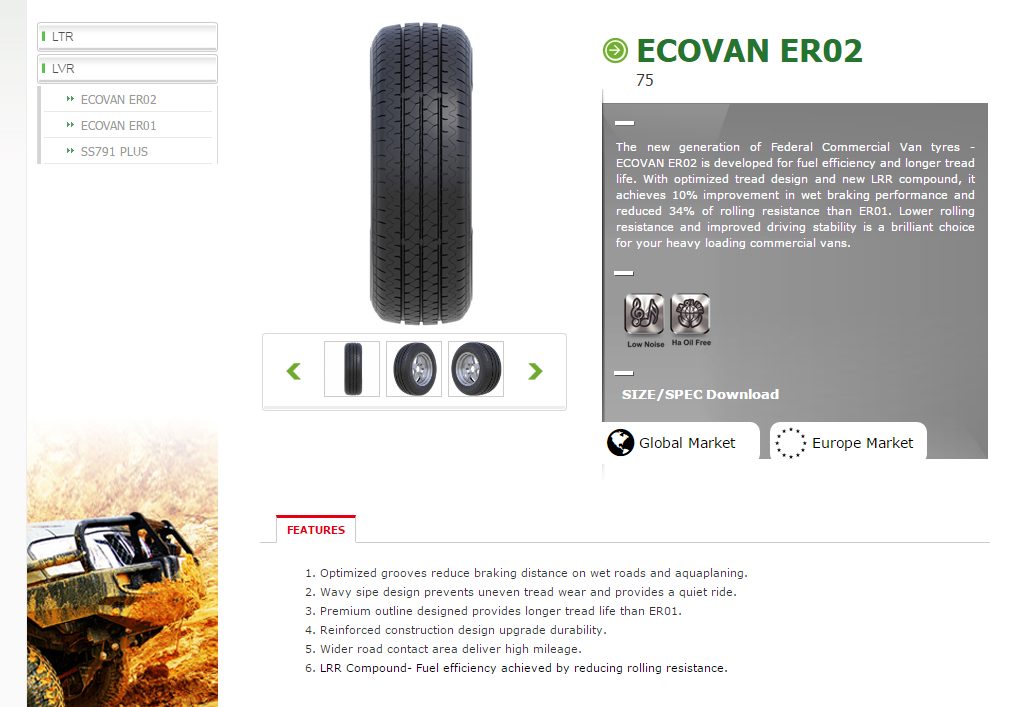

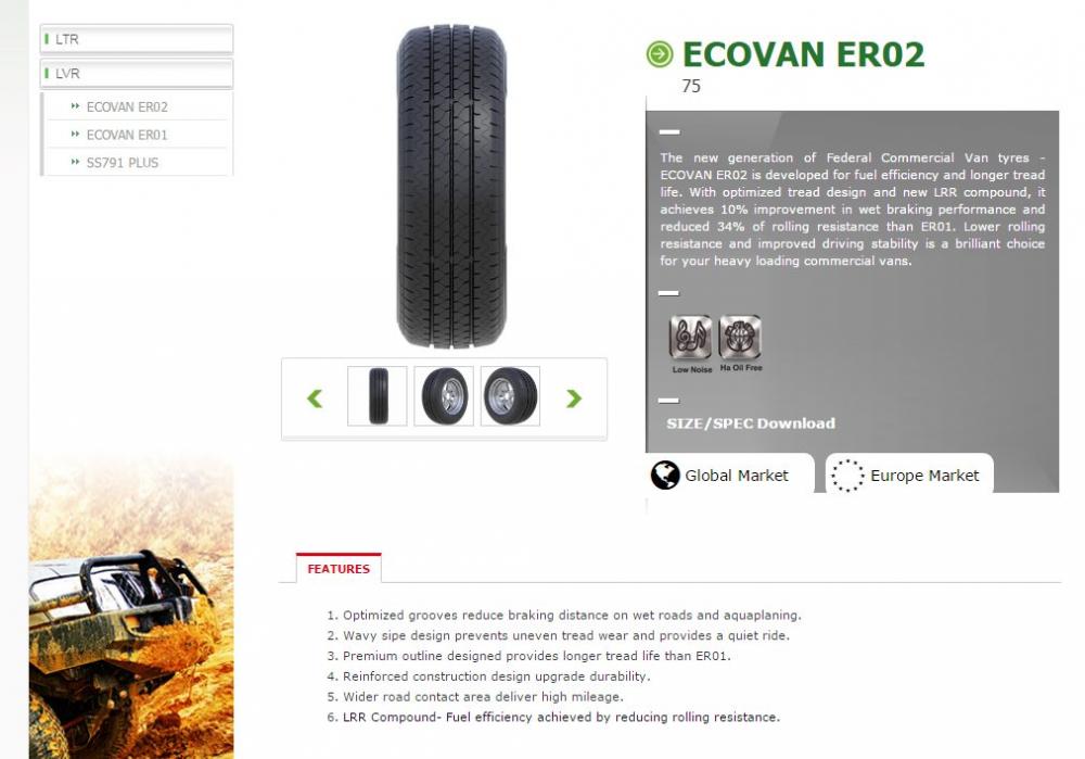

zero Posted May 17, 2016 Posted May 17, 2016 I can't speak for the other guy. I got my Federal Ecovan 8-ply rated tires, mounted and balanced, in Northern Michigan, for $92 each. Quote
