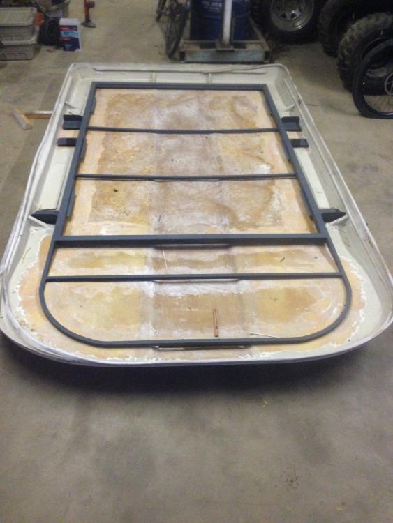

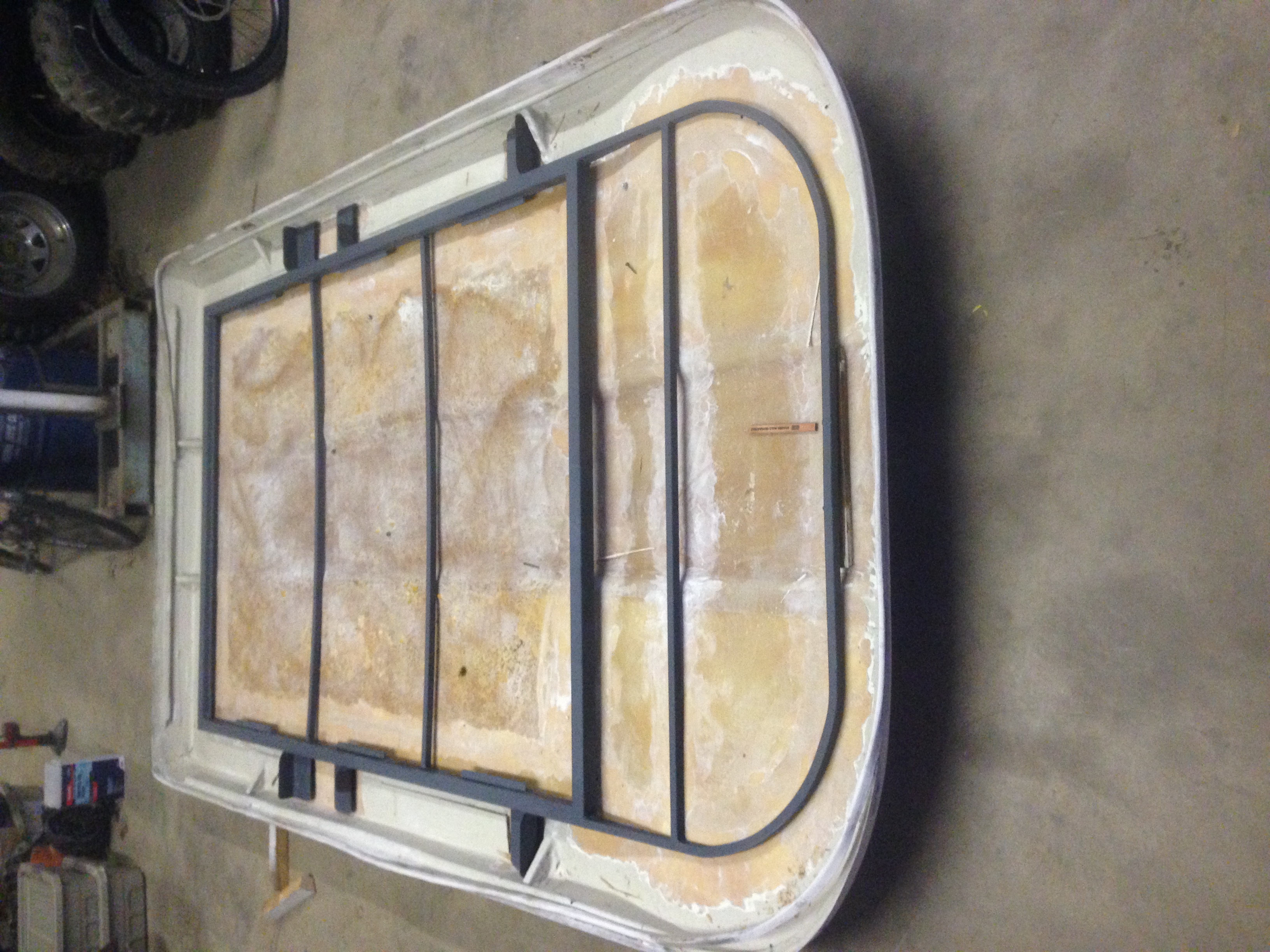

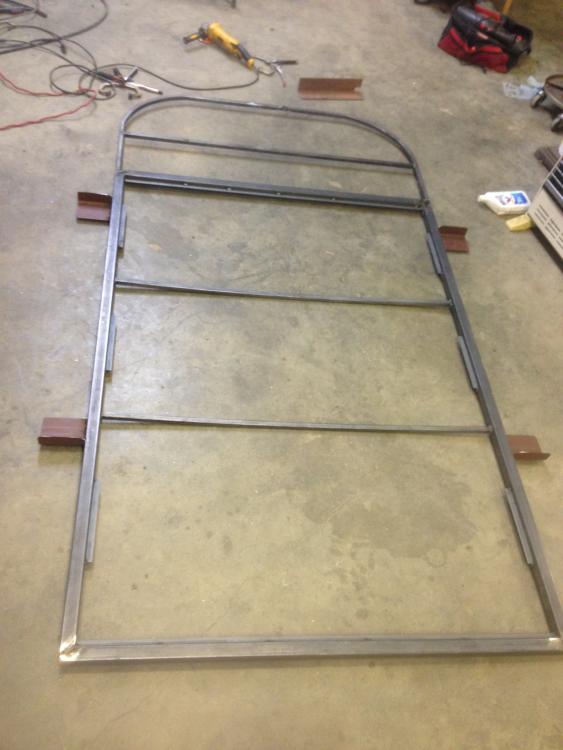

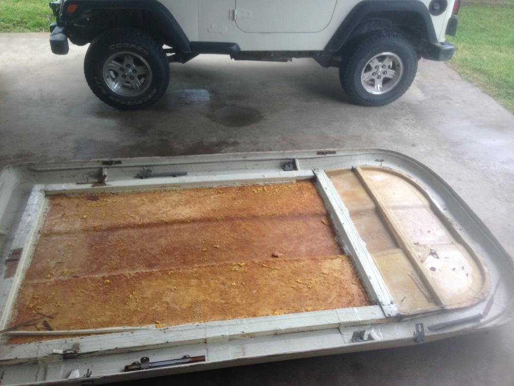

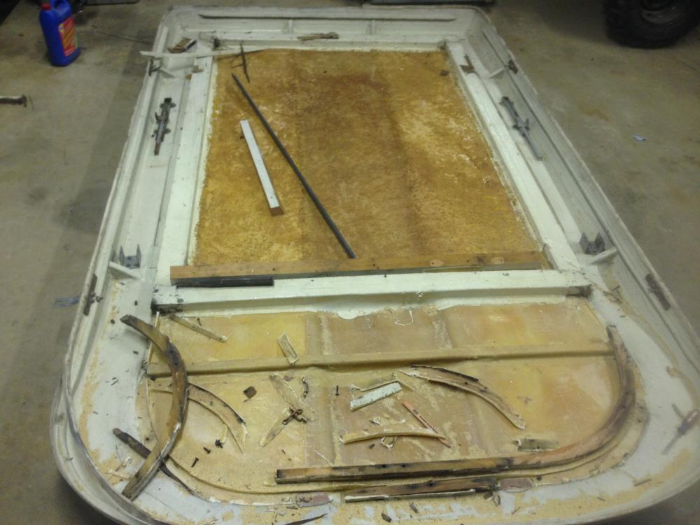

haney4147 Posted April 13, 2016 Author Posted April 13, 2016 Finally got back to the US and had some time to start working on this project. First step was to fix the sagging roof. I took the roof off and removed all of the rotten pieced together wood frame. Replaced it with a steel frame that included some added cross braces that had a slight arch to prevent future sag. Here are pictures. After the last picture I fiberglassed the new frame to the top completely covering the frame. As far as what vehicle to put it on. I think I have decided on making it semi-quickly removable. I want to build a 7 foot flat bed that the chinook body will sit on. The last bit of the chinook with the dropped floor will hang off of the back of the bed. The front will have to be closed off and a window installed that matches the truck window. Then I can use an inflatable boot to create a seal between the cab and camper. The reason for wanting it removable is I plan to do a lot of work to the camper and don't want to be committed to a truck that I may want to upgrade later. More updates to come soon. Moving to the floor next. Should I move this topic to the build section? Quote
payaso del mar Posted April 13, 2016 Posted April 13, 2016 beautiful work on that square tube. how'd you bend it that neatly? Quote
haney4147 Posted April 14, 2016 Author Posted April 14, 2016 Thanks. I know a guy that has a hydraulic roll bender in his shop, used it on the tubing. Quote
payaso del mar Posted April 14, 2016 Posted April 14, 2016 would love to see lots of photos of the top refurb....i'm afraid I have the same job coming on the fiberglass poptop of the Bandit....a fair amount of sag in the center on both fore-aft and lateral axes. Quote
