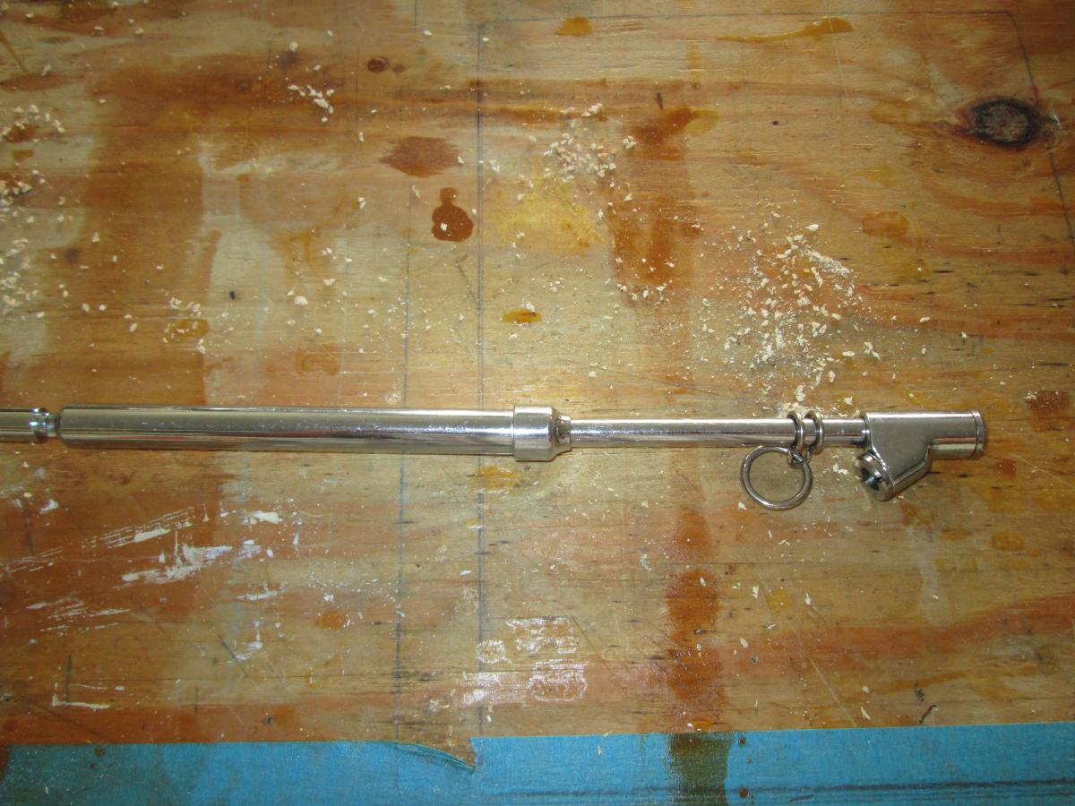

These valve stems will require the use of or work best with a straight inflator/gauge. Your local air pump at 7/11 will not work on them, or may work with great difficulty. Anywhere that deals with trucks will have this type of inflator/gauge.

I carry a reverse inflator which I put on whatever air hose I encounter if they do not have one, alternatively I carry a rubber extension so I can use it to access the metal stems (the other 4 can not be reached with a "straight on" inflator - note PIC shows quick release which I do not have installed
