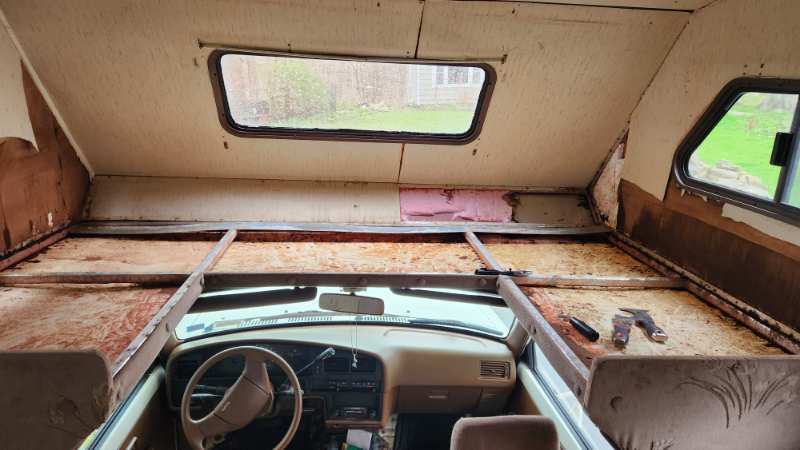

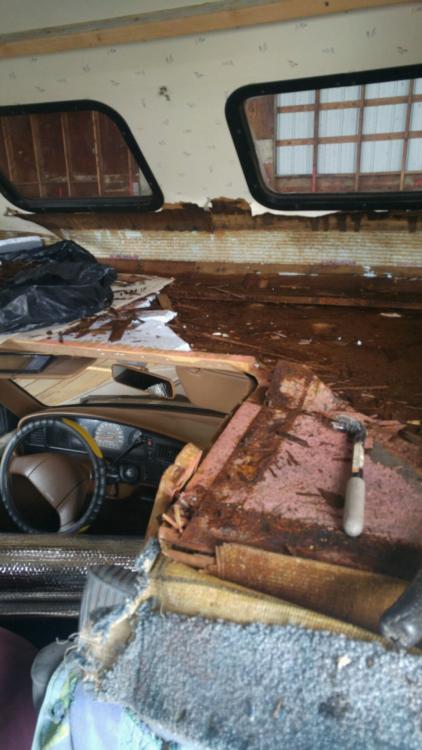

Ctgriffi Posted August 31, 2015 Posted August 31, 2015 While doing some routine maintenance, I was alarmed to find some moisture under the cabover bed today. Our 91 Warrior stays under a cover 24-7 to help prevent this kind of water damage: http://www.amazon.com/dp/B007TKJLRW/ref=pe_385040_121528360_TE_dp_1 My alarm turned to complete dismay when I discovered layer after layer of mushy, rotten wood over the cab. I'm going to need your tips/tricks to figure all this out, for sure. To start, here are a few questions: 1) Do covers really offer much protection from rain? 2) Just about everything under the bed is ruined, but the sidewalls seem firm/solid; will I need to tear those vertical sidewalls apart in order to rebuild the "base" area? 3) Does anyone have a drawing that might correspond to the structure of my Winne? 4) In the second photo I'm attaching, you can see the piece that joins the two outer sections of fiberglass skin. There was no trace of adhesive/caulk/butyl where those pieces come together... I know this seam is on the underside, but surely there's still a need for some waterproofing. (?) Quote
zero Posted August 31, 2015 Posted August 31, 2015 I'm not sure what you mean by "cover." I've found that plastic tarps often help RVs rot even faster then when left uncovered. A genuine canvas breathes and works better. But I built a pole barn to park mine in. I've had it with fixing rot. You will likely find that even the walls that feel solid will have thin plywood that is water-logged. When wood is completely soaked - it rots very slowly but weighs a lot. when it starts to dry a little and some air gets in -is when it really starts to rot fast. I just re-did the walls and roof on mine - and also the floor on the cab-over section. Never again (I hope). RV walls in these older rigs are bad enough even if IN a barn. Once moisture gets in the walls - it is pretty much trapped forever. Unlike walls on a house -there is no ventilation to insulation and/or wood can dry out. Quote
Skydancer2992 Posted August 31, 2015 Posted August 31, 2015 My 91 Warrior looked a lot like yours. I vacuumed out all the peeling wood. Used Great Stuff foam to seal holes to the outside. Laid fiberglass cloth across the area, overlapping the remaining good wood by at least three inches. U-shaped around the cab opening. Poured cups of resin over the entire area. The resin sealed up all the remaining wood and fiberglass into a solid composite. Added a layer of plywood over the entire area to distribute the load. The plywood goes from the metal angles on each side. Two pieces so that the cab area is covered but I can move one over the other to open up below - a feature that I almost never use. Quote
Ctgriffi Posted August 31, 2015 Author Posted August 31, 2015 I'm not sure what you mean by "cover." I've found that plastic tarps often help RVs rot even faster then when left uncovered. A genuine canvas breathes and works better. But I built a pole barn to park mine in. I've had it with fixing rot. Would love to have a pole barn, or even a basic carport, to keep this thing out of the elements! Too many projects right now and not enough time/$$. The cover I was referring to was in that Amazon link: http://www.amazon.co...1528360_TE_dp_1 Quote
Ctgriffi Posted August 31, 2015 Author Posted August 31, 2015 My 91 Warrior looked a lot like yours. I vacuumed out all the peeling wood. Used Great Stuff foam to seal holes to the outside. Laid fiberglass cloth across the area, overlapping the remaining good wood by at least three inches. U-shaped around the cab opening. Poured cups of resin over the entire area. The resin sealed up all the remaining wood and fiberglass into a solid composite. Added a layer of plywood over the entire area to distribute the load. The plywood goes from the metal angles on each side. Two pieces so that the cab area is covered but I can move one over the other to open up below - a feature that I almost never use. Thanks for the input. I hadn't really considered the fiberglass cloth/resin option—I've got a table-saw, chop-saw, jig saw, etc and have some carpentry experience so will probably go that route. (I'm also crazy about this little gizmo.) Sounds like you didn't make the half-circle cutout in your final plywood pieces. Any particular reason why? Quote
shibs Posted August 31, 2015 Posted August 31, 2015 typical Toyota damage, I have this, I ripped out all the wet stuff including the open cell insulation. I installed a cover on top if the fan so I could keep it wide open. I keep a window cracked half inch and keep the fan vent wide open. No rain gets in through the fan vent. but some water soaks in through the leaks. But with the fan vent open the inside dries in a day after the rain and it does NOT smell any inside the camper. Quote
Skydancer2992 Posted August 31, 2015 Posted August 31, 2015 Mine did not come with a center section cushion, just a couple of old cushions and a piece of wood. I put in a futon mattress, which I can fold over and slide the 20" plywood piece forward. Really haven't needed to do that. The bunk is just too handy as temporary storage. The camper was also missing part of the front driver corner of the loft, which had been covered with metal tape. I had to pull off the aluminum gunnel, beat it into shape before placing back. Made L shaped fiberglass repairs to the outside corner. Filled inside corner with great stuff. Added Bondo filler to even out the fiberglass. Quote

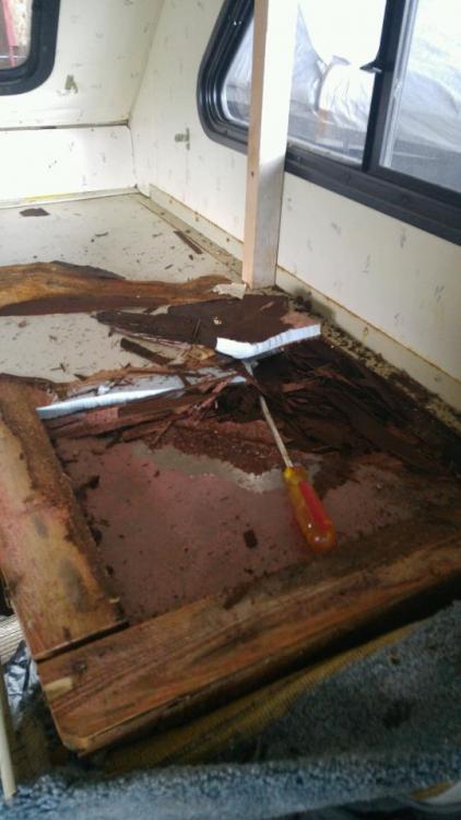

Dolphinite no longer here Posted September 1, 2015 Posted September 1, 2015 Ctgriffi, You're probably going to have to rebuild that rotted area. You can try all the band aid fixes mentioned but unless you remove all of the rot, the rot will just continue on to any of the new wood you might add.This is a pain of a job to do, but not particularly technical. All of the new wood can be found at most any lumber yard and, if you use epoxy glue, the joints you make with the new wood to the old will probably be stronger than the original construction. Just go slowly when removing rot and try to document everything with photos so you know how to put everything back together. I rebuilt my cabover area a while back and I can send you some photos if you'd like. Send me a private message and I'll send you the pictures. John Quote

Dolphinite no longer here Posted September 2, 2015 Posted September 2, 2015 Christian, I sent you photos of the work in a reply to your pm. Hope everything came through. Check your inbox on this site. John Quote

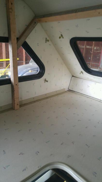

Ctgriffi Posted July 11, 2016 Author Posted July 11, 2016 I feel like I finally turned a corner on this cabover rebuild—got to the place where I was actually able to start adding new material this past weekend, and it feels great! Still a ways to go, but I feel like I can get my arms around the problem now, and I know what needs to be done. I also was able identify a very likely source for much of my water intrusion: on one side of the cabover, the corner trim was loose and poorly sealed, right where it makes the lower turn and runs across the underside. New wood inside of that area will allow me to secure the trim and get it sealed up. Quote

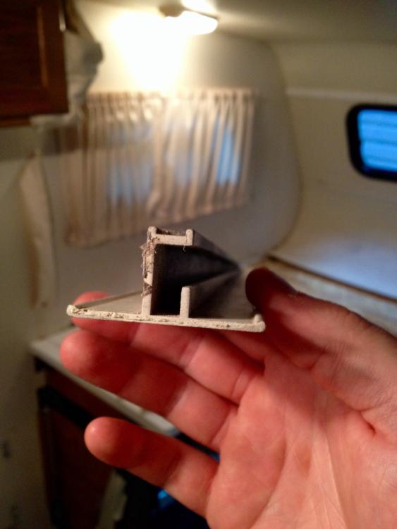

Ctgriffi Posted August 9, 2016 Author Posted August 9, 2016 Can anybody tell me, for certain, which side of this channel faces to the front of the vehicle? This is the underside piece that joins the fiberglass skin, right in front of cab windshield. Quote
