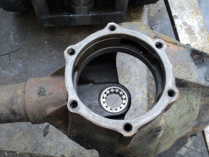

Finally got the chance to update my axle swap. My 1979 Galavan on 1978 chassis came equipped with the 5 lug, semi-float foolie axle. My toy is only 16' long, with a deck extension bring my total weight to 4200# with me in it.The rear dual wheels were unsafe, not to mention the increase in tolls while traveling. Wanting to get away from the duals and being a GM truck guy, I decided to install a 14 bolt 10.5 ring gear 8 lug full floating 1 ton axle. The axle width o/s tire to o/s tire was 74" on the "foolie" dual , and 74" on the single wheel GM. A perfect swap. The GM also came standard with 4.10.1 gearing, same as the Toyota.
I did have to upgrade to15" rear wheels as there are no 8 lug 14" GM rear wheels made. I installed 195/70R15 load range D tires which are close in diameter to my 195/75R14 Hankook tires currently installed.
I will attempt to upload, in chronological order, the pictures from start to finish.
