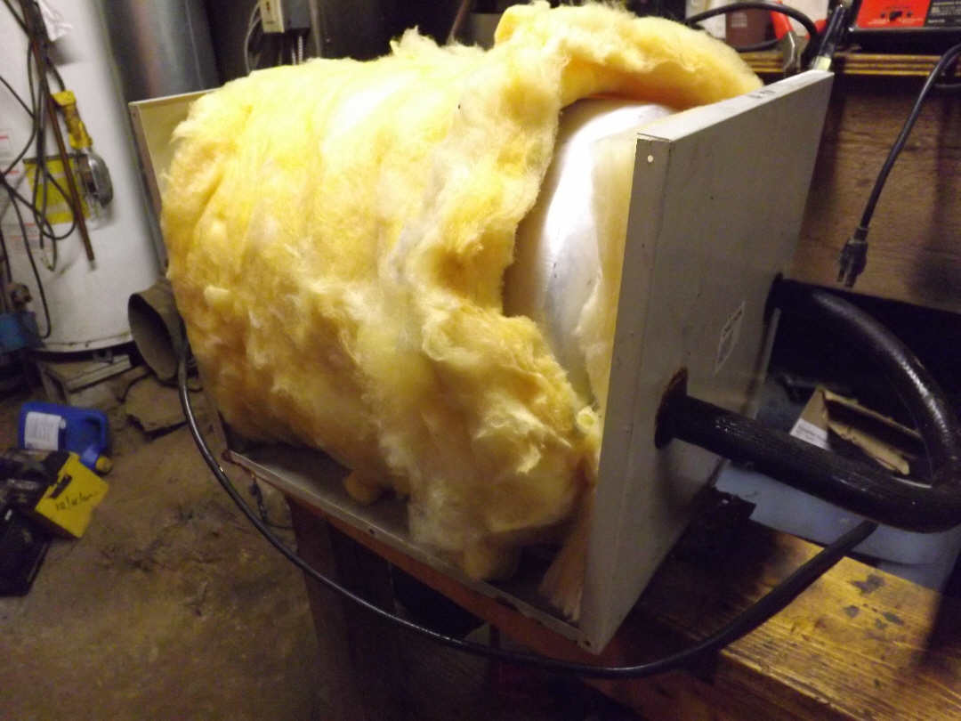

Donnie Posted October 5, 2015 Posted October 5, 2015 My 4104 bus had a water heater that used engine coolant circulated thru the tank to heat the water as you were driving. Also my Cortez used the same method.... Both of these worked quite well. I'm sure that this method has been used elsewhere. Any good fabricating shop can build the tank for you & the plumbing part is not that difficult either...Donnie Quote

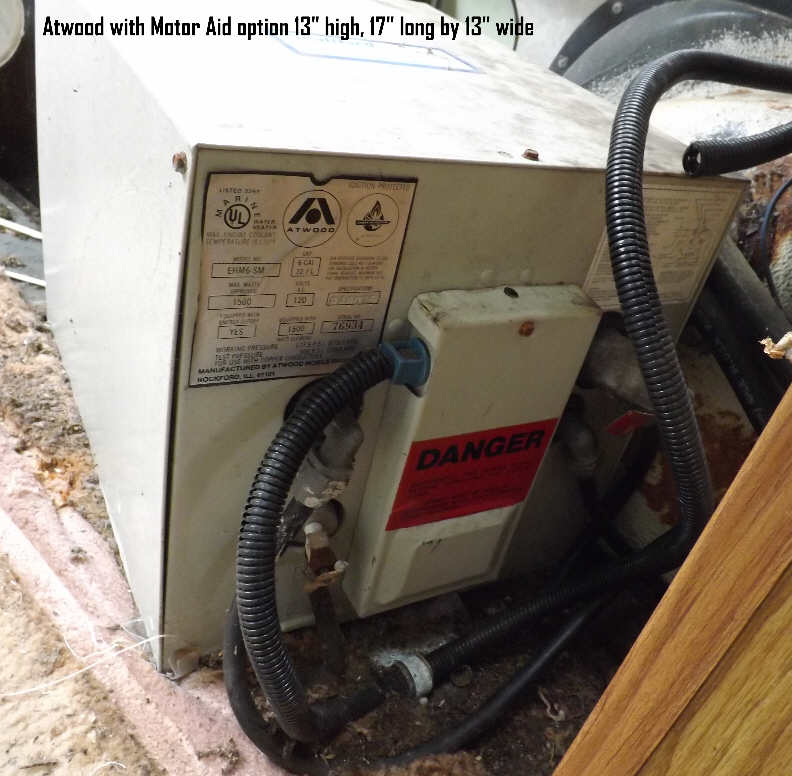

linda s Posted October 5, 2015 Posted October 5, 2015 Heat exchange water heaters are often found on boats. Seward and Atwood are the most popular. I considered this option for my Tiger Provan because the heater space is right behind the drivers seat and I wouldn't have to run the coolant lines very far. About the same price as a propane water heater but if you don't want to run your engine you'll need electric hook ups to heat your water. Jason remember your Sunrader originally had a 4 gallon water heater. The 6 gallon one won't fit. Too deep and the seat gets in the way. Replacement is a Suburban SW3 model. Not made anymore but there are still some on ebay. Linda S Quote

mustrmrk Posted October 27, 2015 Posted October 27, 2015 A year before we quit cruising we bought one of these for our boat: http://www.isotherm-parts.com/index.php?main_page=product_info&cPath=4_34_107&products_id=1991 Way spendy for an RV, but it IS an awesome water heater for a boat. No propane, but that's a good thing on a boat - propane is heavier than air, so it tends to settle in the bilge and, if not purged, can cause an explosion. Every time we ran the engine we had hot water - I would love to have a heat exchanger hot water heater on the RV. Quote
linda s Posted October 28, 2015 Posted October 28, 2015 A year before we quit cruising we bought one of these for our boat: http://www.isotherm-parts.com/index.php?main_page=product_info&cPath=4_34_107&products_id=1991 Way spendy for an RV, but it IS an awesome water heater for a boat. No propane, but that's a good thing on a boat - propane is heavier than air, so it tends to settle in the bilge and, if not purged, can cause an explosion. Every time we ran the engine we had hot water - I would love to have a heat exchanger hot water heater on the RV. Find a wrecked or salvage Lesharo. They have heat exchange water heaters. A wrecked Rialta will too. There are some on eBay and not crazy expensive. The drawback is if you don't want to run the engine you need a generator or someplace to hook up http://www.ebay.com/sch/i.html?_from=R40&_sacat=0&_nkw=atwood+heat+exchange+water+heater&_sop=15 Linda S Quote
zero Posted October 28, 2015 Posted October 28, 2015 My 4104 bus had a water heater that used engine coolant circulated thru the tank to heat the water as you were driving. Also my Cortez used the same method.... Both of these worked quite well. I'm sure that this method has been used elsewhere. Any good fabricating shop can build the tank for you & the plumbing part is not that difficult either...Donnie Winnebago used that system in the Phasars and Lesharos. I have a couple of those heat-exchanger tanks in my barn. Kind of a neat system. I suppose it could be a mess though if that internal tubes ever sprung a leak and that toxic antifreeze got into the domestic water supply. Quote
zero Posted October 28, 2015 Posted October 28, 2015 Here's one from a 86 Winne Phasar I stripped. I've got several good ones. Will sell cheap to someone who really wants one. Quote
