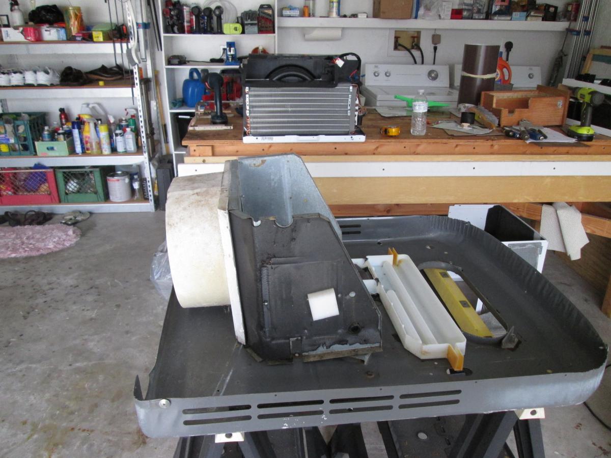

jjrbus Posted July 16, 2015 Posted July 16, 2015 It is pouring out with lightning and thunder so time to relax. Being a few french fries short of a Happy Meal I have decided that despite all logic, the work and issues, time and money I am going to get a Honda Eu2000i to successfully run my RV. So in between my other projects and entertaining my wife I am pursuing this goal. It may take a some time, it may never get done. I spent time researching which window AC to use and poured over things like moisture removal, btu's, decibel ratings, CFM, LRA's on and on ad nauseaum. All the time watching for a suitable donor and searching the internet for info. I came across a suitable Duo Therm Breeze air carcass to start with. With an almost new shroud. Disassembly went quickly, it normally does. Plus I do not have to keep track of the parts, or where they go, cheap, mindless entertainment! Sadly I cannot scrap the parts, AC theft became so bad in FL that scrap yards only accept AC parts from licensed AC people. Now I have a platform to experiment with. The first thing I discovered is that despite all my research the largest AC I can reasonably fit will be an 8000 BTU window unit. So my fun now will be looking for a suitable unit to adapt for my purpose. Any input, thoughts, ideas, suggestions, opinions, criticism, or wise cracks greatly appreciated. Jim SW FL Quote

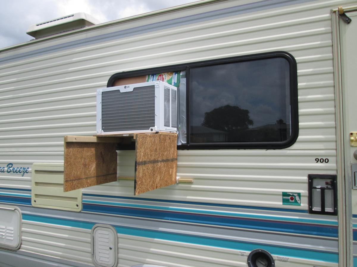

jjrbus Posted September 12, 2015 Author Posted September 12, 2015 I have procrastinated on this as long as I can, I did uses the time to read as much as I could find on using alternate ac systems in rv's. Most of what is posted is useless. Such as " I put a window AC on my TT and it would not cool it" OK, How big an AC, how big a trailer, what was the temperature out, was it in the Gobi desert or Alaska? Found a few tid bits that did help. So after muddling through many spec's I decided on an 8000 BTU LG window unit. LW8015ER. They give the most info including DBA'a and seem to have a good reputation. Never did find the Locked Rotar amps even on the unit. It does list 700 watts and 6.5 amps when running, so well within the Honda's specs. So first test is will the Honda EU2000i run it, by my research it should. I hooked it up out on the Lanai (fancy name for screened porch) and ran it on house current to test. Then the little Honda. The AC starts easily on the Honda even in Eco mode, I have started it and stopped it in 92° temperature with 66% humidity and it does not miss a beat! Makes me wondering if a 1000 might do it? I have a temperature drop of about 20° But suspect it will do better once it is able to recirculate inside air instead of trying to cool the yard. Next test is the biggie, it will be installing in a window with duk tap, cardboard and bailing wire and see if it will cool the Toy on a hot humid day?? This is a big concern, average roof air can recirculate 300 cubic feet a minute and the LG only does 200! The next hot day we have coming is tue, it will be 92! Jim Quote

jjrbus Posted September 14, 2015 Author Posted September 14, 2015 Playing a bit with the 8000 btu AC. It is 92° out with 66% humidity, the toyota inside was in the high 90's when I started. In 3 hours the temp is down to 80. So looks like test is a failure? Maybe, maybe not? I am working on the floor so is a large hole letting cold air out.I have covered as best I can with carpet, but it is not a good seal. Also not a great duk tape seal around window ac either. The over cab area is not cooling, the AC is not blowing towards it so may need a small fan to circulate air in there?? I turned the window air off and turned on the 11K roof air, in about 30 minutes the inside temp has risen to 82! Starting with a cool dry air I would think a larger unit would have quickly dropped the temp?? The window AC was putting out air at about 62 ° and the roof air is putting out 65° degree air. Color me confused. I did a real hack job on a temp install on the window AC, proud to say I used not 1 inch of bailing wire! The neighbors are taking long looks as they drive by : ) Now the temp inside is up to 83? Jim Quote

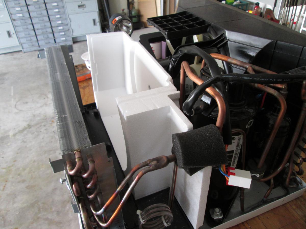

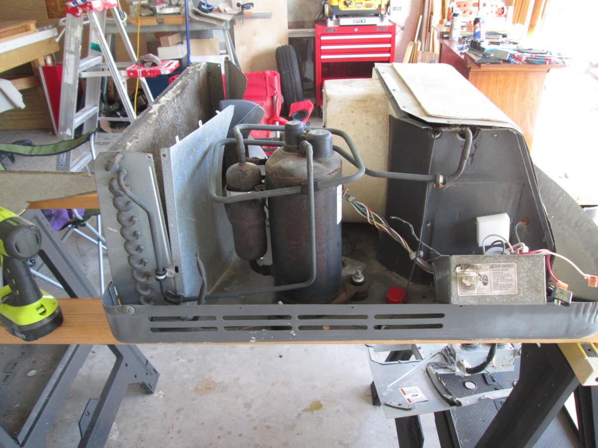

jjrbus Posted September 28, 2015 Author Posted September 28, 2015 Everything is going great. I checked and rechecked, read and figured. Now the first problem has arose. The evaporator is 17 1/2" and the area for it to fit is 16 1/4". Plus everything seems to be on the wrong side of the AC unit? I am sure I have voided the warranty so hopefully I can find a work around. I am going to attempt to do this without opening the AC system, making it harder on myself than it has to be. May have to rethink that? Jim Quote
WME Posted September 29, 2015 Posted September 29, 2015 Split things and pop rivet in an expansion strip of sheet metal Quote

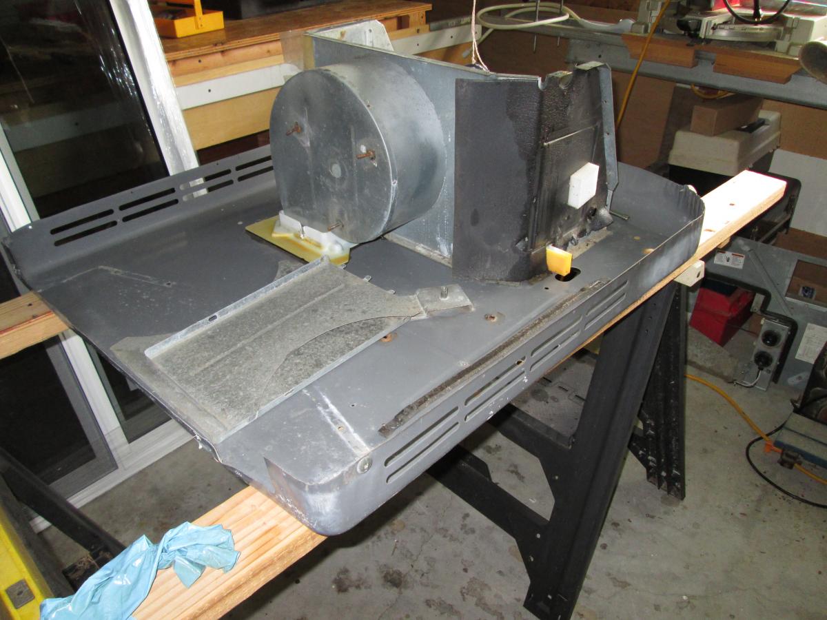

jjrbus Posted October 2, 2015 Author Posted October 2, 2015 This is not going well, construction has changed in the last decade or so. Taking it apart is a challenge and trying to figure if some things are the design of the AC for efficiency or to aide manufacturing? The entire base appears to be part of design to send water to the condenser fan for extra cooling. Plus the fan seems to turn in the wrong direction for my intended design.I do not have much time invested in this work wise, but standing there trying to figure what to do is adding up. Maybe I should take up golf? Jim Quote
