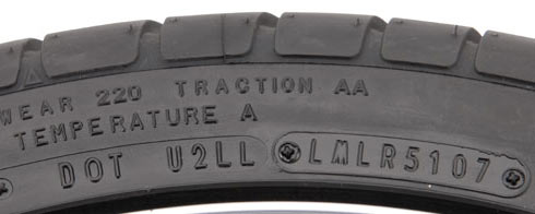

jjrbus Posted July 15, 2015 Posted July 15, 2015 Welcome to a unique little community. Given? At least you did not pay to much : ) Tires are one of the biggest issues I see, they may look good but are way too old to be trust-able. http://www.tirerack.com/tires/tiretech/techpage.jsp?techid=11 I will not drive on tires that are over 7 years old. This info is good to have when buying new tires also so as not to be sold tires that look like new but are old. HTH Jim SW FL Quote

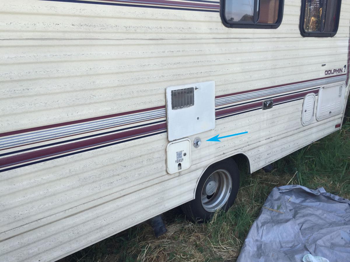

5Toyota Posted July 16, 2015 Posted July 16, 2015 the connection at the blue arrow is for using pressure water it does not fill the tank. is for a full hookup camp. the petcock spigot is the water tank drain. to empty drain the water tank. the round screw on cap under the little door is the one that you stick a hose in to fill the water tank. and the kitchen sink drains into the same tank as the shower . the bathroom sink and the tolit go in the black tank. if the greay water tank is to full from the kitchen sink it will rise up out of the shower. hooking a hose on at the blue arrow will not fill the tank. Quote
jfunk Posted July 16, 2015 Author Posted July 16, 2015 Thanks 5Toyota. I filled the fresh tank using the input in this photo where the green arrow point: I only hooked a hose to the petcock spigot with the orange arrow to see if it would drain the fresh water. Good to know about the connection at the blue arrow not filling the tank: Quote

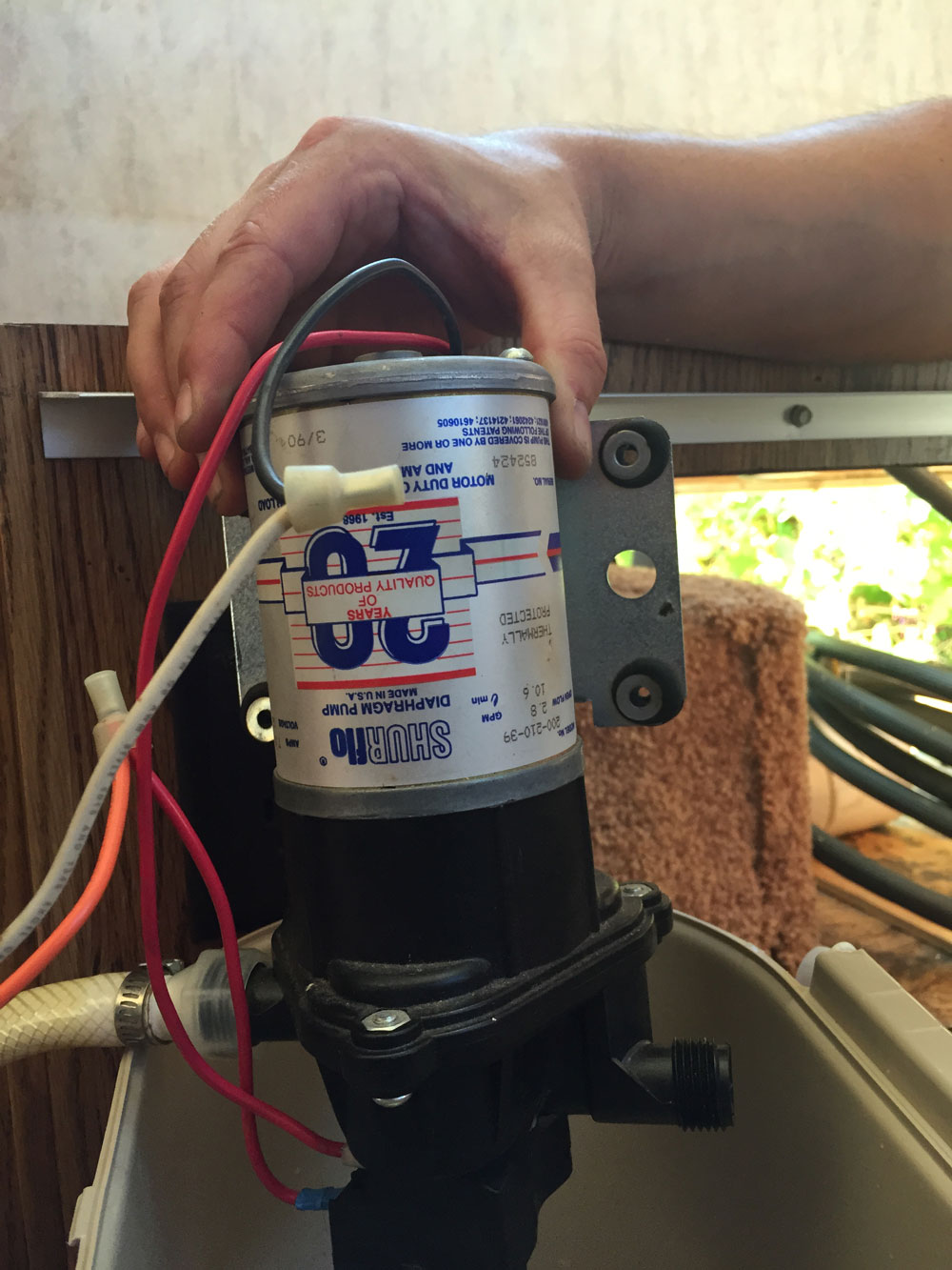

jfunk Posted July 18, 2015 Author Posted July 18, 2015 After disassembling the water pump in the cabin I was able to get the water flowing again today! It is hard to say exactly what the issue was, but the pressure switch seemed stuck so we took it apart and clicked it a bunch of times and reassembled and the water flows. Almost went and bought a new pump and I am glad I did not. Next issue is the passenger side wall rotted out and I am going to put that one off for a bit... Quote

zero Posted July 18, 2015 Posted July 18, 2015 After disassembling the water pump in the cabin I was able to get the water flowing again today! It is hard to say exactly what the issue was, but the pressure switch seemed stuck so we took it apart and clicked it a bunch of times and reassembled and the water flows. Almost went and bought a new pump and I am glad I did not. The switch just might have worn/pitted contacts. That's what DC current does to switches. You can get a new microswitch for around $3. Quote
