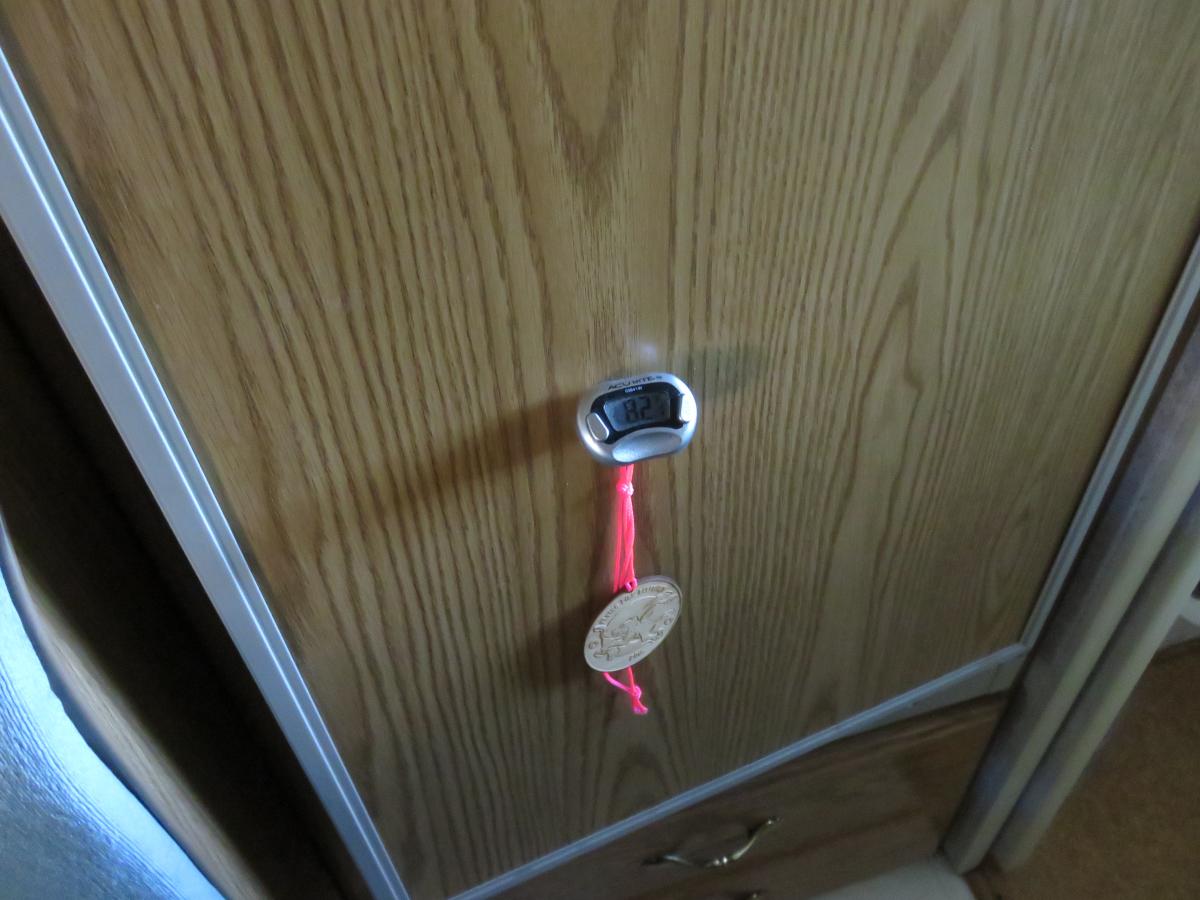

darrel Posted July 16, 2015 Posted July 16, 2015 Drill a hole in the front of refer door, at an angle, and insert a digital meat thermometer. Now you have digital read out of the temp inside your refer without opening the door. Quote
WME Posted July 16, 2015 Posted July 16, 2015 Refer thermometer. http://www.walmart.com/ip/Accurite-Digital-Wireless-Thermometer/16888916 Quote
linda s Posted July 16, 2015 Posted July 16, 2015 Refer thermometer. http://www.walmart.com/ip/Accurite-Digital-Wireless-Thermometer/16888916 This is so cool. I'm getting one. I would never drill a hole in my door. Linda S Quote

Bob C Posted July 16, 2015 Posted July 16, 2015 I also use a wireless thermometer when checking the frig temp. I also use the same one when parked to see what the outdoor temp is. Quote
