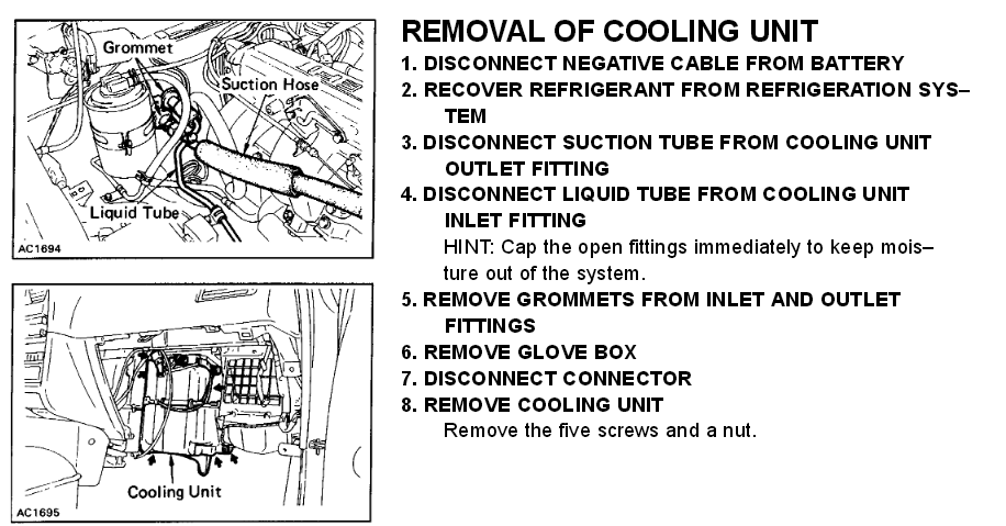

jjrbus Posted June 18, 2015 Author Posted June 18, 2015 I wrestled with the decision to replace the expansion valve. I did not want to take more apart on this. But being a masochist I went ahead with it anyway. I need to buy some golf clubs and give this stuff up! After struggling to get the cooling unit out I realized I had not unhooked the liquid line :Poster_oops:after that it was easy to remove. During the removal I noticed that it had been removed before, I was not the first in there. Look what I found in there, no matter what I had done with this it never would have cooled right! I shoulda known! Left click picture to enlarge. I knew I was going to have some cooling loss after the conversion, but I think I just compensated for it!! The foam seals are are also deteriorated badly. Any suggestions on where to get those?? JIm SW FL Quote

jjrbus Posted June 19, 2015 Author Posted June 19, 2015 I had an R12 system in unknown condition, but nothing looked very good! I bought a new Denso compressor kit for cheap that included a new expansion valve. Cleaning this evaporator is a real challenge, starting to wonder if it is worth it? Plus it is a serpentine so difficult for a DIYer to flush. I was at Costco and they had 30 lb cylinders of 134A for a super price, I do not remember how much, but very cheap. So I have a lifetime supply of 134A! I seem to have wore out the OPP's emoticon, sorry. Jim SW FL Quote
