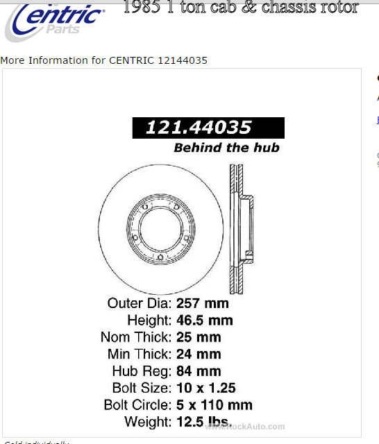

Lilalchemist Posted December 11, 2014 Author Posted December 11, 2014 So now I have disassembled the front brakes and removed the rotor and hub to repack the bearings on my 5 lug front. Everything appears to be original. I am planning on installing new shocks, I have some KYB Gas shocks for the front. I am looking into getting some Yokohama Y356 tires. I would like to be able to rotate all my tires, so I would like to upgrade to a 6 lug front. So my question for you all is will the new rotor hub still work on my current spindle? I am assuming that it is a larger rotor for a bigger brake system, is that correct? Does that mean a bigger caliper is needed? Basically, what parts do I need for this conversion? Thanks in advance everybody! Quote
