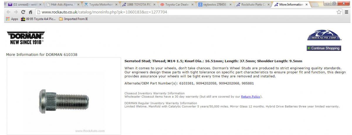

chefdave Posted November 11, 2014 Author Posted November 11, 2014 Hi derek are measurments in mm. will compare to dorman on measurenents. IF the same whoopee. :-) Thanks dave Quote
Derek up North Posted November 11, 2014 Posted November 11, 2014 Unfortunately, one of the critical dimensions isn't given: diameter of the knurl. But if all the others check out, you could investigate further. BTW, it seems the same stud is also used on some Landcruisers. http://afcparts.co.uk/0184-004-WHEEL-STUD-BOLT-LUG-NUT-OEM-90942-02077.html http://www.tojo4wdcentre.com.au/part-shop/view/627/141/landcruiser/landcruiser-uzj200-9-07-12-11/90942-02077-stud-wheel-bearing-hub-front-and-rear Quote

zero Posted November 11, 2014 Posted November 11, 2014 Why the heck don't you just buy the correct parts from Rock Auto like I do here in the USA? They have a British website catalog and have the right parts. http://www.rockauto.co.uk/ Quote
zero Posted November 11, 2014 Posted November 11, 2014 Those studs are cheaper in the UK then here in the USA. $1.03 here in US and the equiv. of 98 cents in the UK Quote
linda s Posted November 11, 2014 Posted November 11, 2014 Well Dave looks like the Rock Auto site is the best deal. My Toyota dealer has to order them so let me know ASAP. I didn't order yet. Good thing I checked the site before I went there. Linda Quote
