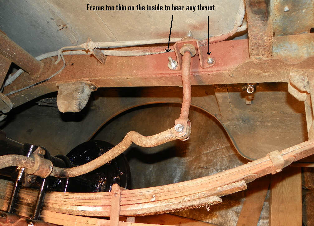

I measured again and do in fact have 16' 8" from tail to front bumper, and about 78-80" wide excluding mirrors, as well as equipped with a rear sway bar, though I can't say if it is factory or aftermarket. I can say that it has been there a long time.

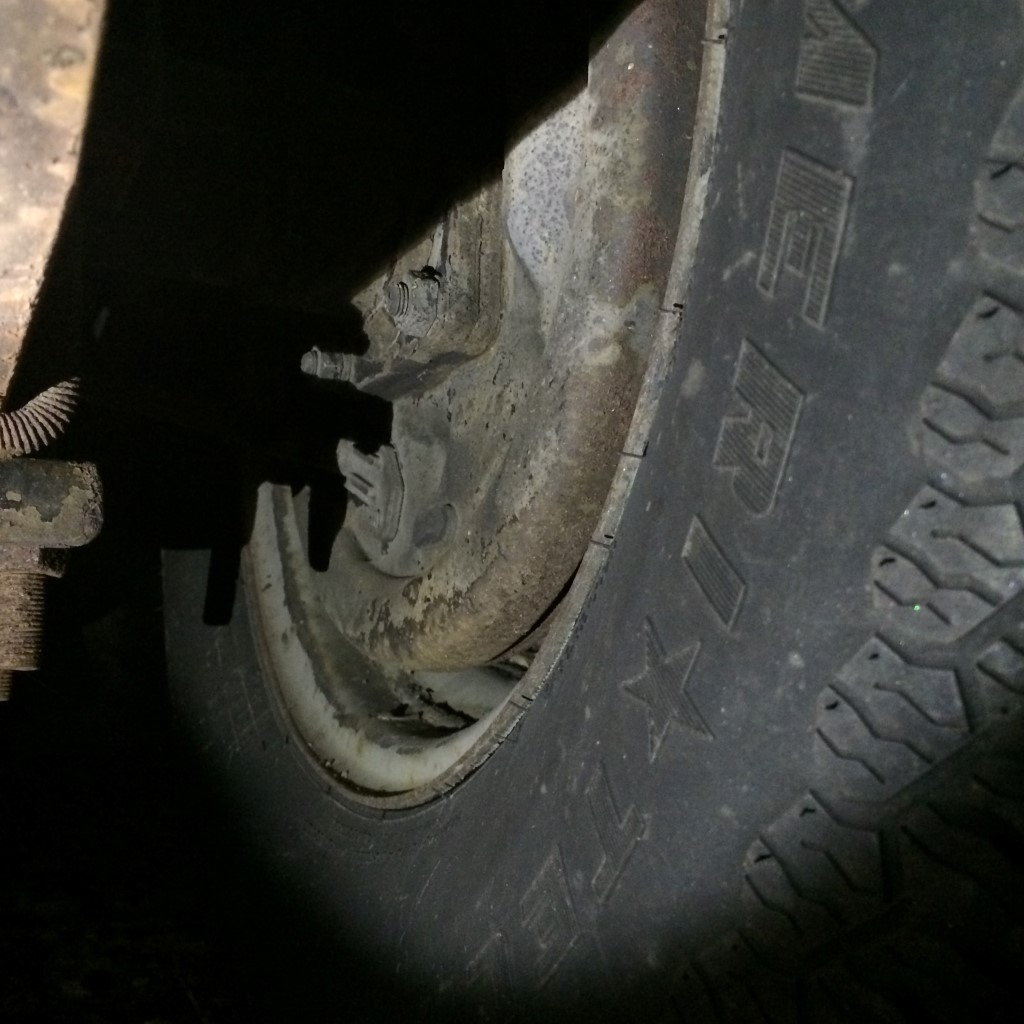

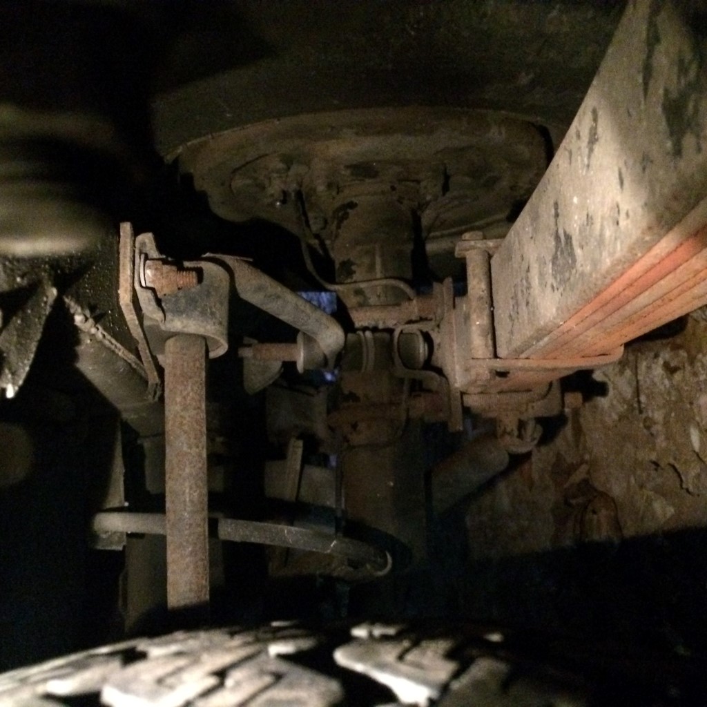

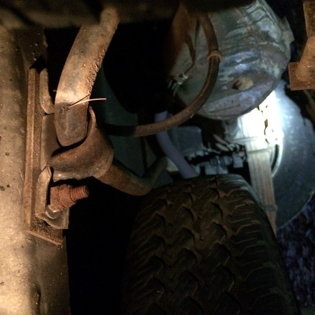

Various pics attached of my rear suspension setup as it is, including the inner rim and brake backing showing the wheel offset...

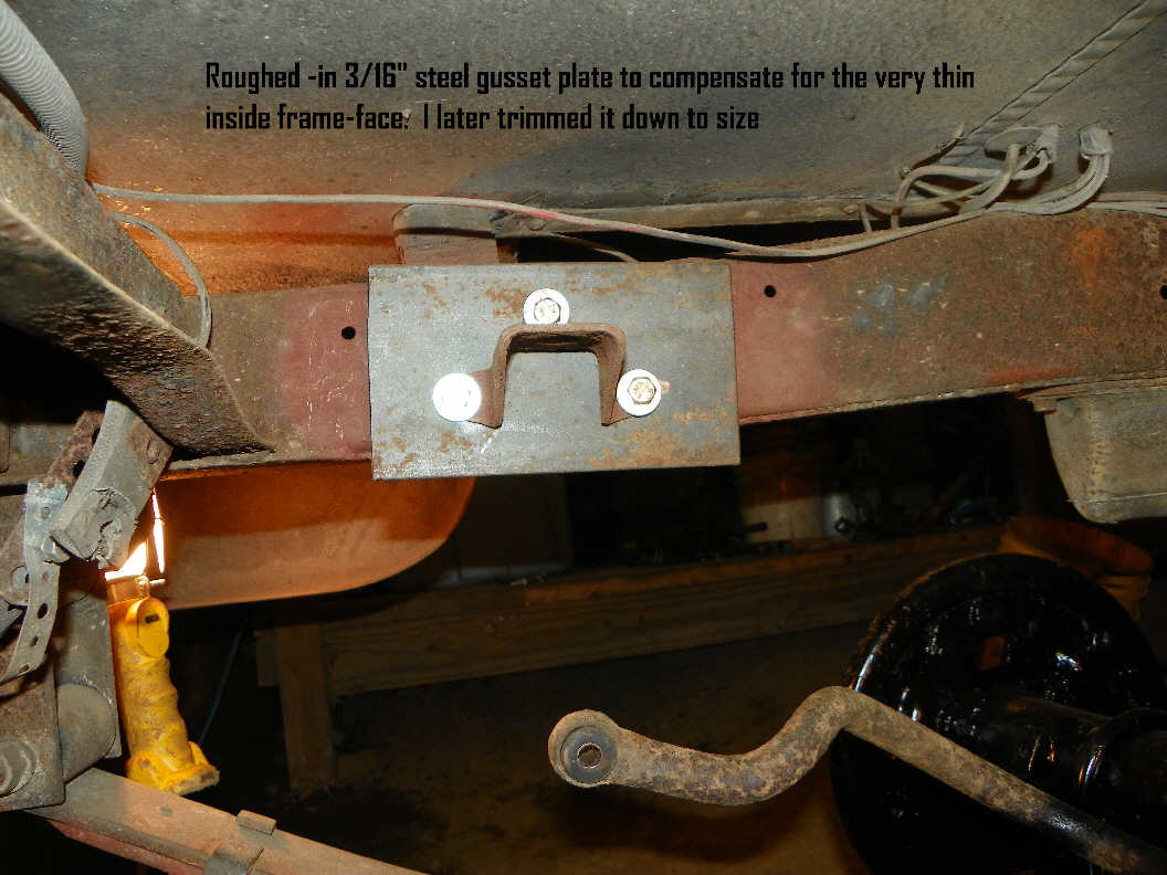

Looks like some one took a front sway bar and got a crafty and installed it on the rear axle
Yes, that DOES look a front sway bar. Nice job installing it back there. The OEM sway bar Toyota uses on the rear when installed in Toyota RVs has the main part of the bar attached to the rear-axle and the end-links attached to the frame. Your's is the opposite. Here's a 1987 sway bar installed in my 1978 Chinook.

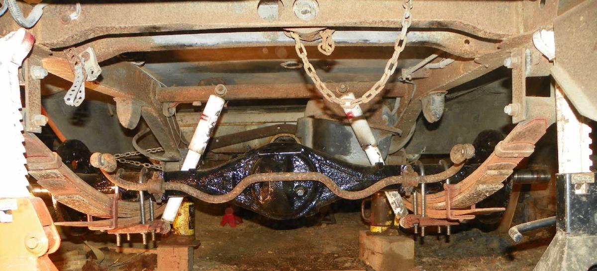

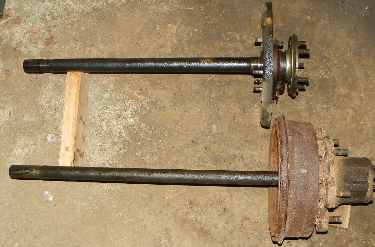

Also some axle photos comparing the 1978 semi-floater to a 1987 full-floater.
That is ONE nice stack of leaf springs someone put together for your rig!
