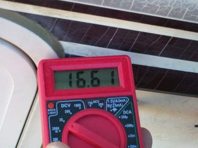

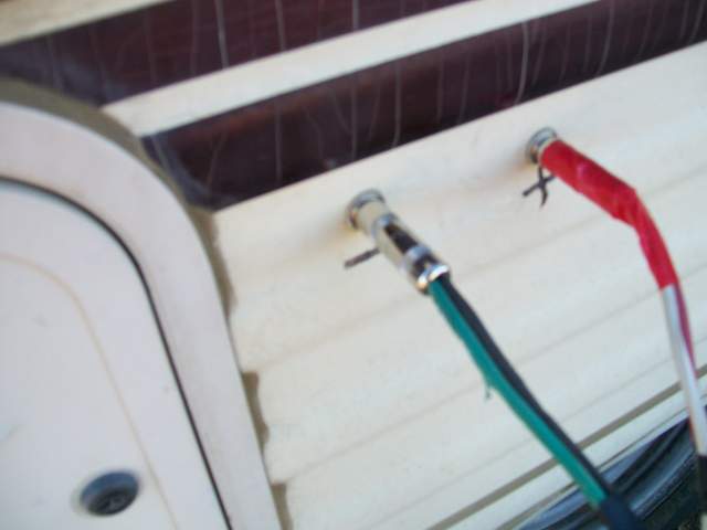

douglitas Posted November 6, 2013 Posted November 6, 2013 I used 1/4" guitar cable connections. two little holes marked "+" and "-" next to the battery box. I even found some plastic stoppers to put in them when not in use so dust can't get in. Actually haven't tested these yet but I think they should work. I'll post pics later. Still waiting for a nice aft and cold night to test heater..hopefully this Fri night. As far as Maineh's comment...I wasn't sure exactly how many volts these panels can put out..they are nominally 12V panels but when I short circuited them and tested voltage it was more like 17V..which is fine because you want to hit that 12V batt with plenty of voltage. Yet, the battery's own voltage keeps panel voltage in the ballpark. Quote

Maineah Posted November 7, 2013 Posted November 7, 2013 I used 1/4" guitar cable connections. two little holes marked "+" and "-" next to the battery box. I even found some plastic stoppers to put in them when not in use so dust can't get in. Actually haven't tested these yet but I think they should work. I'll post pics later. Still waiting for a nice aft and cold night to test heater..hopefully this Fri night. As far as Maineh's comment...I wasn't sure exactly how many volts these panels can put out..they are nominally 12V panels but when I short circuited them and tested voltage it was more like 17V..which is fine because you want to hit that 12V batt with plenty of voltage. Yet, the battery's own voltage keeps panel voltage in the ballpark. You don't want to hit them with 17 volts for very long. Look at the back of your panel there should be a listing for voltage and current usually a panel in bright sun light will do at least 20 volts and that is for a 12 volt panel they are regulated to make voltages in the 12 volt range. Unless you have some pretty big wires (that won't fit in a phone plug) for a 30' run your voltage drop will be very high that maybe your saving grace for an overcharged battery. A charge controller is only about $15 a good investment. Quote

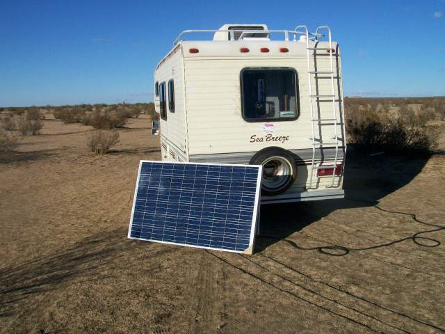

WME Posted November 7, 2013 Posted November 7, 2013 I have a 20ft run from my panel to the controller and 6 ft from the controller to the battery. Thats just where everything fits. I used 6ga wire for the runs. Zip cord ain't going to cut it on a 30ft run. Quote
douglitas Posted November 7, 2013 Posted November 7, 2013 "You don't want to hit them with 17 volts for very" since it's a gel batt I guess I'm not supposed to exceed 14.1V....with the truck idling (and the gel batt fully charged) the voltage goes to14.2! but of course that's the voltage while charging. I will have to start taking notes and check the charge voltage with the panel in full sun. sounds like maybe that charge controller suggestion is a good one! thanks for the comments..it's a work in progress! PS I made my cable out of 4/12 AWG and combined two wires into one to get neg and pos equal to 6 AWG. Quote
douglitas Posted November 8, 2013 Posted November 8, 2013 I don't even have a gel batt--it's AGM! can take 15V so I'm OK for the meantime. Quote
stamar Posted November 25, 2013 Posted November 25, 2013 somewhere in here are pics of my set up its a 15 foot stickem panel on the right side then two wires that go to the vent pipe in front of the bathroom. down the closet is the controller, then another hole in the closet goes to the battery. what id do with a panel like that? Id have a permanent mount for it on the side so it can get some juice while its sitting. as opposed to storing it inside. Quote
