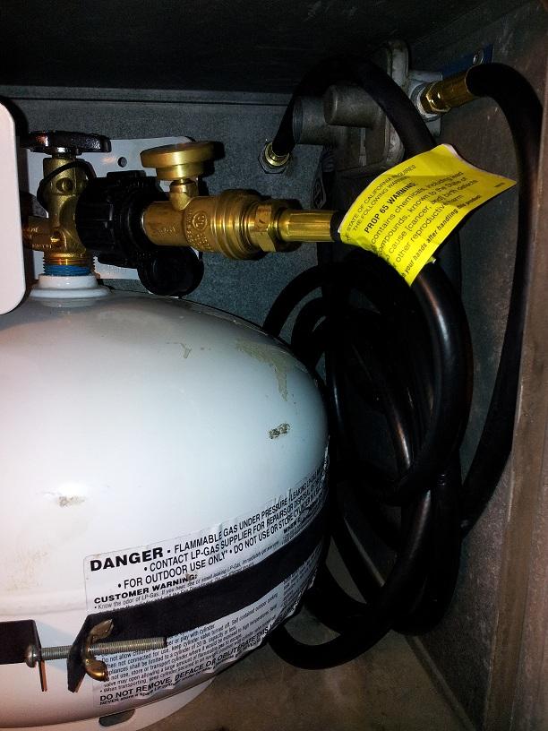

Sunrading Arkansas Posted February 5, 2013 Posted February 5, 2013 I need some help here, my Sunrader has a horizontal tank that appears to have an "PDQ" (i have no idea what this means) OPD. This is a conundrum to me, because as far as I've read only BBQ tanks (vertical) are suppose to have these. Please help me identify what type of tank this is and weather I need to replace it, the hose, the regulator, etc. I want this thing SAFE and able to be refilled. As is, there are no propane leaks that i've been able to detect and all gas appliances work. As always, thanks for all the feedback and assistance! Quote
waiter Posted February 5, 2013 Posted February 5, 2013 Pat, good catch; It appears as if someone installed an OPD on your horizontal tank. The problem isn't the OPD float, the problem is the pickup tube, or in the case of BBQ tanks, the lack of one.Find a LP place that services / sells tanks. The question you need to ask; "Are you familiar with older style 20 lb horizontal tanks", If the answer is yes then ask the next question: "Are you aware that they are exempt from the OPD valve requirement"If the answer is Yes, ask the next question;"Can you inspect this tank and tell me if it has the correct valve and pickup to operate safely in the horizontal position, as it appears as if someone installed a standard OPD valve on this tank." I am not aware of any OPDs (the center mounted ones) that can operate with a horizontal tank. The newer horizontals have the valve and OPD new the top of the tank.You might want to check around on Craigs list or e-bay for a tank. John Mc 88 Dolphin 4 Auto Quote

Maineah Posted February 5, 2013 Posted February 5, 2013 John it looks like he has a bleeder tap so it's probably an older horizontal tank. I don't think it can be be certified there is no fixing it the only ones they will recertifiy are the ones with the valve off center because of the shutoff float.. Quote
zero Posted February 5, 2013 Posted February 5, 2013 I encountered the same thing as Maineah mentioned - here in NY. I tried three gas places and none will fill a 20 lb. horizontal tank with a center-mounted valve. It must be off-set to be recertified - at least around here. There are places selling brand new horizontal tanks for $80 if you want one. With mine - I'm removing the tank from the recessed compartment and putting a pair of deep-cycle batteries in there. I'm going to stick a vertical tank on the back bumper - but keep the regulator in that compartment out of the weather. Quote
waiter Posted February 5, 2013 Posted February 5, 2013 The older ones are exempt from the OPD valve. Now, thats not to say that the folks that refill are willing to refill it. I've never had a problem getting mine refilled, I keep a copy of the exemption on my glove box. John Mc 88 Dolphin 4 Auto LP Tank non-OPD Label.pdf Quote

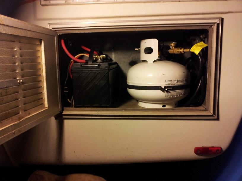

Stevo Posted February 5, 2013 Posted February 5, 2013 I've read horror stories about storing propane bottles horizontally. Can someone please tell me if the way my propane bottles are stored in my 82 Sunrader is okay? (See photos below) Thanks Quote
Maineah Posted February 6, 2013 Posted February 6, 2013 The older ones are exempt from the OPD valve. Now, thats not to say that the folks that refill are willing to refill it. I've never had a problem getting mine refilled, I keep a copy of the exemption on my glove box. John Mc 88 Dolphin 4 Auto Yes they are because they have a bleeder that has to be opened in order to fill it but if the tank has an expiration date it can not be refilled. Will they check? not too likely if it stays in the MH. Quote
Maineah Posted February 6, 2013 Posted February 6, 2013 I've read horror stories about storing propane bottles horizontally. Can someone please tell me if the way my propane bottles are stored in my 82 Sunrader is okay? (See photos below) Thanks Your tanks are cool they are mounted they way they belong and they are modern tanks. The problem is storing/using tanks where they can allow liquid propane into the lines laying on their sides if not designed to or up side down. Propane boils at around -40 so if liquid is allowed to escape it expands instantly into vaporized propane. The new OPD tanks have a float inside that prevents this or so it says in the fine print all though as near as I can tell it all goes out the window if it's completely upside down. I'm going to try that when I fill a tank at the camp ground next summer inquiring minds want to know. Quote

Sunrading Arkansas Posted February 6, 2013 Author Posted February 6, 2013 (edited) @waiter - Thanks! I was afraid that was the case. From what I've gathered here it seems like these Propane-service places are a mixed bag as far as knowledge/experience goes. @jdemaris - That's what I'm thinking I might do too. Seems like rear mounting a vertical tank would be a lot easier (and cheaper?) when out and about rather than chasing down a pricey horizontal tank and finding places knowledgeable enough to fill it safely. I've got some digging to do I guess...I'll post up pictures once I figure out what direction I go. Any cons to the rear vertical tank mount idea? Has anyone done this with success/failure. Thanks again everyone for all the help and support! Edited February 6, 2013 by Sunrading Arkansas Quote
waiter Posted February 6, 2013 Posted February 6, 2013 Maineah, My local propane place re-certified mine, $5, all they did was a visual inspection and leak check, They normally check the OPD valve on recert, but since I don't have the OPD valve, theres nothing to check.. Patrick; As for the rear mounted tank. I've seen a couple, you obviously know the risk. Stevo, I love those tanks. Thats the way to go, dual tanks with the auto switchover regulator. JD; whos selling horizontals for $80. I'd love to get a spare, and thats a price I can afford. Quote

Sunrading Arkansas Posted February 11, 2013 Author Posted February 11, 2013 @Waiter - You were definately right; one of the previous owners installed a standard OPD in my Horizontal Tank (as is stamped on the valve guard "For Horizontal Use"....not anymore, ugh). Camping World wants $300+ for a new Horizontal Tank, even $149 is just too much. BUT, here's another idea I had: MY PROPANE COMPARTMENT DIMS are 24'W x 12.5"D x14"H.....so what about an 11lb vertical tank (or 2 side-by-side in tandem?) - http://www.amazon.com/Manchester-Tank-10393-1-ACME-Vertical/dp/B000C77UYA/ref=pd_sim_sbs_auto_3 Any reason why this wouldn't work? With one 11lb. would I be running out all the time? Thanks, Patrick Quote

Stevo Posted April 9, 2013 Posted April 9, 2013 This might be a dumb question but is it cool to store a propane tank in the same compartment as a battery, or does it depend on what kind of battery you have? Here's the way I went: I have a 12ft hose so when I'm stopped I disconnect from the 11# and connect to my 20# BBQ tank which is Bumper Mounted (at least that's the set-up for now). I may look into a use undercarriage mountable tank at the RV salvage yard in Carthage,MO so I can utilize the rest of that compartment for additional house batteries....we'll see. For now this set-up works very well. Quote
Sunrading Arkansas Posted April 10, 2013 Author Posted April 10, 2013 @Stevo - from what I've researched there are many RVs (mainly 5th wheels) that house both in the same compartment without issue. From what I've read the possibility of issues is etremly minute....plus I figure if you own one of these Toyhouses (being over-weight, under-braked, and pre-stringent safety standards) you must, to some extent, be an adrenaline junky. Quote
