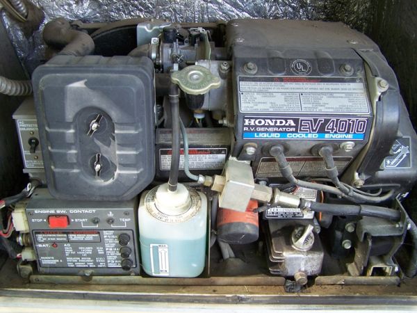

turtle Posted September 24, 2012 Author Posted September 24, 2012 I dont think Onan is exclusive to the market.... I have seen Kohler, and even a Honda liquid cooled RV generator set options in Toyhomes, . This one was mounted into a 1987 Dolphin Generac is another maker of them as well These options are no longer made in the smaller size and footprint required by the small gen compartment on Toyota rigs. My understanding is that even repair/service parts for Kohler are no longer available. You may be able to find these generators used but the cost of buying used then rebuilding to working condition could easily equal the price of a new Onan. This is the main reason many have gone to home/contractor generators. The Onans are just too expensive and the other alternitives have dried up. Quote
Davidadro Posted September 24, 2012 Posted September 24, 2012 Yeah, I agree, the newer options are very limited to our segment. We all are rebuilding our Toyhomes, and as such, we might need to have a Genset reworked too. If one finds an older one at a reasonable price, there are still parts out there for them, even for Kohler and for the Honda. Just type in Kohler RV generator parts in a Google search and there are listings for various places still offering a wide selection of them. If I were to get one used, I prefer the liquid cooled Honda or even a Kohler to any Onan, even if it had to have work done to it first. Here's the place to get the Honda RV generator parts http://www.hondalawn...Generator-Parts Here's a used Honda 4010 rated at 3200/4000 watts for sale at $800 bucks. I think, even with the needed muffler and any refurbish work needed, it wouldn’t be much more invested than a new or newer smaller sized portable Honda, and definitely less expensive than any new comparable sized Honda portable. It could be a great option for one wanting a run while travel generator for a Toyhome for one wanting to lay out the cash. http://www.reachoo.c... (Pontiac) $800 Here's a 6010 max rating at 6000w for $500.00 http://ocala.craigsl...3269686195.html Here's a Whole 1987 Dolphin with the 4010 already installed for nearly the price of a new Honda 3000W generator/inverter, LOL! http://www.reachoo.c...sa, GJCO) $2950 This Generac 3600W generator at 29.5L x 19W x 13.5H will fit into a customized compartment on a Toyhome or on some kind of back bumper set up no problem. http://www.norwall.c...CFcne4AodOUcA2g For as much as I need mine, I chose to forfeit the expenditure at this time, but who knows what the future holds. As many do, I choose to carry a generator that I pull out of my side storage hatch and run it outside, and at 2500/3175 watts, it works fine for me presently. There are many options for those out there, and I guess with all things Toyhome, it all comes down to what one wants to put in, and how much work they want to do or have done, and how much they wish to spend. Happy Travels! Quote
