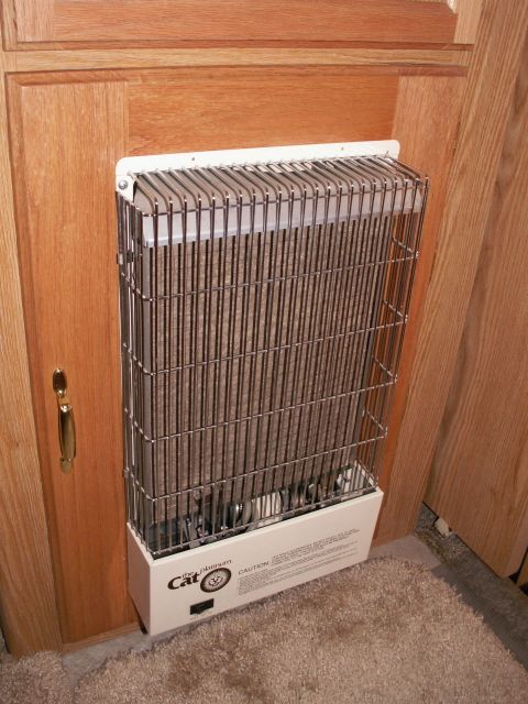

Derek up North Posted November 23, 2011 Share Posted November 23, 2011 There isn't a real good place to mount the Wave 3 - but I just got a couple more Ideas that I'll look at this weekend. (mounting it on a cabinet door) Like this? http://www.modmyrv.c...atalytic-heater Another installation:- http://motorhomemodification-usa.blogspot.com/2011/01/olympian-wave-3-attached-to-cabinet_1971.html Quote Link to comment Share on other sites More sharing options...
waiter Posted November 23, 2011 Share Posted November 23, 2011 Derek - EXACTLY - I seen something like this last night, the fellow had it mounted on the inside of the door, so when the door was closed, it was out of the way, BUT, this would also work. I'll look at mine in the next couple days to see if its workable. BY THE WAY - WHERE HAVE YOU BEEN HIDING??????? JOhn Mc 88 Dolphin 4 Auto Quote Link to comment Share on other sites More sharing options...

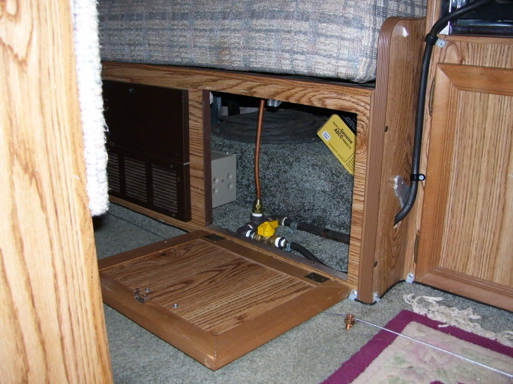

waiter Posted November 24, 2011 Share Posted November 24, 2011 Good to see you. I got the low pressure already plumbed under the stove, put in a "T" and also a valve to shut it off. Waiting for the hose to come in the mail. John Mc 88 Dolphin 4 Auto Quote Link to comment Share on other sites More sharing options...

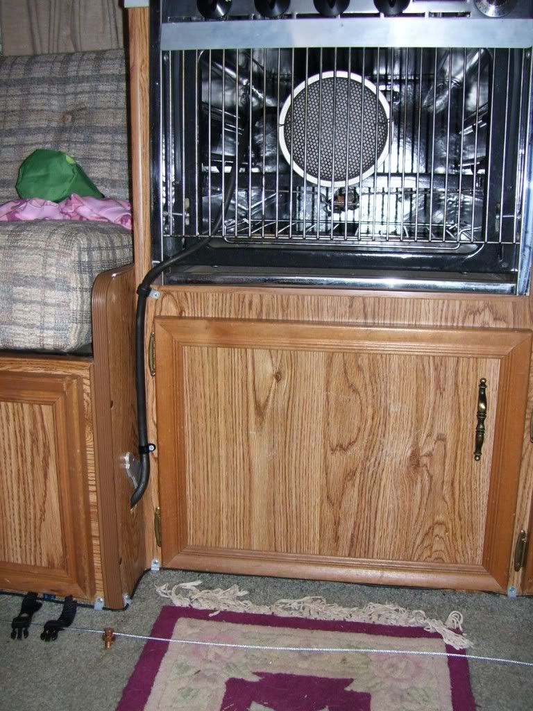

waiter Posted November 25, 2011 Share Posted November 25, 2011 As a test, I ran the Mr Buddy yesterday in the Toyhouse. The outside Air Temperature (OAT) was 35 Deg F, and the wind was blowing out of the west at about 30mph. I don't have the low pressure hose plumbed yet so I used a 1lb canister (lasted about 8 hours) and ran the unit on low (3000 btu). I opened up my two aft roof vents about 1/2 inch (The two back vents have MaxAirr cover on them) and opened the drivers door wing vent window about an inch. In spite of the strong winds, the heater was able to keep the interior at about 60 deg. I did have some condensation on the truck windows (windshield and truck doors) but very little on the coach windows. I suspect that 3000 btu will be to much heat if the wind isn't blowing, but this could be controlled by turning the heater off, or opening the window a little more. I like being able to move the heater around, i.e. on the floor in front of the stove, of back in the bath doorway in case your cooking, on top of the stove or sink, or even open the oven door and put it on the oven door. The Mr Buddy can be moved around (even if its plumbed with a hose), but I'm still holding out hope that I can mount the Wave 3 somewhere. I prefer the Catylic heater over the Mr Buddy. The Wave 3 doesn't have a good stand. It has the two big legs that are an option, but these are to big and require a large flat surface to rest on. I could probably make a stand out of wood or metal. it also doesn't have a carry handle to lift or move it while its running, again, I could probably make one. Stay tuned while I think about this some more. John Mc 88 Dolphin 4 Auto Quote Link to comment Share on other sites More sharing options...

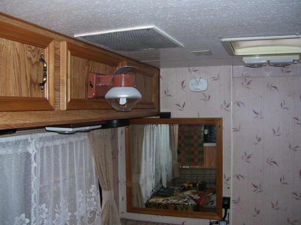

waiter Posted November 28, 2011 Share Posted November 28, 2011 Testing continues. I purchased a Carbon Monoxide (CO) detector from Menards for $20 - This is battery operated and has a readout (updates every couple minutes). I mounted it up near the ceiling to the left of the bath door. The Quick Disconnect (QD) hose I ordered came in (QD10C). The hose is 10 ft long, 1/4in male pipe thread on end and the QD female on the other. The short hose has the QD male on one end and a 3/8 female flare on the other - This hose connects to the heater. LP Quick Disconnect I now have the Toyhouse plumbed with this hose (low pressure line). I installed a "T" in the LP line where it comes up through the floor under the stove. I added a shutoff valve and the hose connects to the valve. I drilled a couple 1 1/2 inch holes in the bottom of the cabinet door. I can run the hose through either one of these holes and can then close the cabinet door. This allows me to put the heater on the floor, or on top of the stove counter. WAVE 3 After spending days looking for a good place to mount the heater, I came to the conclusion that I just don't have enough room anywhere to mount the heater, and be able to operate it safely, and in a manner that I want to use it. With the long hose, I can locate the heater at different places. I can set it on the floor near the bath door and it has good heating of the floor, Only thing is, I'll need to step over it to use the bath. The other location is on top of the stove or the sink. Regardless of location, I still need to open the roof vents and a window a little to allow fresh air. When I was lighting the Wave 3, I watched the CO alarm, it went up to 50 ppm when I was lighting the Wave 3, but after it was lit and running in the HIGH position, the CO reading went to ZERO. ( I think the Pilot light puts out a lot of CO) Also need to be aware of anything that could fall on top of the heater, so look around if its sitting on the floor. **************** I connected the hose to the Wave 3 and tried it. IMPORTANT - Lighting the Wave 3 is different than lighting most other appliance, so after y20 minutes of screwing around and it not staying lite, read the instructions. Put the knob in the START position, Press and hold the knob down to override the safety thermocouple until it lights. Click the starter, the pilot should light. Continue to hold it down for 30 seconds, you'll see the bottom of the pad start to glow and you'll fell the heat. Now, release the knob, (note - The pilot light will go out - this is normal), quickly, press the knob down slightly and turn it to HIGH. Initially, I thought it wasn't getting enough gas as the pad was not completely glowing. I replaced the quick disconnect hose with a short piece of 3/8 hose. I didn't see any difference in the heater, so I'm guessing that the quick disconnect and hose isn't impeding gas flow to the heater. This week I'll make a small Manometer and check the gas pressure to make sure its 11inches. The quick disconnect makes it convenient to unplug and store the heater when not in use. Mr Buddy (small - 3000/9000 btu) I had seen reports that someone was able to use the Mr Buddy on low pressure, without making any modifications to it. I hooked up the disposable bottle adapter to the low pressure hose and screwed it into the Mr Buddy. I was able to get the Mr Buddy pilot light to light, and noticed that the pilot flame wasn't very long. When I moved the valve to the LOW position, the Mr Buddy puffed once and blow the pilot light out. In my Installation, the Mr Buddy will not work this way. I'll check my LP regulator to make sure its putting out 11 inches. I'll write this up again when I do that. MODIFY Mr Buddy.!!! In my research, I had read several instances that the Mr Buddy would work if its internal regulator was removed and the MHs low pressure line was attached directly to the Mr Buddy low pressure. (The larger Mr Buddy has this connection built in, but the small Mr buddy doesn't) I would rather not remove the internal regulator, because I like the functionality of being able to use the 1 lb disposable tanks (These would be good in an emergency). I took the Mr Buddy apart last night and I believe I can install a "T" in its low pressure line, with one side of the "T" coming out the back of the unit. When I want to connect it directly to a low pressure source (i.e. my Toyhouse), I'd screw an empty tank onto the disposable connector to plug the regulator, then connect my MH low pressure to this "T", and run the Mr Buddy directly off the MH low pressure. If I want to use a 1lb tank, I would screw on a cap on the external "T" connection. I'll re-post after I do this modification to my Mr Buddy. Conclusions to date: At this point, I'll use the Wave 3 as the alternate heat source. The only thing I need to do is to add a couple handles to the Wave 3 to make it easier to pick up and move while its hot. I think I can buy a couple of cabinet door handles and screw them to the sides of the Wave 3. (Top gets to hot). John Mc 88 Dolphin 4 Auto Quote Link to comment Share on other sites More sharing options...
acudoc Posted November 28, 2011 Share Posted November 28, 2011 I have used the Wave 3 and I love it. It never really glows evenly over all the pad. Just the nature of the product. I took mine out of my old toy and plan on putting it under the stove. I dont have an oven, so I can put it there easily. If you plan on moving it about you might consider a swivel connection. I have the old model so I can use it at elevation. Henry Quote Link to comment Share on other sites More sharing options...
waiter Posted November 28, 2011 Share Posted November 28, 2011 I have used the Wave 3 and I love it. It never really glows evenly over all the pad.Just the nature of the product. Henry; Thanks for the info. Real Estate in a Toyhouse is valuable. I have an oven, but I'm thinking of taking the door off and see if the microwave will fit in there. That would free up the top of the frig. I bought a 90deg swivel today and will install it on the Wave 3. Also got the parts to modify the Mr Buddy. John Mc Quote Link to comment Share on other sites More sharing options...
