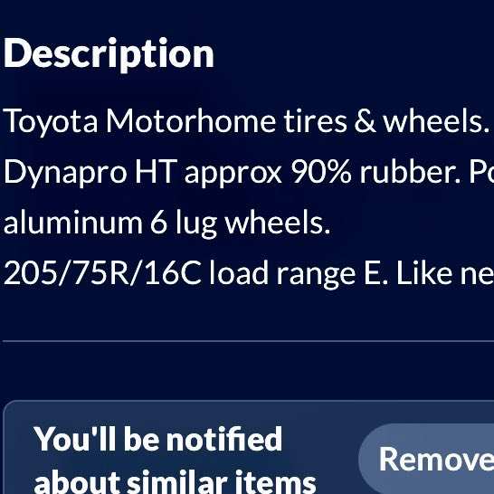

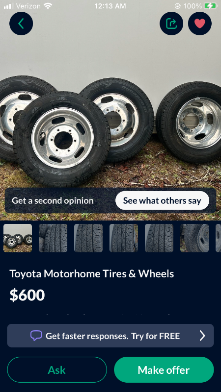

Robertseattle Posted November 10, 2025 Posted November 10, 2025 Hello all! Ā New member here. Ā I recently bought a 1992 seabreeze with the DRW and 6 lug axles. Ā I was thinking about getting backup rims and seen these for sale and wondered if they would fit. Ā Seems they are bigger than the 185r14 which is on the MH. Ā Any help would be appreciated. Ā š¤š» Quote
MaineJed Posted November 10, 2025 Posted November 10, 2025 Iād wait for a factory set of 14ās to show upĀ Quote
Robertseattle Posted November 10, 2025 Author Posted November 10, 2025 Ok Ā Ā Glad I asked Ā Ā Thanks Ā The guy selling them says these are oem rims. Ā Ā Seems that the oems were 14 inches? Ā I guess somehow there are after market rims that are bigger? Ā I guess I could get a spare from a Ā salvage yard or keep looking like I did. Quote
WME Posted November 10, 2025 Posted November 10, 2025 It looks like there are only 4 tires and rims, so you would have to carry 2 spares or spend a ton of $$ to buy 2 more for the front. Also they would change the overall gear ratio about 10% in the wrong direction Quote
Robertseattle Posted November 10, 2025 Author Posted November 10, 2025 Ok Ā I will try to get a spare 14ā Ā Thanks WME for your help!!!! Quote
