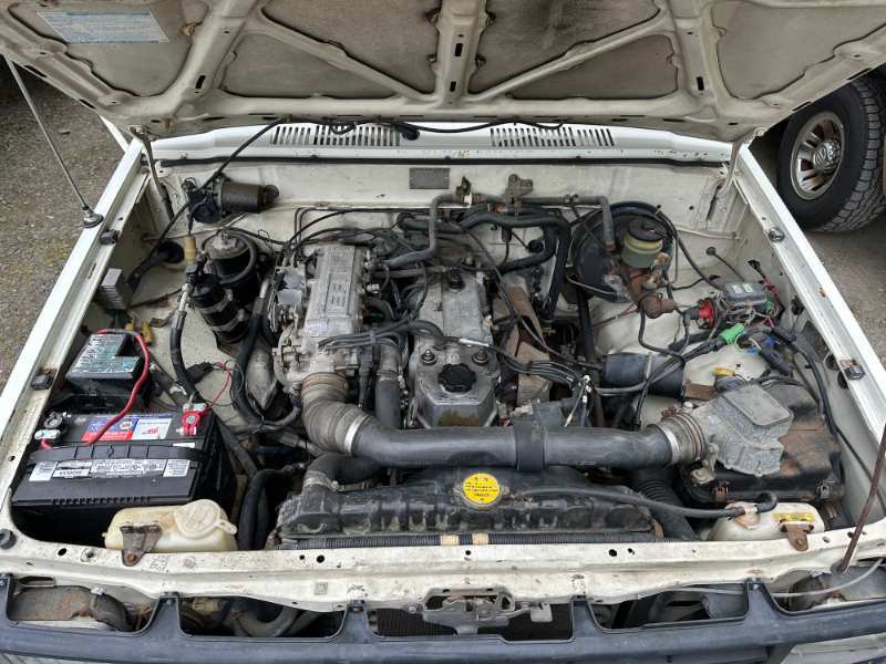

Hoping I can get in on this discussion since it was a post I was going to create anyway. I am about to have my Timing Chain and Guides replaced. While we are in there the mechanic will do the oil pump, water pump, new timing cover, valve cover gasket and tune up(cap, rotor, plugs and wires). He has asked me if I want to put in a new radiator. I understand since he will be already in there. My SunRader runs fine has plenty of power & good gas mileage. I am having him do this because I am leaking oil. Engine is a 1986 22REC with 85,000 miles on it. I have no cooling issues if anything it may run a little cool. About 1/3 instead of 1/2 on the temp gauge(factory on the original dash). I do not loose any coolant and it is clean. Looks like you just filled it with new coolant. Has anyone had a radiator fail? Any suggestions on brand or brass/copper vs aluminum? I appreciate any help in advance.
if your cooling system has been properly maintained there is no reason to replace your radiator. regular flushing and coolant replacement will keep the system up to spec indefinitely
make sure to get the valves adjusted
That's what I thought. I will replace all the hoses while we are in there. I think a valve adjustment is a definite add to the list. Any other advice is appreciated. Thanks.
clean the throttle plate and adjust the throttle position sensor
