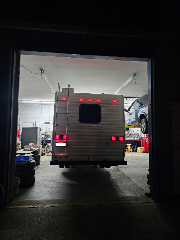

Hello everyone! My name is Chris... and I have a 1984 Toyota Rader with a 22r... right around 100k miles and in mostly clean original condition. Recently, I moved into an apartment where I am only allowed one car - since I owned both an Outback and this Toyota rig... the Outback had to go. That makes this my daily driver... which is ok by me... except right now my tail lights are going haywire and I can't figure them out. I have pulled every single bulb one by one... I have inserted each bulb one by one... I have disconnected the lights in the front. I saw some wear on the wiring harness going to front headlights and changed those out. Still... can't shake this ghost. Please see attached GIF below for exactly what is going on.
When I hit the brakes the rear end lights up funny. If I leave the marker lights in (they are removed in the video) they also light up randomly like a christmas tree. I have tried all new bulbs TWICE like an idiot... I have removed the housing from both the left and right side rear lights - and all the connections seem properly daisy chained together with no obvious errors. I am at a loss on how to find this ghost and fix it. Any ideas would be greatly appreciated! Thank you in advance! - Chris
Edit - a couple of other minor notes. The lights on the back left look more dim that the lights on the back right. Reverse lights do not seem to be functioning at all right now. Using left turn signal clicks more slowly than the right turn does at the dash. I have replaced the relay that controls that to no avail. Front end lights work fine. If the headlights are turned off... the rear lights work as they should... when the front headlights are on... they go haywire like you see in the GIF. Could it be switch on steering column? Anyway... thank you for your consideration of my issue.

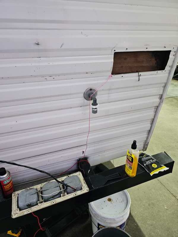

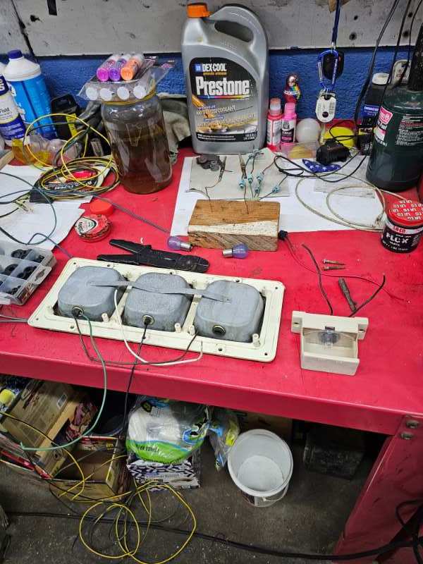

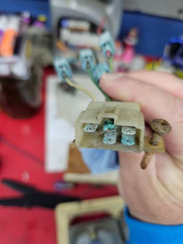

Hello everyone, I wanted to stop back by to this thread and let folks know it was indeed bad wiring in the rear. Sort of a "No crap bad wiring" moment - but a friend and I dug into it and basically rewired, soldered, taped, zip tie all new wires. I elected to keep the old style tail lights even though upgrading to LED might have made sense...  my rig is 99% original from factory and I'm going to try to keep it that way. Part of the reason why I didn't upgrade the interior - to keep a time capsule intact. There was one connector in particular which was corroded... also one bulb socket had managed to spin around inside the housing which caused a short there. A couple issues were found - all back to normal now. Thanks for the help everyone who commented. I am grateful for the guidance.
