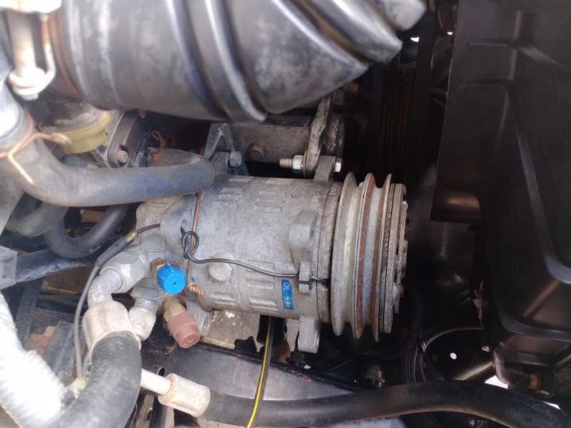

I have the pictured A/C compressor. If it is a Sanden, I think it's a SD510HD model. Can someone correct me if I'm wrong and suggest a source for replacement in a R134a model. The one pictured is a converted R12. One of the mounting points broke and Im looking to upgrade, if possible. Thx, DougIMG_20250906_151644.jpg.cf0573105bac0b49c23975745ef7abc6.jpgIMG_20250906_151644.jpg.cf0573105bac0b49c23975745ef7abc6.jpg

don't think theres a difference in compressors for 134 and r12. just the charge ports and oil type
Correct, only that the r134 will require PAG oil.
Denso makes a new replacement compressor but it comes pre-oiled with the wrong oil. You just need to buy an extra can of PAG oil and do a good flush before installing it.
